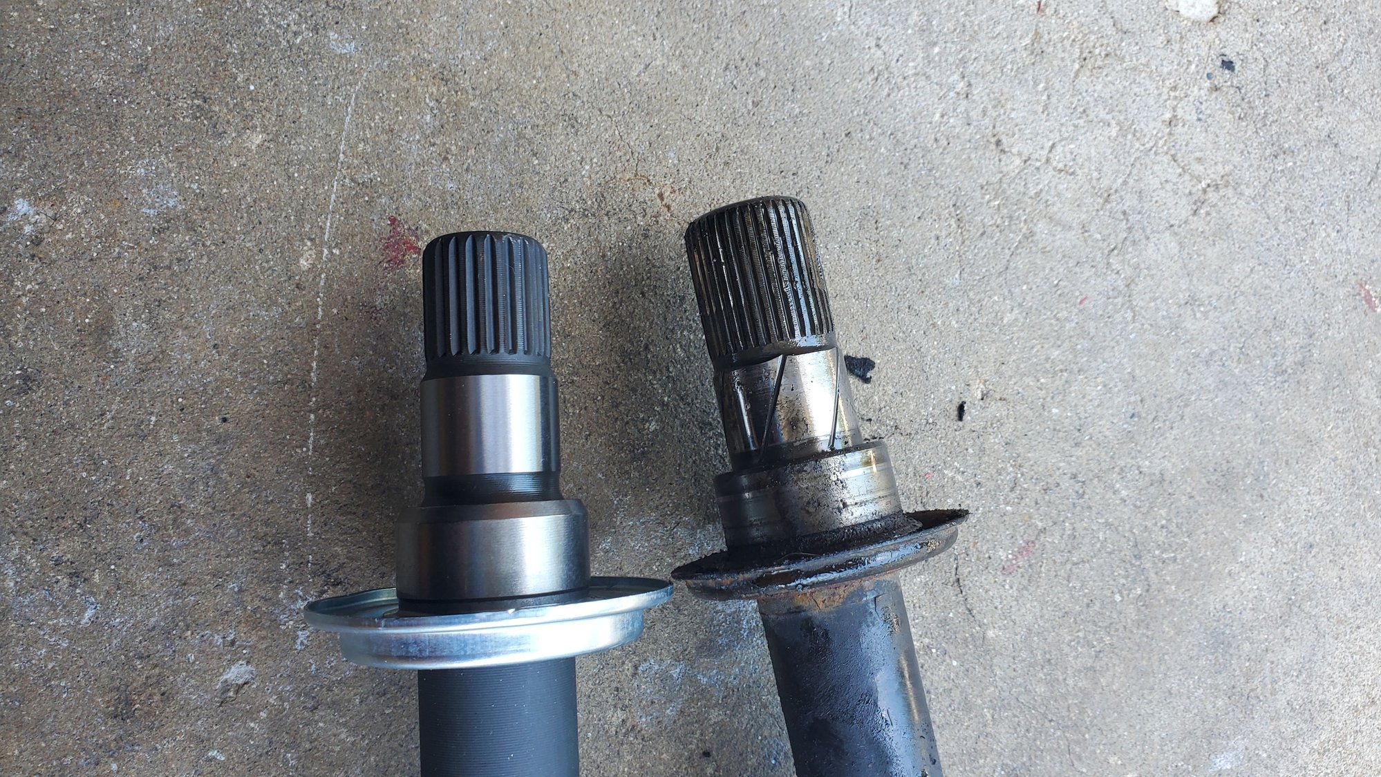

WHOAAAAAA !!!! Rite as I was finishing cleaning up getting ready for a test drive I took the other 2x parts of axle left over and idk why but I just tried piecing them together and omg the bearing ARE larger on my old axle so therefor it had a larger input shaft housing FOR those bearings. They were literally like 2mm bigger IF THAT but nonetheless bigger and it did not go together. Soooooo if tgat was too large to fit that meant the new axle I put into my old input shaft will have too much clearance around the bearings and it would probably self destruct in NO TIME.. SOOOOOOOO I just removed the new half of the axle, put it back together, boxed it up and will be shipping it back.
very frustrating getting incorrectly labeled parts and NOT reading theyre wrong until install comes.. and of course I can't compare them until I have the old one out most of the time..lol o well. If not fir bad luck I'd have no luck..
