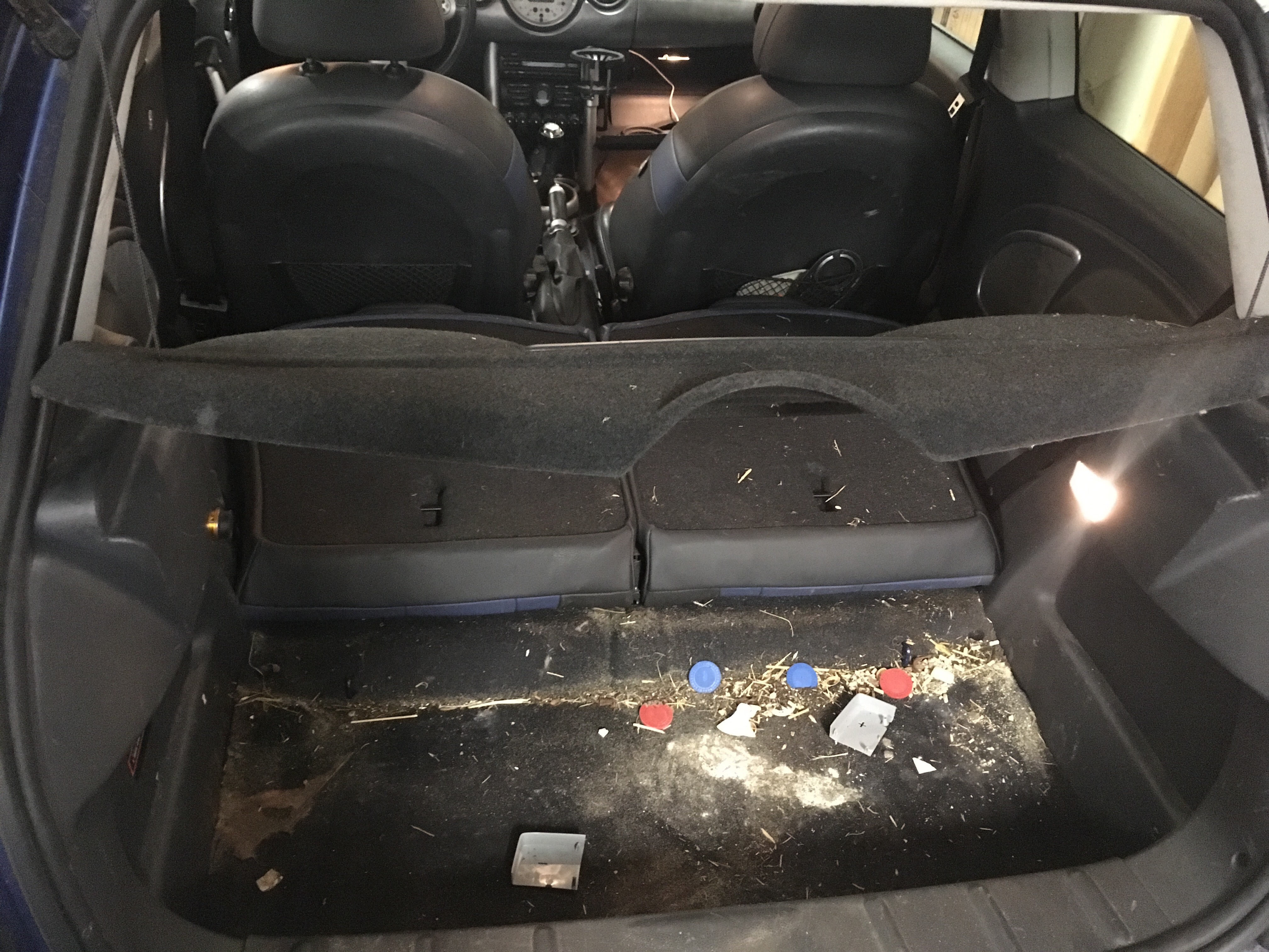

I made some good progress over the past two nights. All of the lower interior is removed, this car was truly filthy!! Carpet is gone and with it hopefully a lot of the smell.
Next I'll work on cleaning up the dash, controls and front seats so it's drive-able, then start work on the mechanical parts.

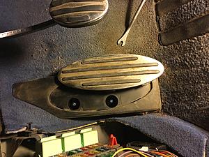

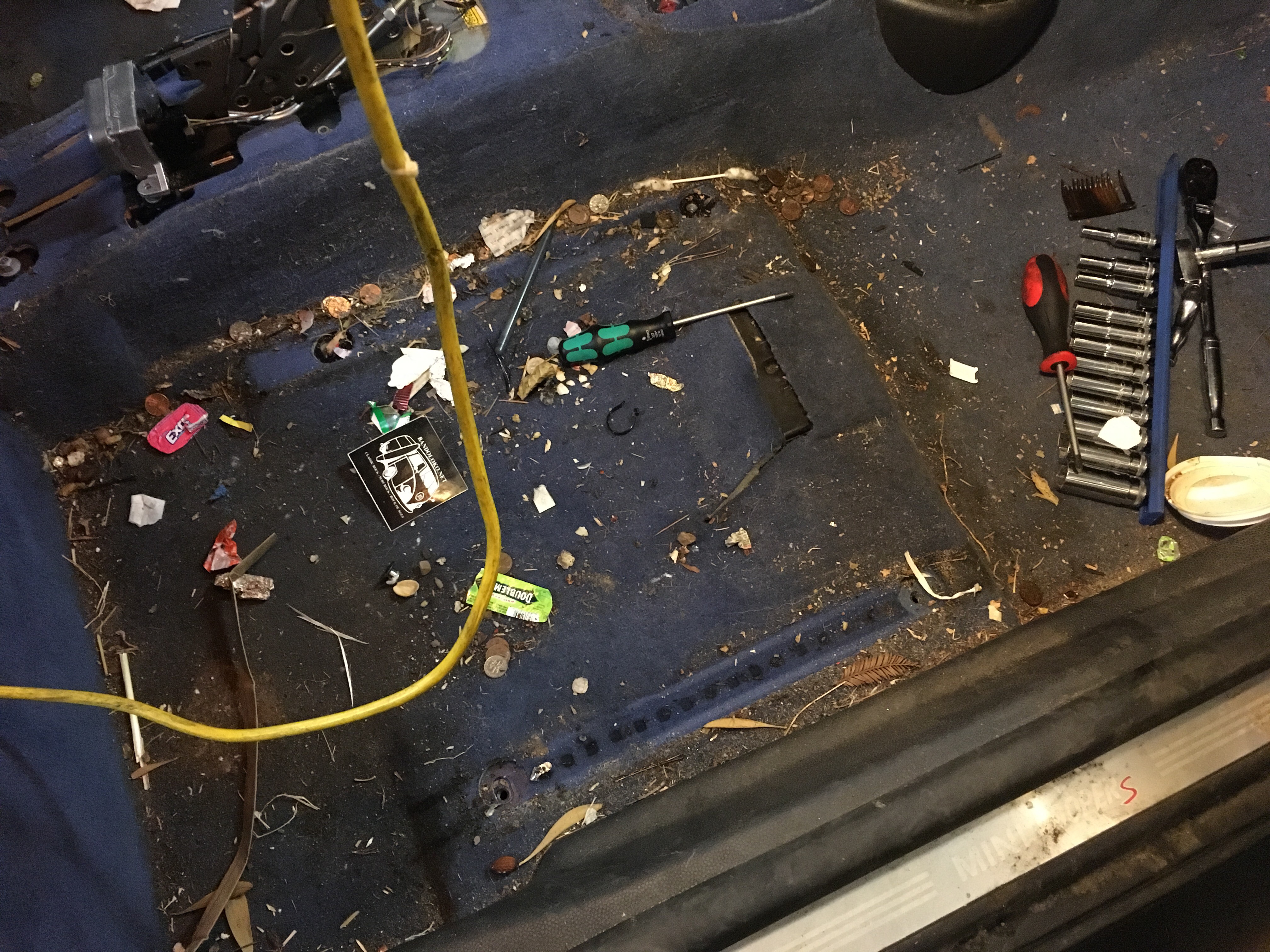

Small update; All of the interior except dash and door cards is out. Side airbags, sensors and controller are removed too. I'll be keeping the interior in this state until the cage goes in and focusing on the engine and drive-train work now.
There were a few tricky parts I found when removing the interior. If you're doing this as well, here's what I ran into;
Dead pedal: The metal/pad cover comes off with some force and exposes 2x 10mm nuts.

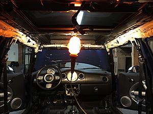

My headliner was also full of leaves, so prepare for that with safety glasses and cover up the shift assembly so you don't get dirt and leaves in the lubed shift joint.
After getting the headliner out it's very clear to me how much of the roof the sunroof takes up. I need to remove the glass and block up the hole to meet the rule requirements, plus that whole assembly weighs 25 Kg. I'll be considering my options there while I push that problem out until before the cage goes in. The cleanest option so far seems to be a junkyard slicktop swap. The hardest solution would be to make a plug out of carbon/honeycomb composite material because #racecar, but that will easily cost more than the car.

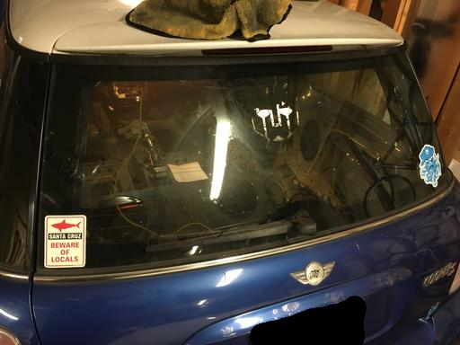

- Removed some of the crusty stickers from the rear window
(Before)
(After)
