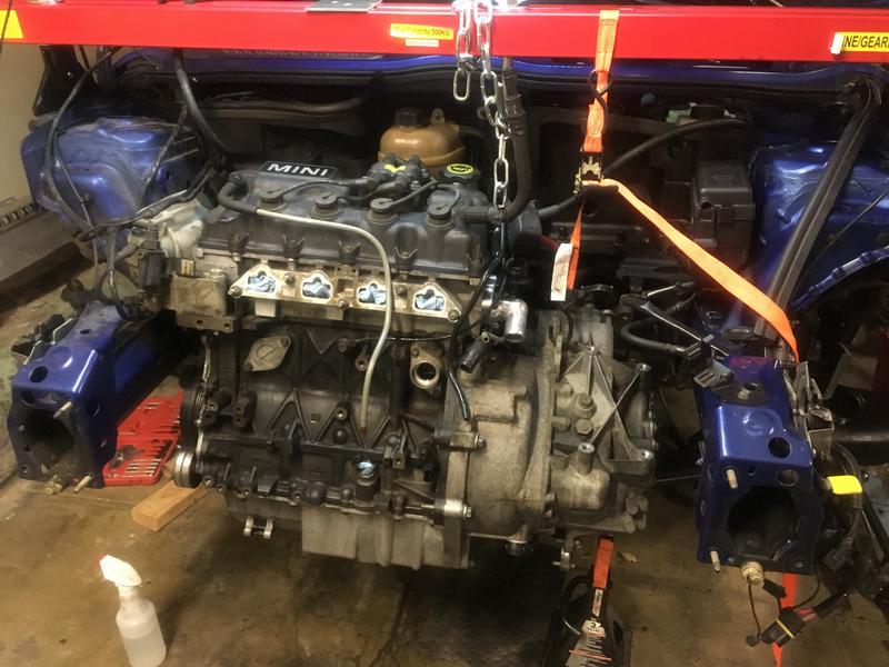

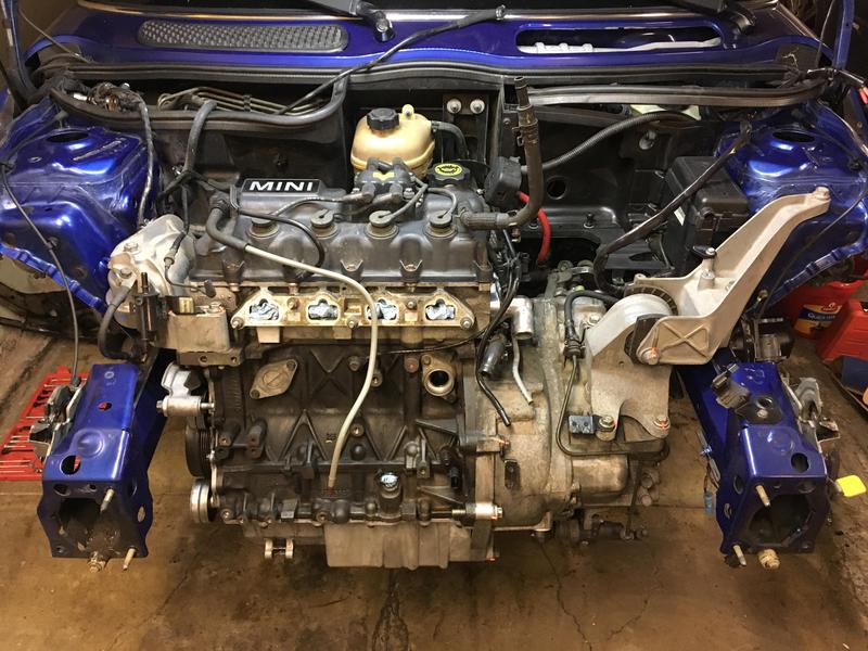

Slowly removing parts from the engine bay while waiting for all the new parts to arrive.
The coolant came out clear and blue which is a good sign, it looks like the cooling system is in good shape without any corrosion/scum/rust in it.
The front came off last night:
Looks like the crank position sensor might have a small leak, maybe the oil dipstick tube too:

A bit of an update in my game of "What else is leaking oil?"

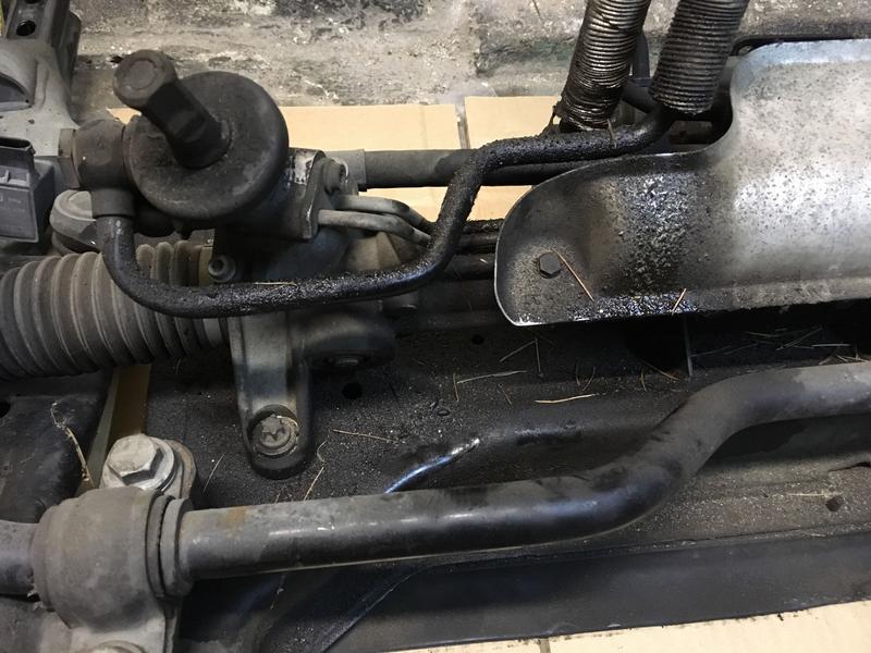

One of the axle boots was torn and spraying grease all over the oil cooler and subframe, but it's a tiny hole and the CV still seems ok.

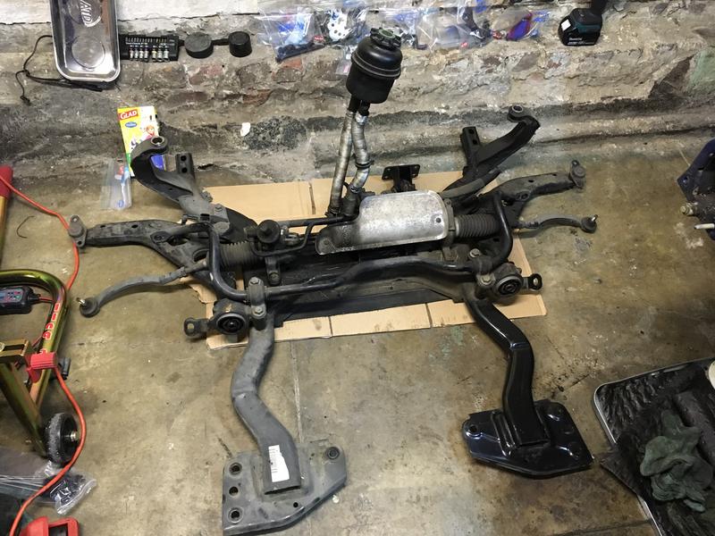

Front subframe is out. Dropping it was easy enough once I worked out that the steering u-joint swiveled up. It needs a good clean-up but all the bushings and ball-joints look good. The control arms and sway bar are getting poly bushings.
I found a second-hand power steering pump and steering rack locally for $50, I'll convert one rack to manual by filling it with grease but keep the power steering for now, with the new pump and hoses.

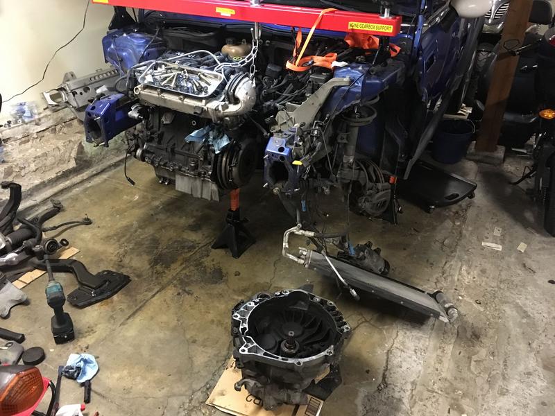

Dropped the transmission in search for more leaks, found one or two

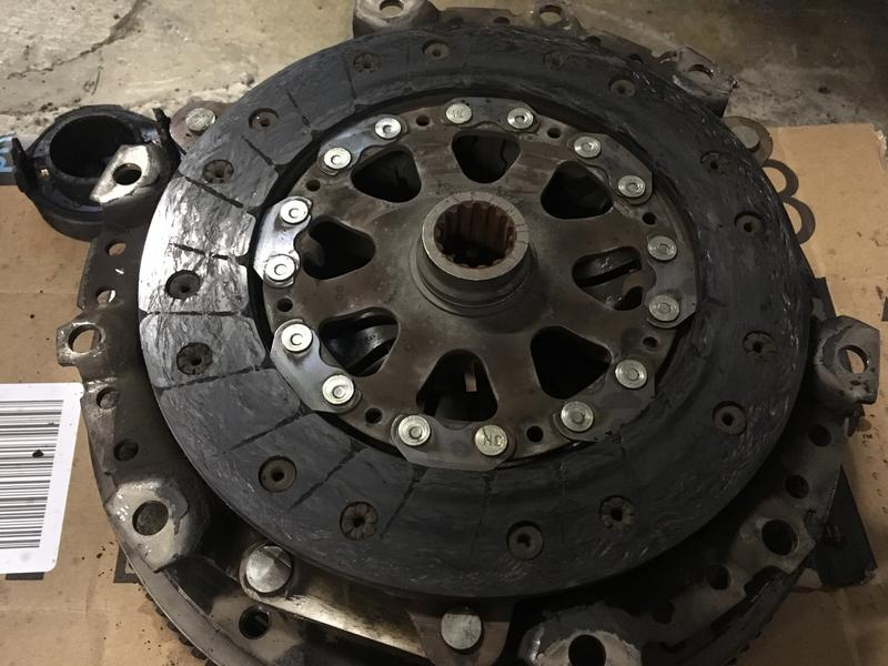

To my surprise the clutch is toast. The paperwork says it's only 30k miles old, so must have been slipping with all the oil in the bell housing. I found a great deal on an unused and unwanted valeo single mass conversion kit, so that will be going back in to replace the stock clutch.

The first time I dropped the subframe the steering U-joint was my biggest issue too. I had to walk away and come back before I figured it out. Not one of my best moments, but it took many HARD whacks with a 3lb sledge to get it loose.
I'm about to start my 3rd subframe drop in ~5 months in the coming weeks. As soon as I get my Z off the lift. Shooting for a new record time haha.

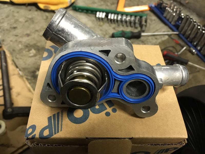

New thermostat housing before installation. The OEM one looked fine and was only 30k miles old, but this metal one was only $14 and now I have the plastic OEM one as spare.

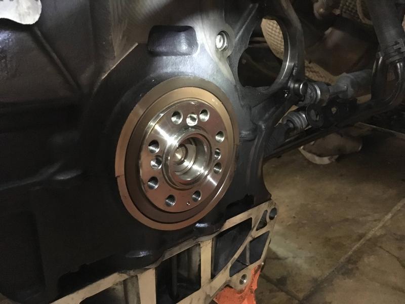

New rear main seal is in, this should hopefully take care of one of the major oil leaks.

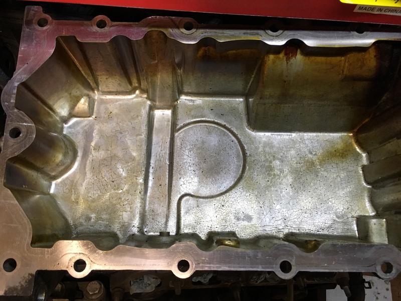

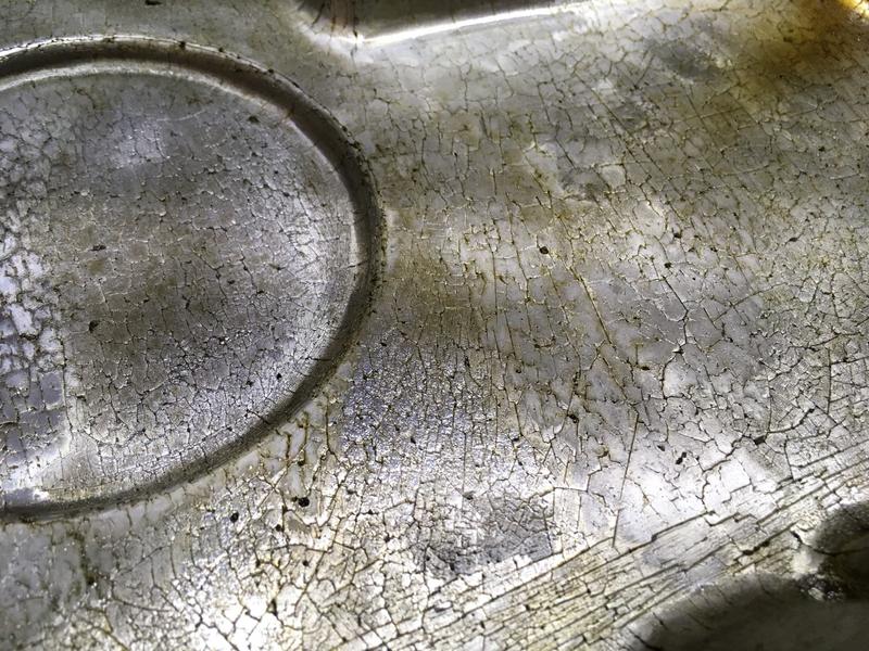

The latest curiosity was hiding in the oil pan. The interior and and exterior surface of the casting has what I can describe best as "scaling" or "crackling", which makes it a huge pain to clean (it's like cleaning coarse sand paper). I kind of doubt that a casting finish like this would pass inspection and leave the factory, so that makes me wonder if this oil pan is starting to show signs of cracking, maybe due to some original manufacturing defect. Has anyone else seen a Mini oil pan like this? It could be normal for all I know, but it does look odd. I'll clean this one up for now but I will be consider a cheap $50 aftermarket pan if this is something out of the ordinary. The last thing I want is to oil up a track.
Both my spare oil pans have small areas with the same kind of "scaling" or "crackling" so it does seem to be normal. Not sure if it is safe, although I have not heard of an oil pan failure.
Thanks for the replies! It's good to know it's not just mine. I'm thinking about making my own baffle, the off-the-shelf ones are a bit spendy for this budget build.

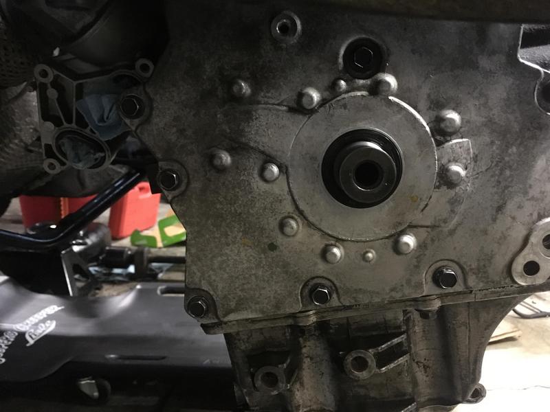

Took the crank pulley off to replace the front crankshaft seal and the timing cover gasket. Pulling the crank pulley was a fun game. I was lucky to have enough punches/rods/bolts to make it work but having some correct length HSS rods would make the job a lot easier next time.

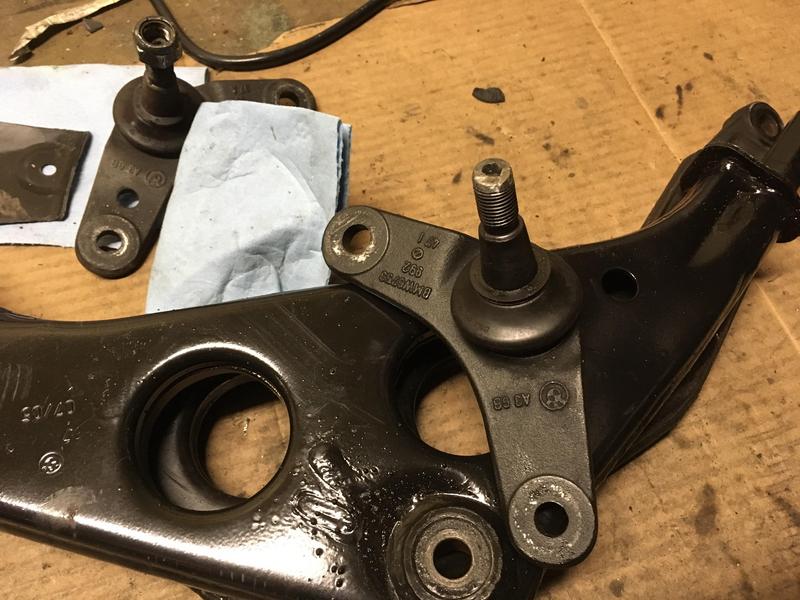

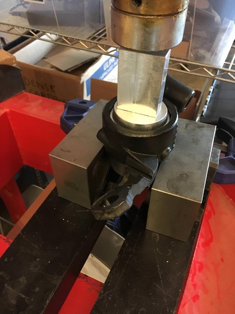

Getting the front lower control arm inner ball joints out was not easy! Using the BFH failed pretty quickly, then the ball joint removal tool started bending itself and the threaded ends of the ball joint, even after soaking everything in penetrating oil and applying liberal heat. I decided to go for overkill and put them in the hydraulic press at work. After about 6-7 tons of pressure they finally popped out with a nice loud bang.
Starting with the press could have saved a few hours of manual work, there's nothing quite like the right (over-sized) tool for the job.

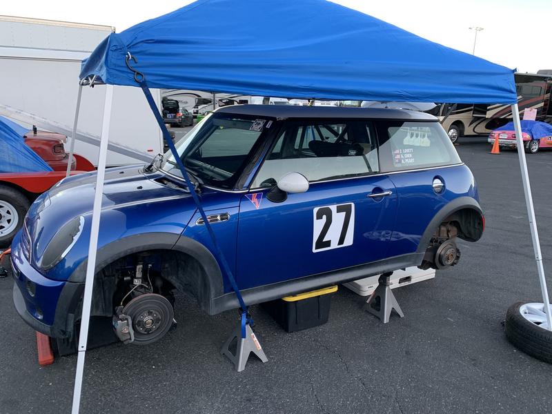

It went pretty well for it's first race! Here's the 6hr video from Sunday below. What car were you in DrZ?
Saturday morning we passed tech with flying colours (my first goal for the weekend) and after about 20 minutes of the judges threatening to give us the difference in weight from the original mini to the R53 in penalty laps, we got placed in class A with zero laps.
About 2hr45min into the starting session on Saturday morning the car cut power on me and threw a P1688 code. I limped it in, lifted it up and went straight to the (still stock, 120k mile) crank damper. Sure enough it was shot, total separation of the pulley from the damper. Thankfully it didn't fly apart! No worries I thought, I bought a PRW fluid damper two days before the race "just in case", because I had a feeling. I forgot to being the harmonic damper puller, so had to wait 1hr for my team to go fetch one from autozone.
The real problem was when I put the new PRW damper on and it slipped right on, and spun on the crankshaft... So the spare I had was useless! So much for being prepared. That right there killed the rest of Saturday for us, otherwise we would have been back out on track by 2pm. We tracked down a generic OEM replacement in Oakland (for $340 :( and a 2hr round trip), picked it up and fitted it in about 10 minutes and were done by about 6pm that evening.
Sunday morning before the track went hot the car was still throwing the P1688 code as a "current fault", but the new damper was on tight and the car pulled hard up to redline (yay for a street legal racecar!), so I sent it out and crossed my fingers. I haven't looked if the code is still there, but it seems like it was just the DME being confused about something or learned some bad values.
Sunday was gloriously uneventful. We ended up taking the car off track ~30min before the checkered because the front rotors were very badly warped. My best guess was because my other drivers left the ACS enabled and it was working the brakes overtime in every corner, the constant pulsing of the brakes caused the rotors to overheat and warp. Nevertheless we were able to drive the car home without any new marks or scrapes, so I'm calling the race a success!
