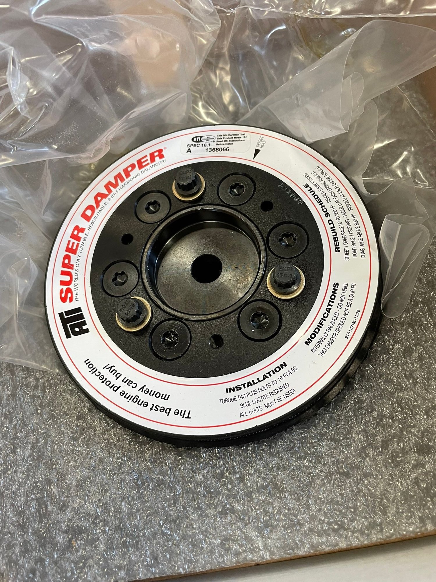

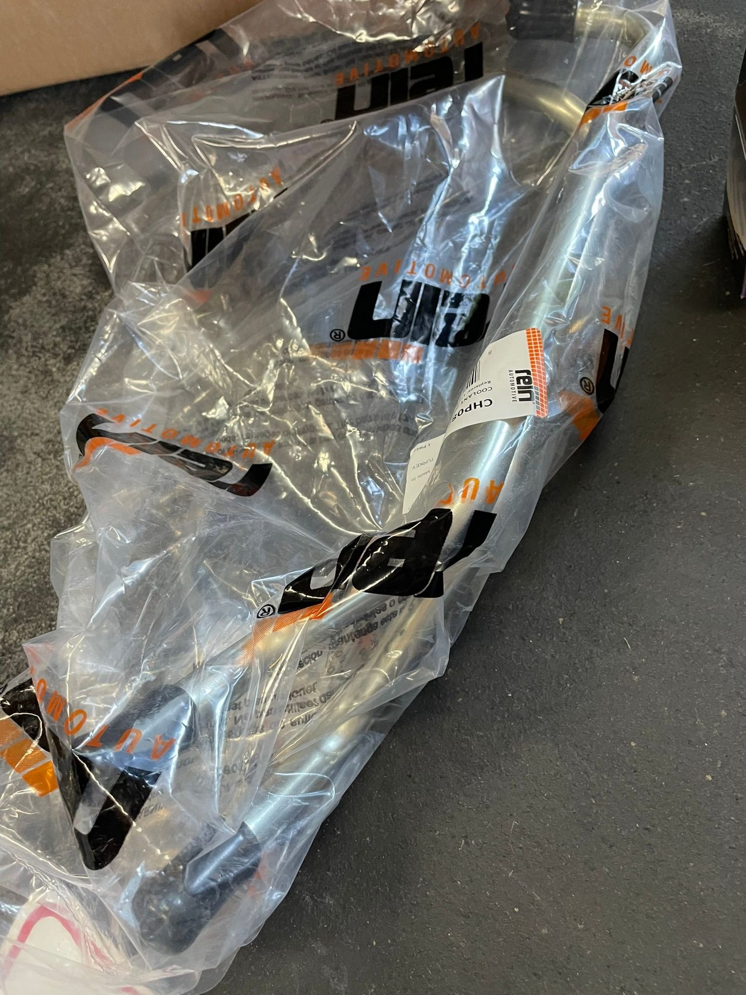

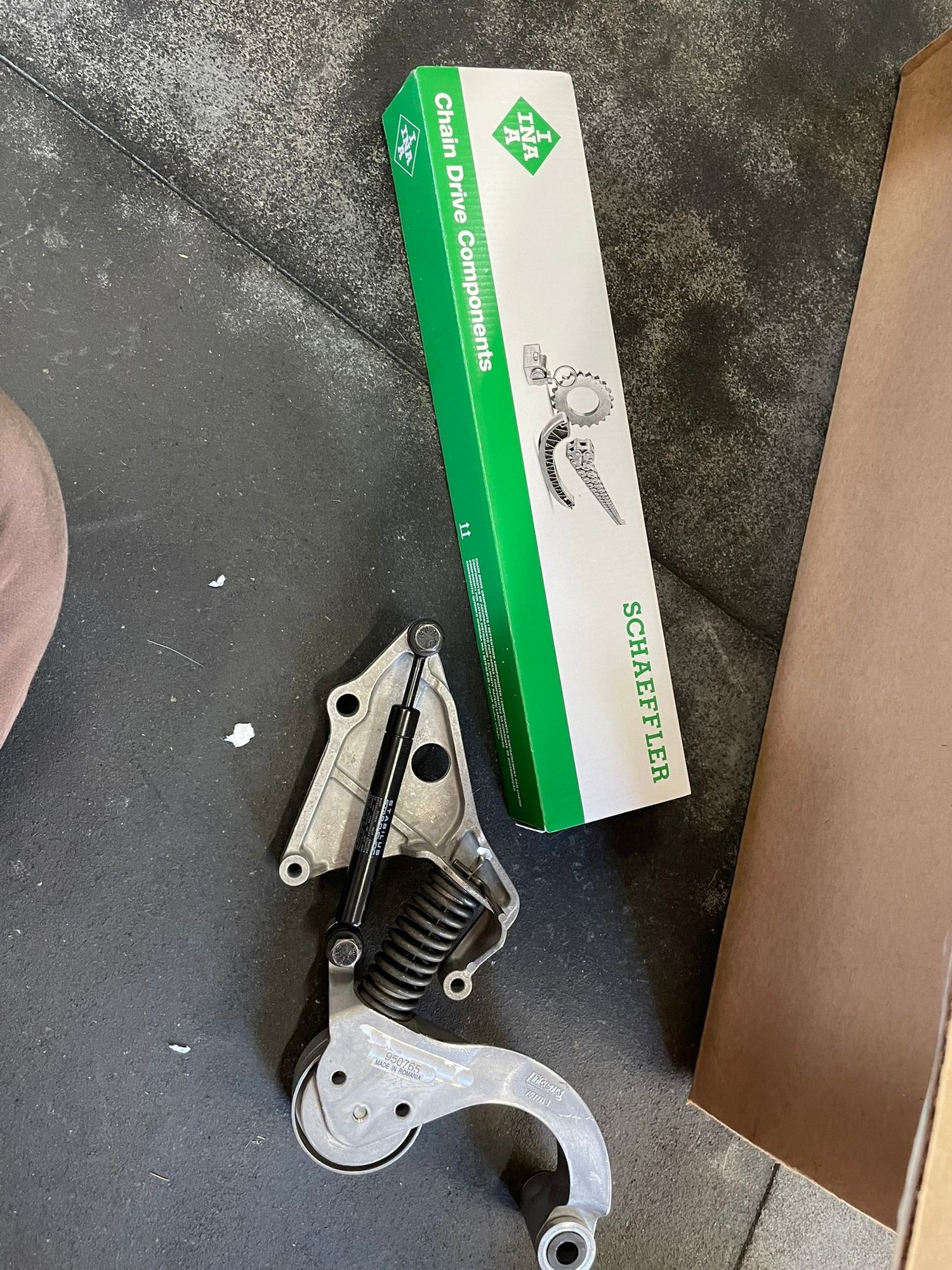

Old Oct 14, 2025 | 10:12 AM
ssoliman's Avatar
ssoliman
Joined: Feb 2018
Posts: 1,705
Likes: 317

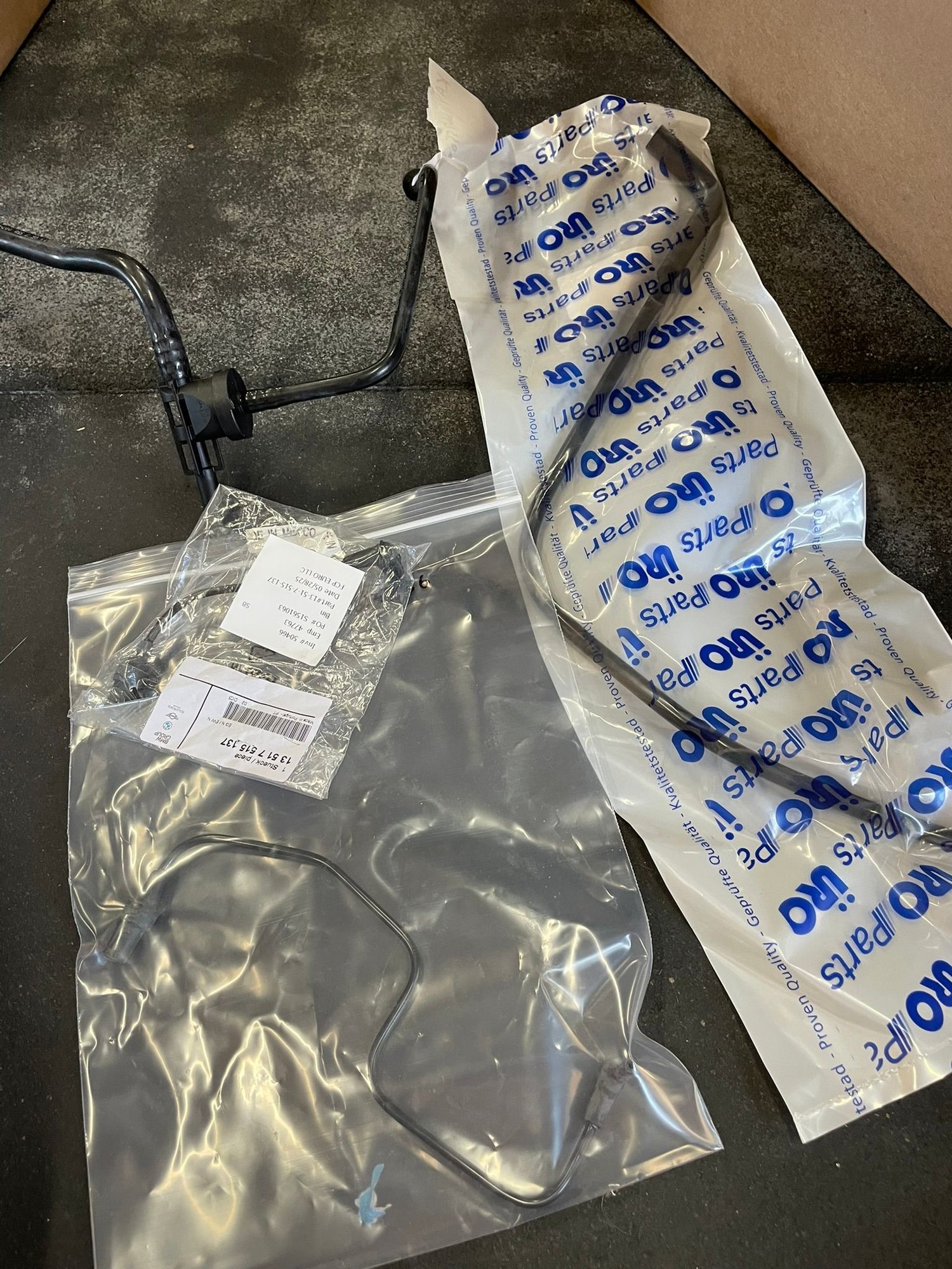

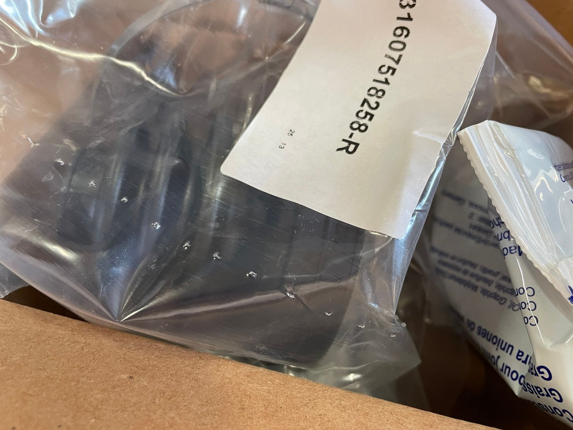

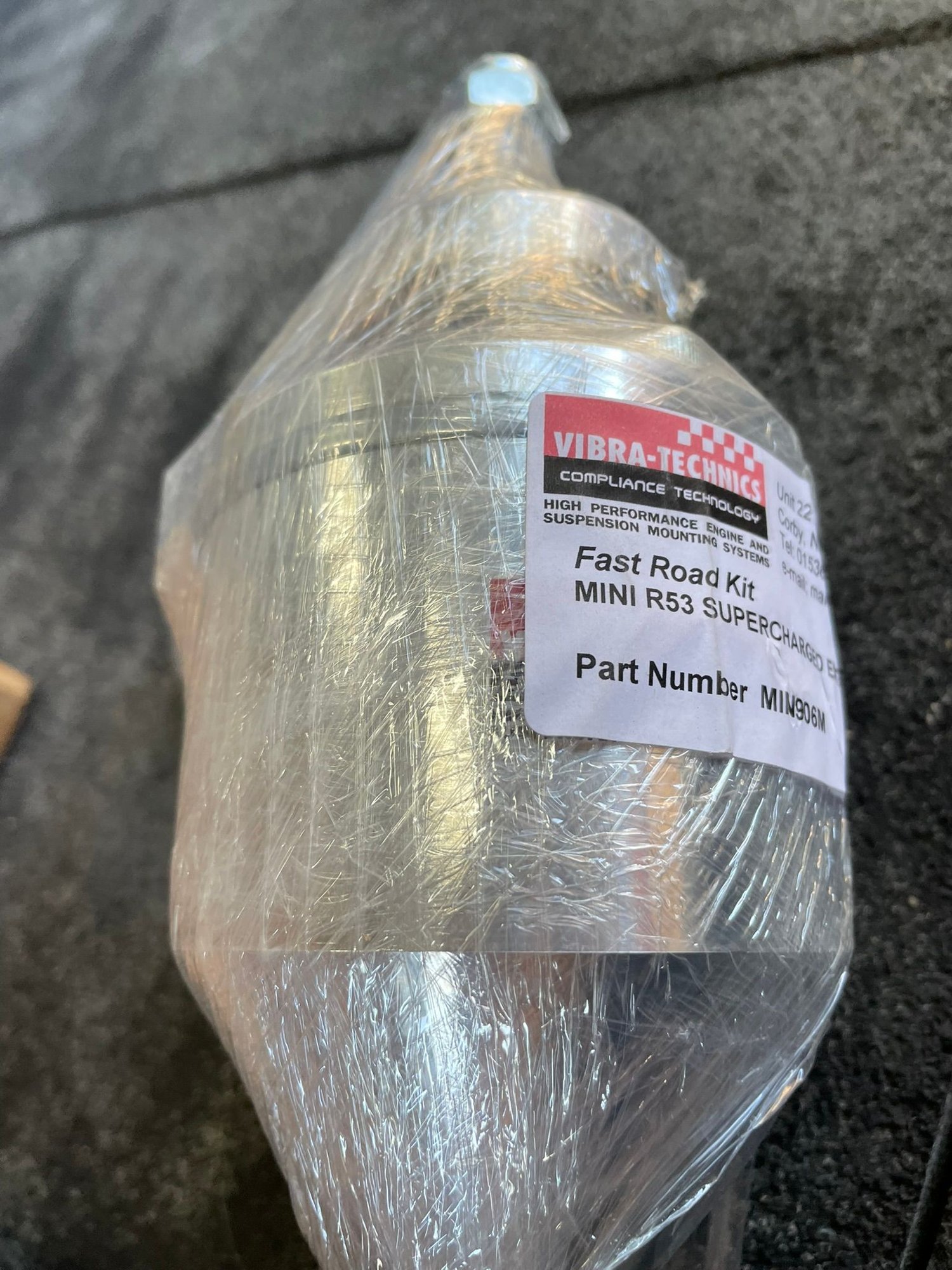

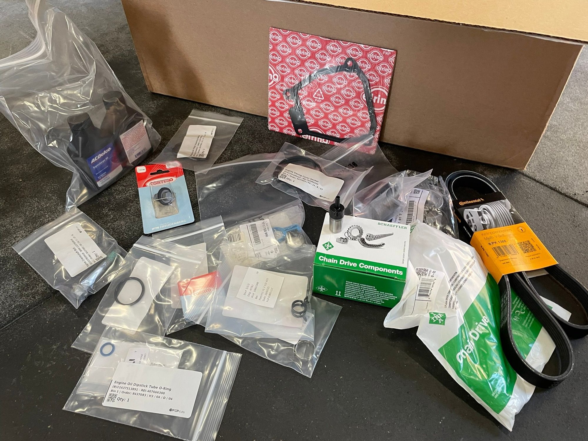

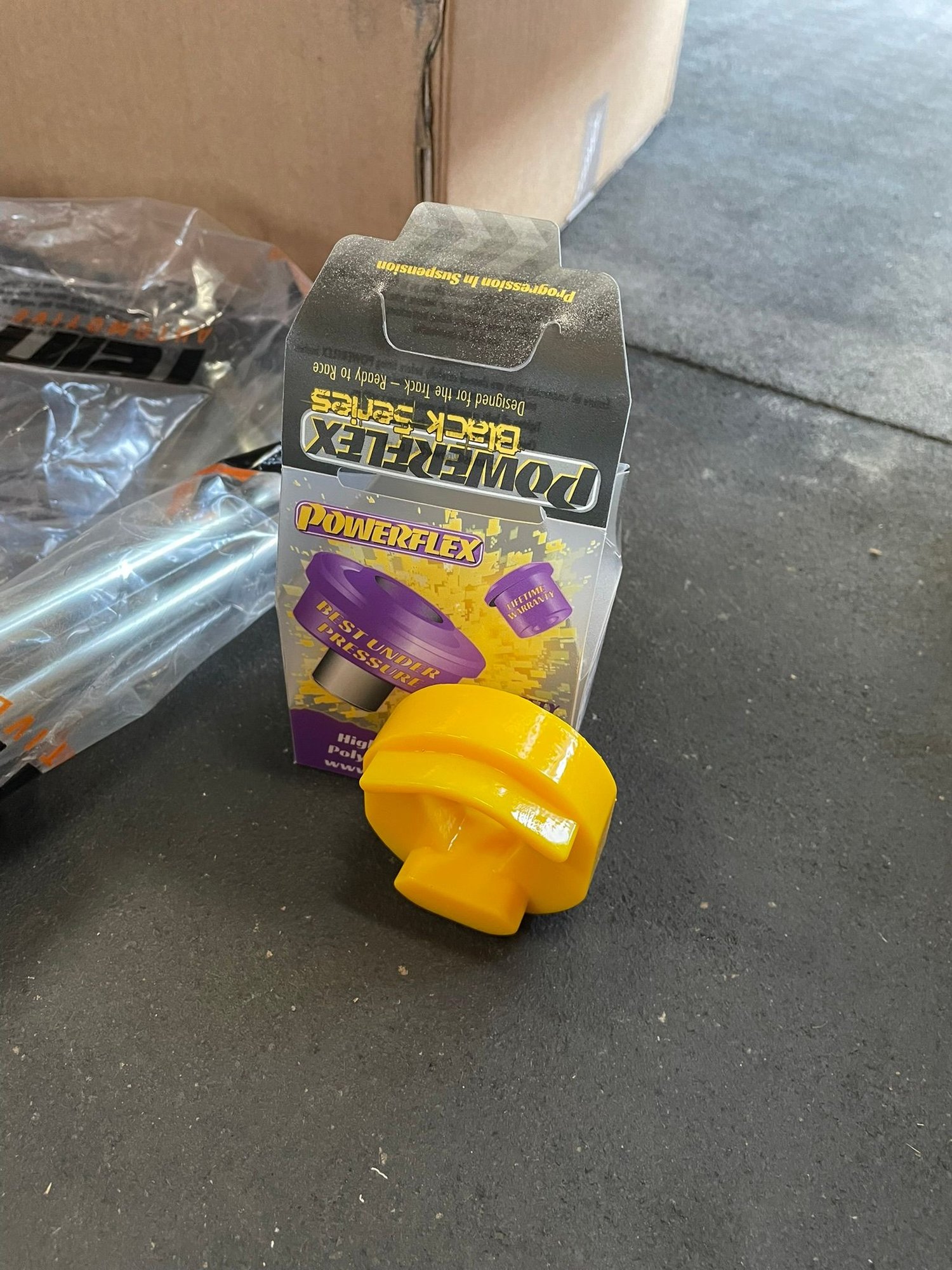

some goodies starting to arrive

Christmas came early! Good stuff, only good brands 👍

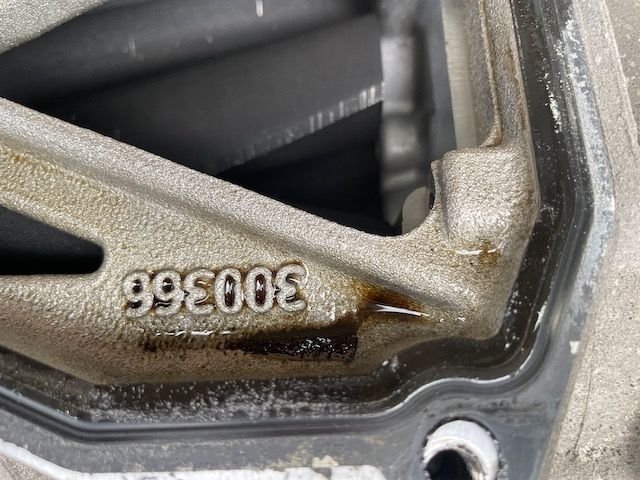

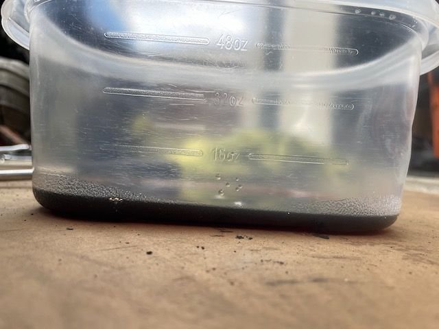

Old Oct 18, 2025 | 08:02 AM
ssoliman's Avatar
ssoliman
Joined: Feb 2018
Posts: 1,705
Likes: 317

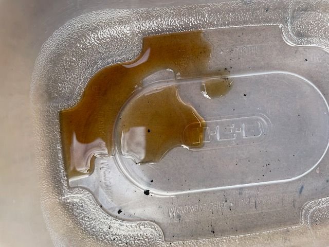

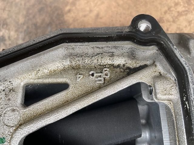

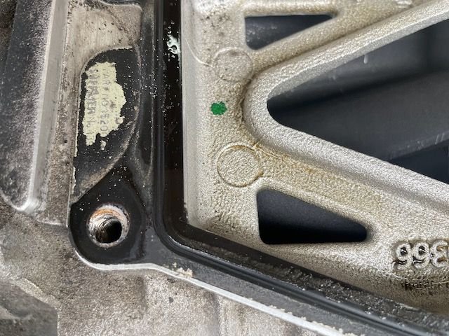

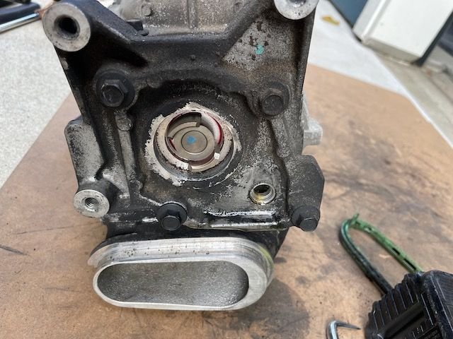

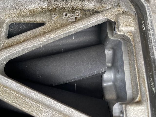

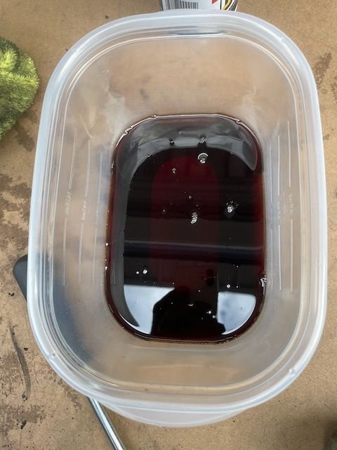

got started yesterday. the charger is out. pics below of the condition and the oil from each side;
-the water pump side had less oil but was clearer in color. pulley side was under slight pressure (heard air escape as I pulled the drain plug)
-no play in the pulley
-the only bad so far was a broken plastic connection on the line that goes to the throttle body (more on that later)

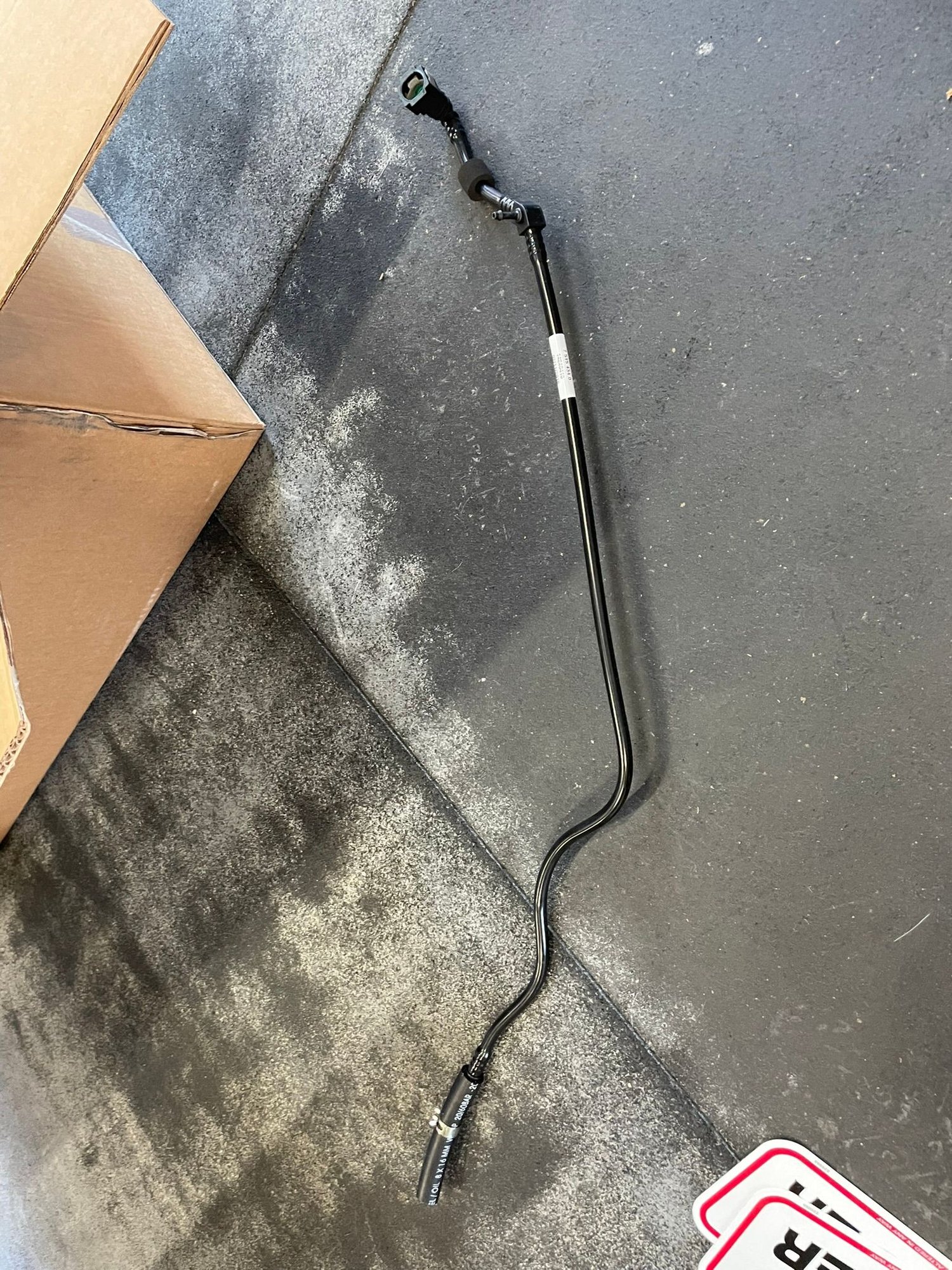

Old Oct 18, 2025 | 08:13 AM
ssoliman's Avatar
ssoliman
Joined: Feb 2018
Posts: 1,705
Likes: 317

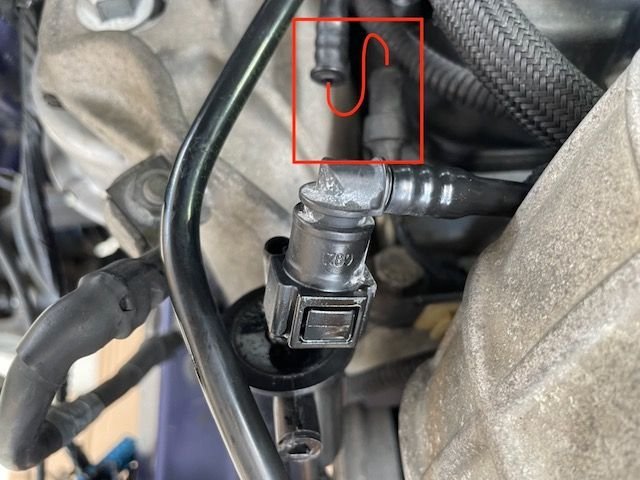

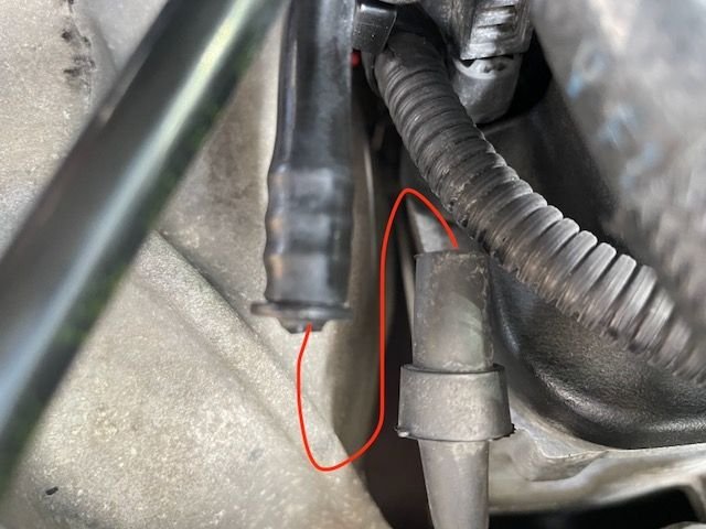

here is the line that broke, its an offshoot of the line that goes from the throttle body to the purge valve.
the nipple broke off in the rubber side.
anyone know what this line if for?
best fix?

was not able to find the vacuum line fittings for sale from BMW / mini. picked up some fittings from oreilly. going to give them a go
