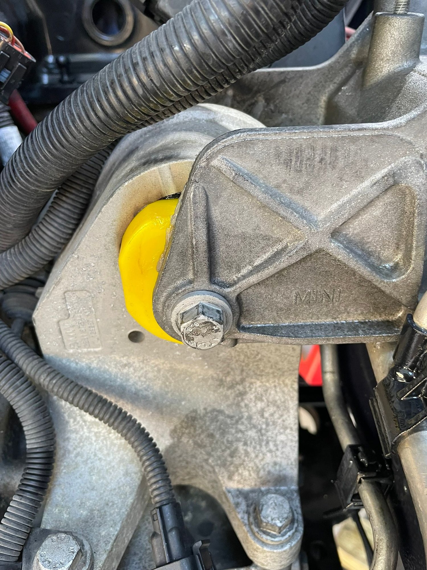

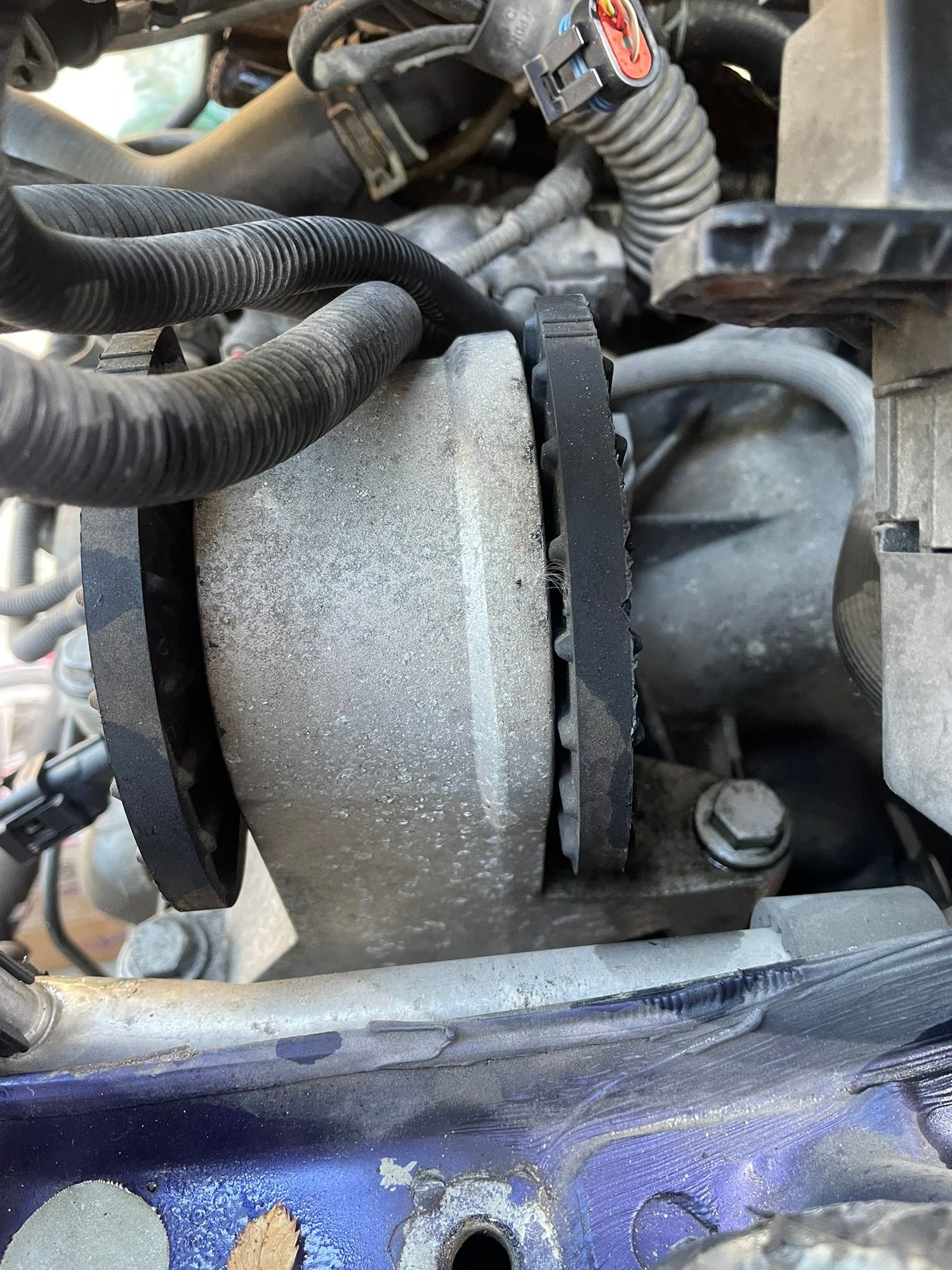

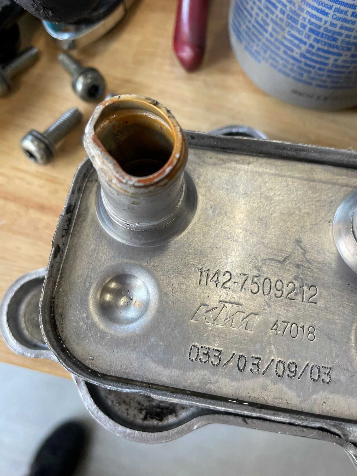

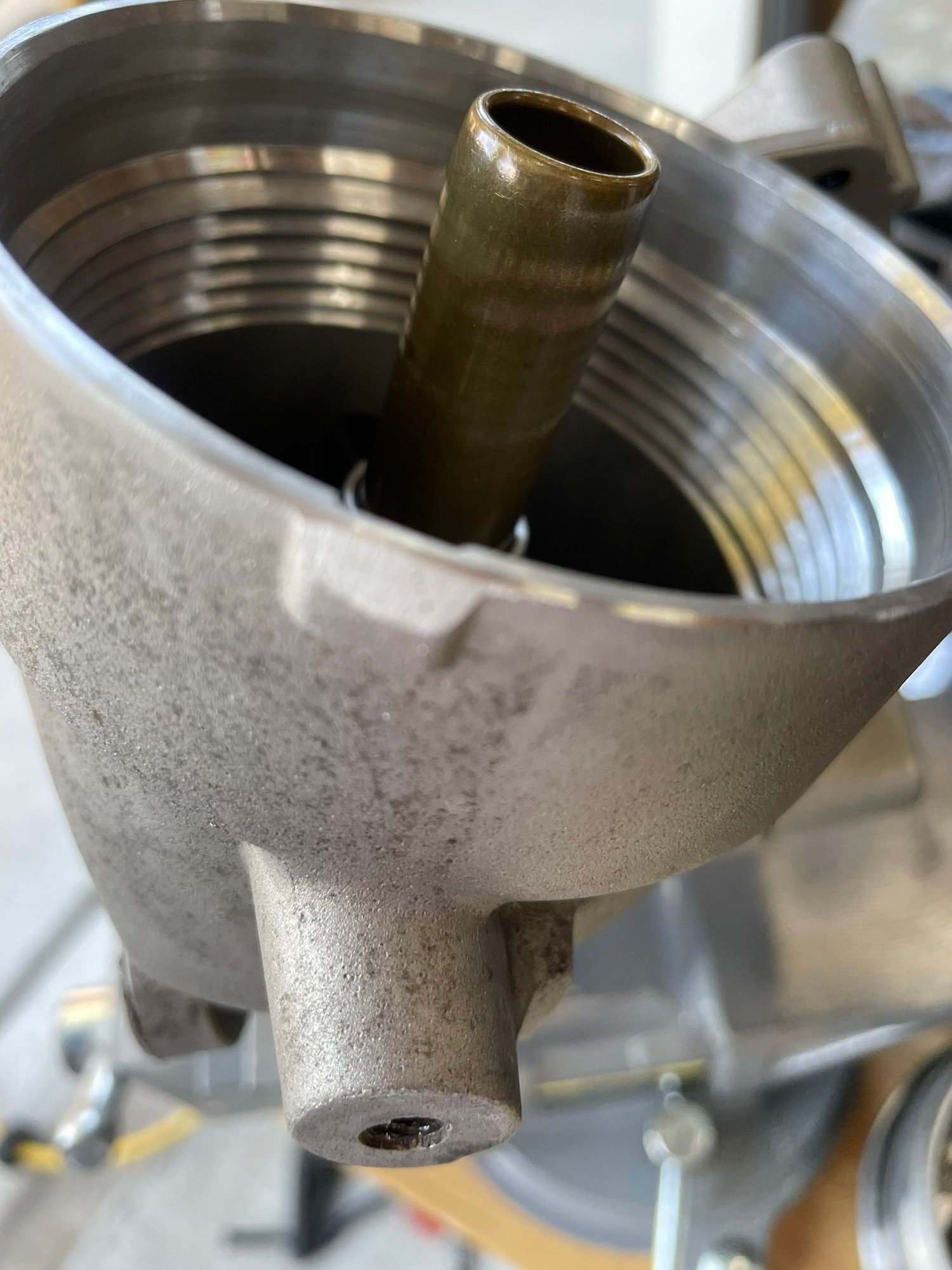

more work.

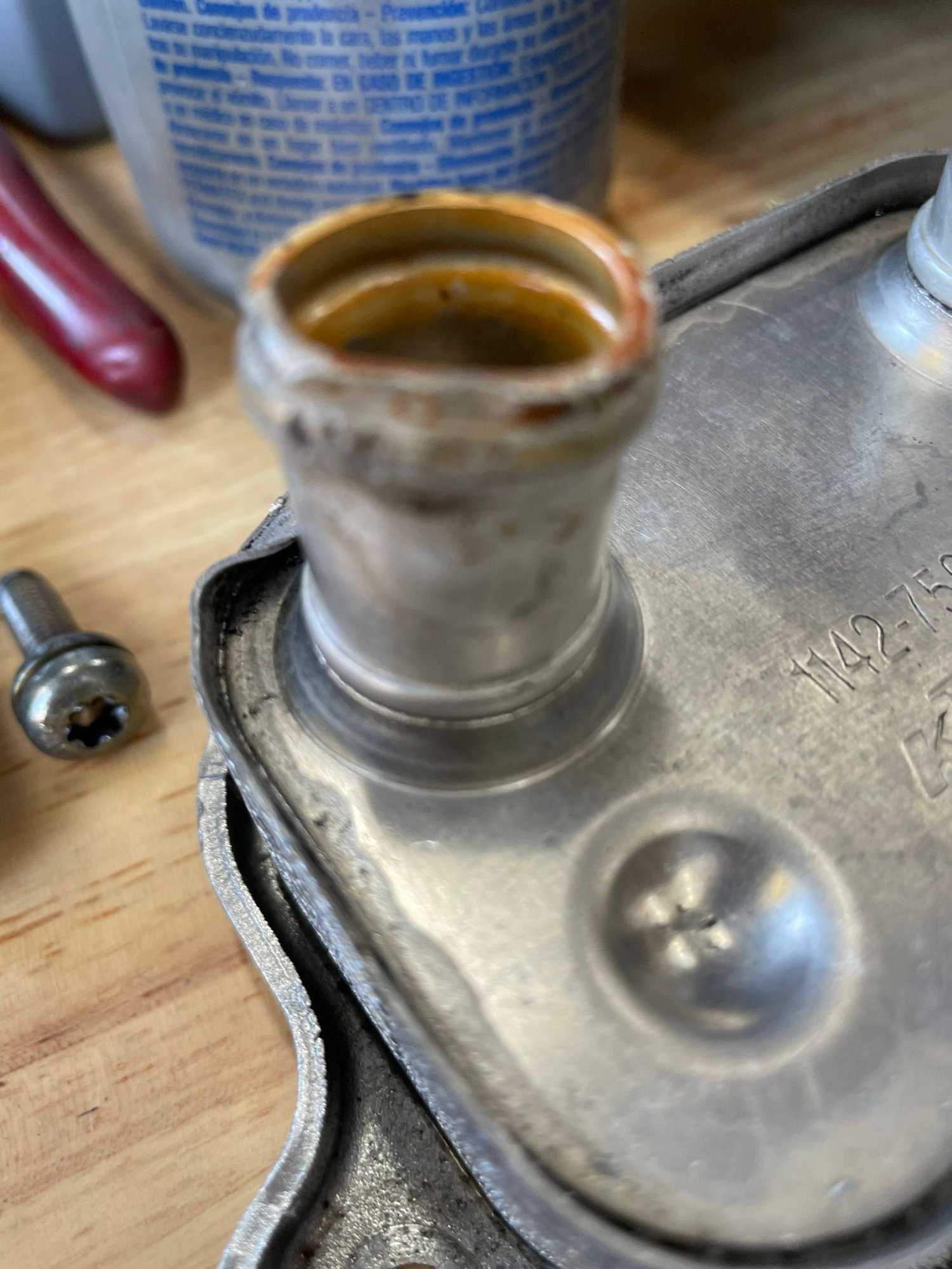

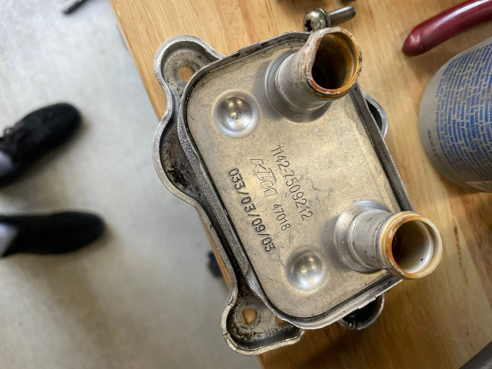

-new oil filter housing and heat exchanger

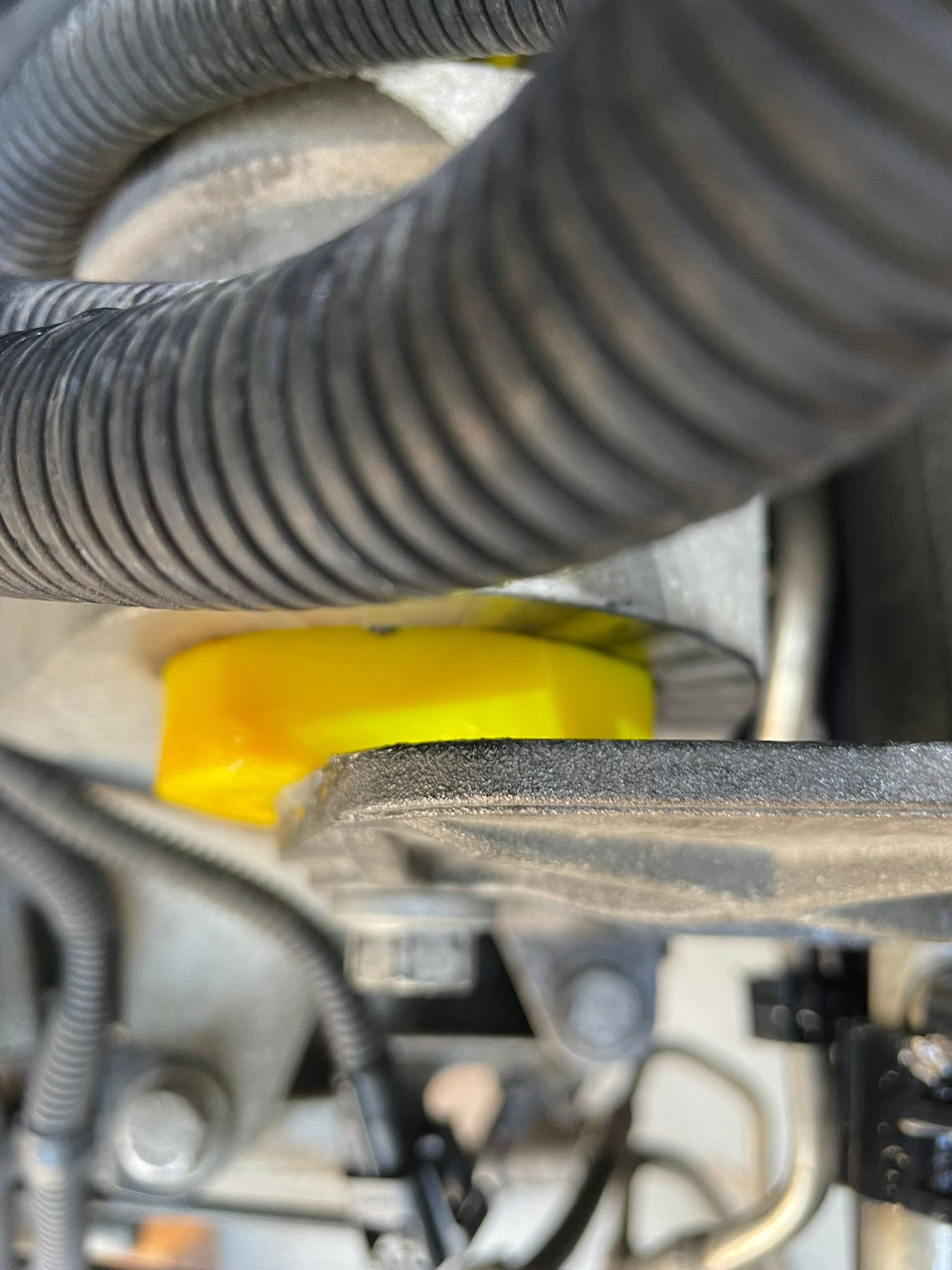

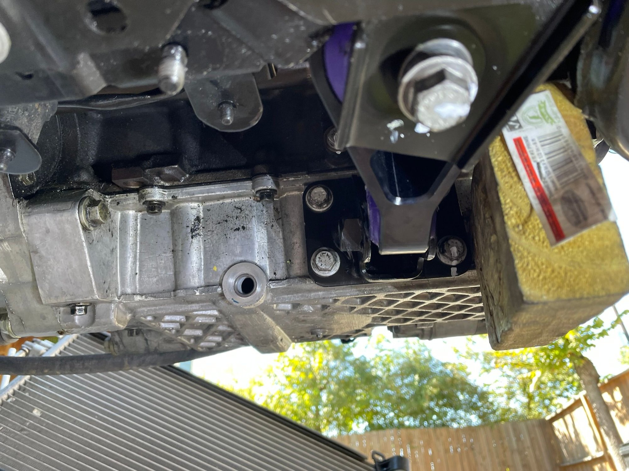

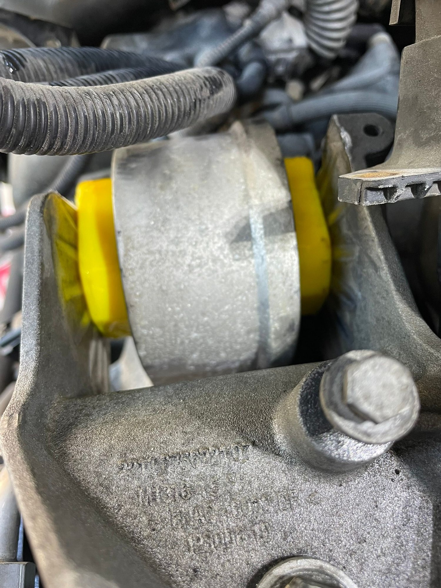

-installed powerflex inserts for the trans mount

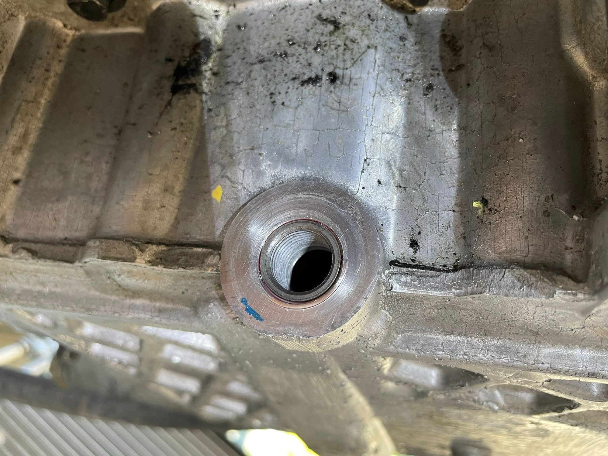

-repaired oil pan plug threads

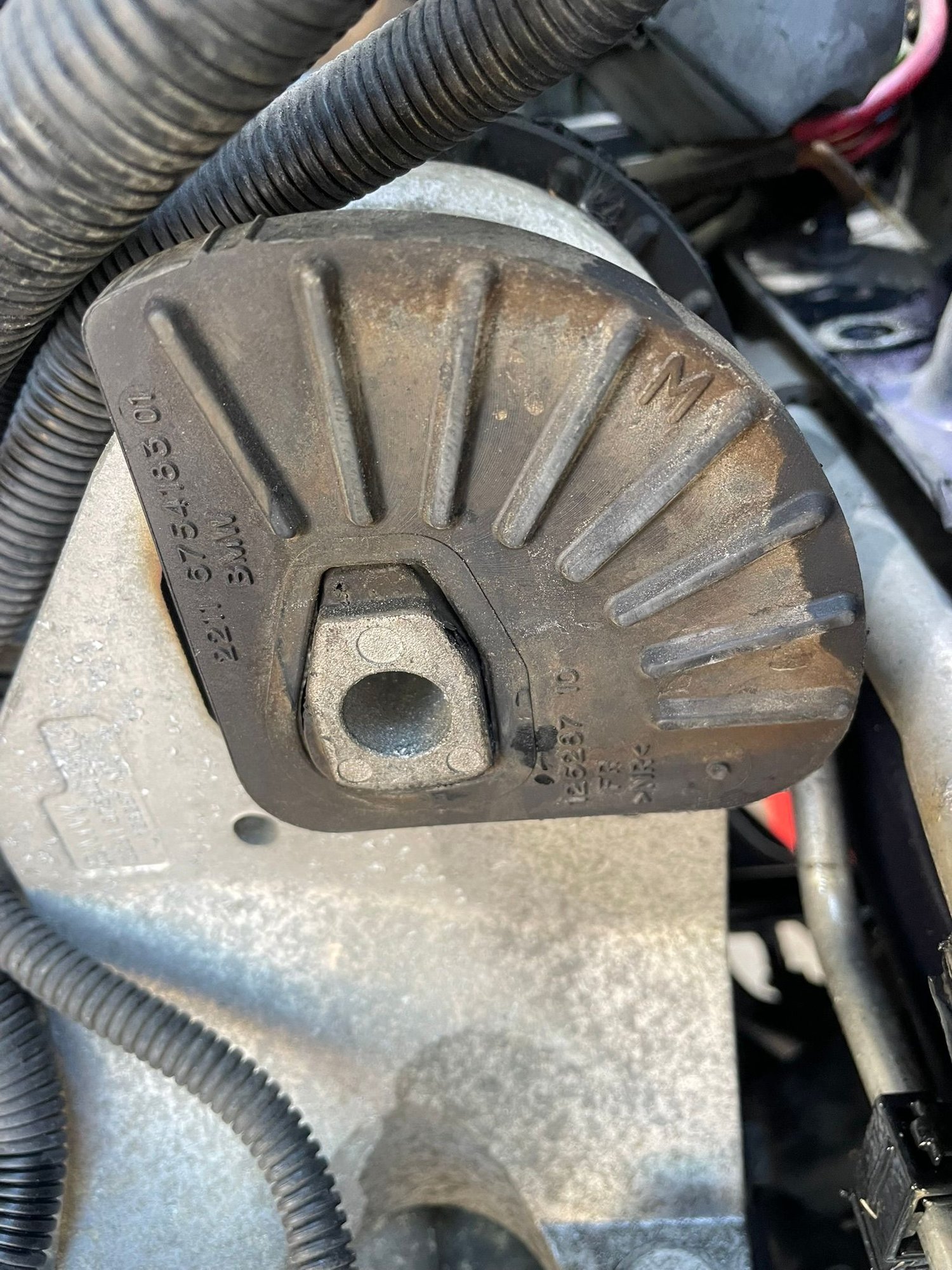

Ha,ha - Glad to see you hadn't used the powerflex.com pictures for reference when you installed the gearbox bushings. I don't mean to criticize PF but their trans bushing insallation reference pics for the bushings on an R53 are installed backwards!.
I was working on multiple replacement parts and repairs to shifter cables and upgrading to PF trans bushings which took longer than expected. I had forgotten which way the original trans bushings were installed. I went ahead and installed the new PF trans bushings the way PF had them facing on their website. I eventually figured out something didn't look right after putting everything back together.
I took everything back apart and flipped the bushing in the correct orientation. Mind you; it wouldn't have been so aggravating if I hadn't been for just freshly painting my trans mount & support bracket. Nothing worse than messing up a nice paint job.
I let Corey know about the pics. But I don't remember if they ever fixed on their website

those bushing on the trans mount make a big difference!
my mount was partially corroded and the bushing was shot, so i bought a new chinese mount and installed powerflex bushing inserts.

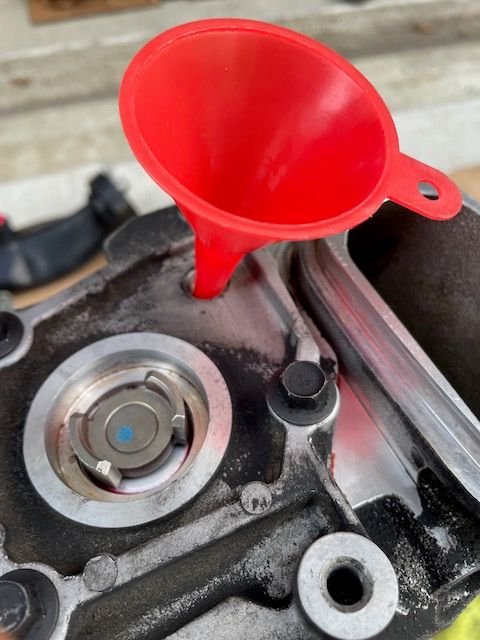

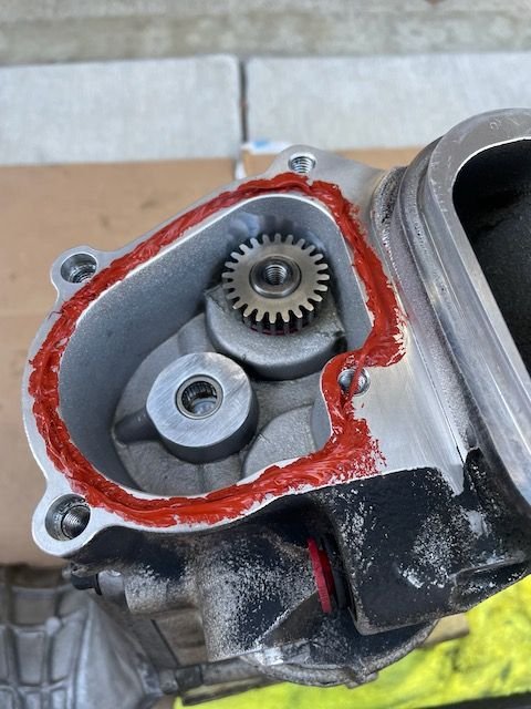

more work today

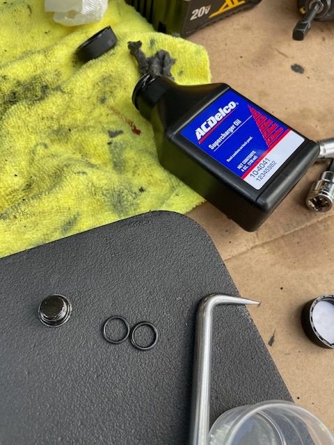

-resealed the water pump side of SC with high temp gasket maker
-changed the oil on the SC
-started on reassembly (did not take a pic. ran out of sun)

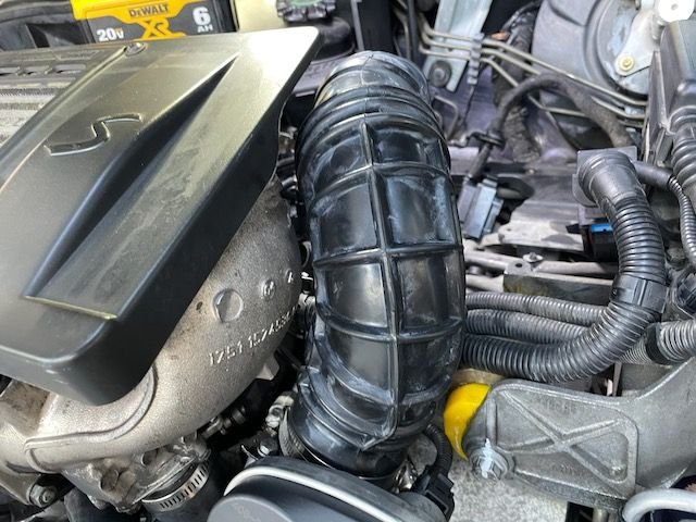

I got stuck on the throttle body. the bracket, off the trans, is not lining up with the mounting points). anyone seen that?

Ahh yes the pesky throttle body bracket... ensure your plastic charge pipe is properly installed. That small wide rubber hose can be a bugger. After that loosen the bracket, test fit the throttle body. Remove the throttle body gently and tighten the bracket, then reinstall. Patience is your friend here for sure. Best of luck

similar to scoobaru above, as i remember, i had it all fit loosely as i assembled and had to coax it all back together. then when it was fairly straight i was able to start tightening down things.
that plastic charge pipe in particular, i remember lubing the green gasket with some spit to get it completely mated.

what worked for me was leaving the two bolts on the bracket loose, very loose. once I got the four bolts on the throttle body tight, I tightened the bracket. access from under throttle body
some rubber assembly lubricant on the horn gasket. or penetrant spray helps. same for the oring on the water pump

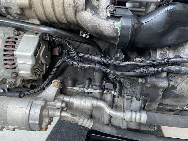

-fixed the one broken vacuum line and got them installed
-got the throttle body (and charger) back on
-new crank position sensor oring
-some heat wrap on the ac and alt cables
-installed new brake reservoir

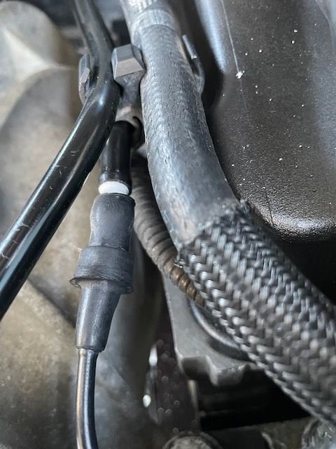

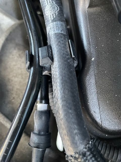

Originally Posted by ssoliman

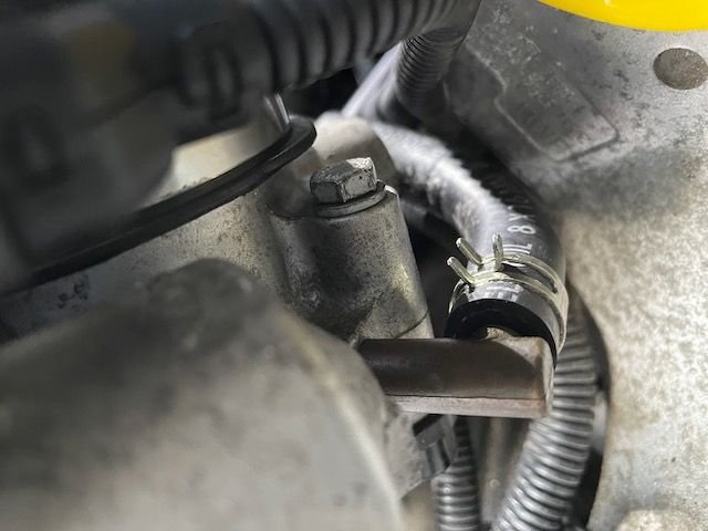

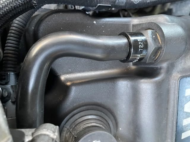

here is the line that broke, its an offshoot of the line that goes from the throttle body to the purge valve.
the nipple broke off in the rubber side.
anyone know what this line if for?
best fix?
the generic vacuum line fitting from Dorman worked. to get the fitting on to the plastic hose I had to heat it. used a heat gun. it went in but not as far as I would have liked.

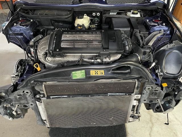

update, got very close to finishing this round of maintenance today.
-filled and bled the cooling system
-engine oil
-heat taped the brake reservoir (along the back)
-fixed parking brake issue (more on this in a sec)
-replaced shift **** (aftermarket **** broke on me)

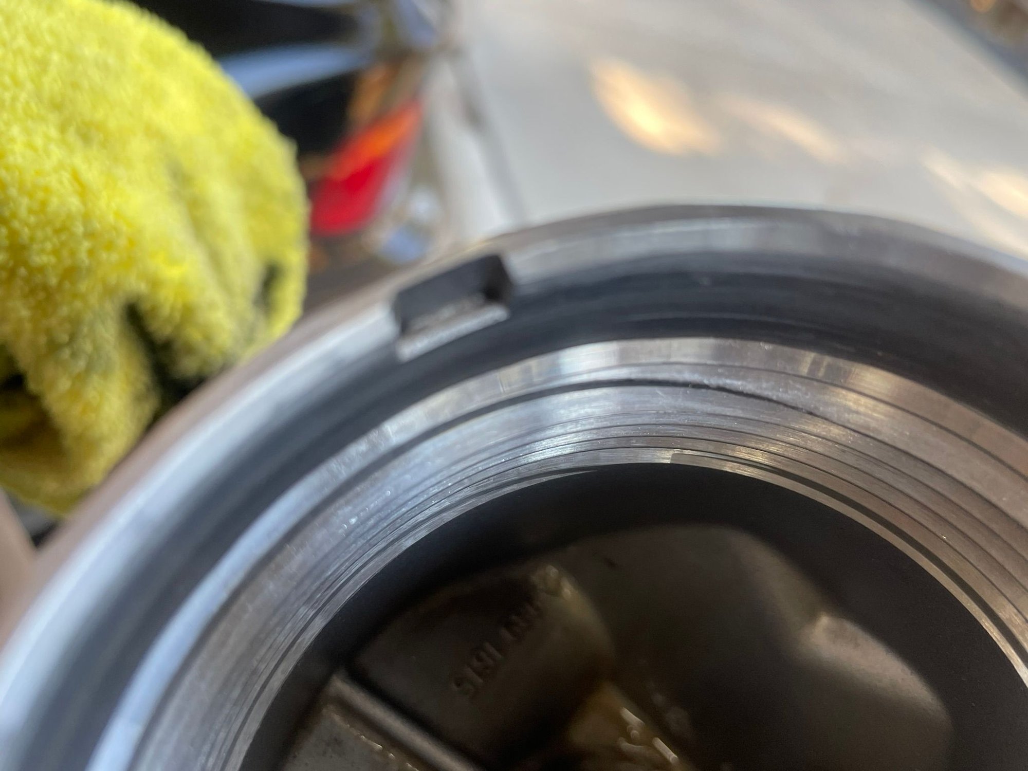

started the engine after turning it with the starter for a bit (spark wires disconnected). started. no leaks that I can see yet. engine temps were good. however my low speed fan did not come on. looks like the infamous fan resister died on me. I believe it's original, so fair enough. I ordered a new fan
the parking brake. turns out, the piston was not moving with the parking brake or brake pedal. seemed to be frozen. as some suspected. I took the caliper off and used the special tool to turn it out a bit. pressed the brake and it was moving again. fixed.
apparently it was my mistake. I over pressed the piston. pushed it back too far / hard. didn't even know that was possible. lessen learned
back on the ground. waiting for the fan. in desperate need of wash
