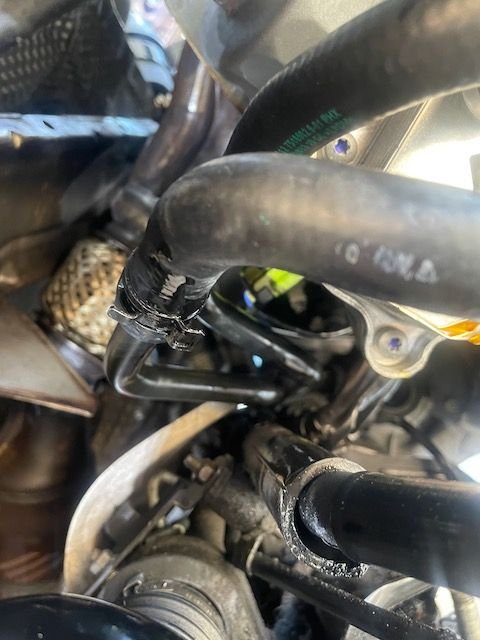

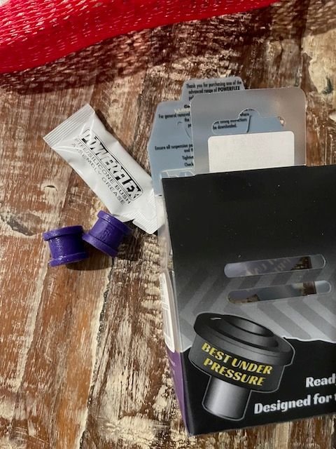

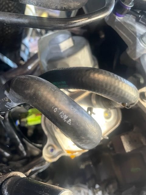

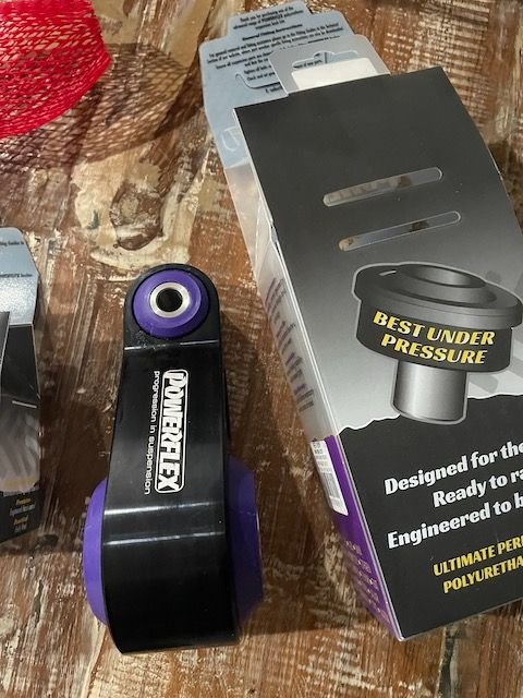

more good stuff showed up in the mail

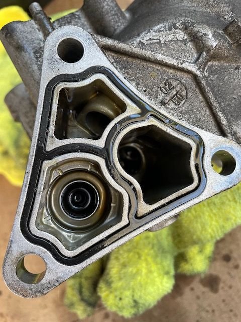

***question on the supercharger***
is it a good idea to seal the water pump side with high temperature gasket maker?
seems like the oil might have escaped / leaked out from this side as a common issue.
Old Oct 23, 2025 | 09:31 AM
  #28
phone_cover's Avatar
phone_cover
Joined: Feb 2022
Posts: 332
Likes: 154
that vacuum line should work with generic connectors like you got.
i don't remember what i did on mine with the water pump. i think i searched online and found that no one used RTV, but i can't remember with any certainty.

there was a video I saw, guy owned a business that rebuilds superchargers. he mentioned that with our SC the main issue was the seal leaking on the water pump side. then the gears on that side burn up. I notice, on mine, the water pump side of the case was dirty. like from the oil leaking out over time.
he didn't mention how he remedied the issue. guess thats the secret sauce

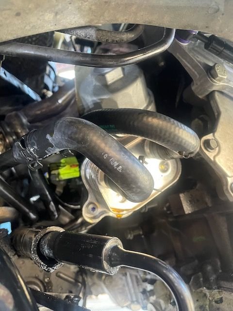

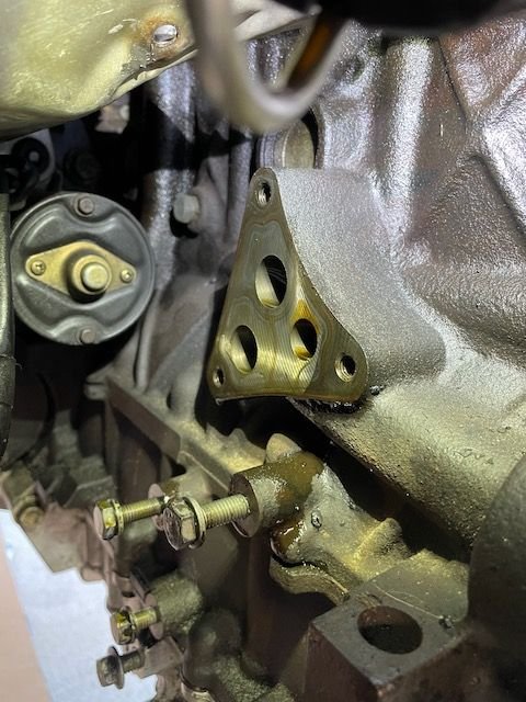

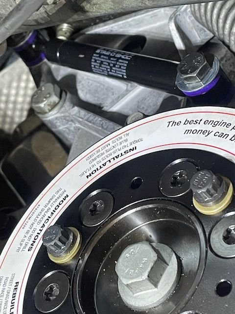

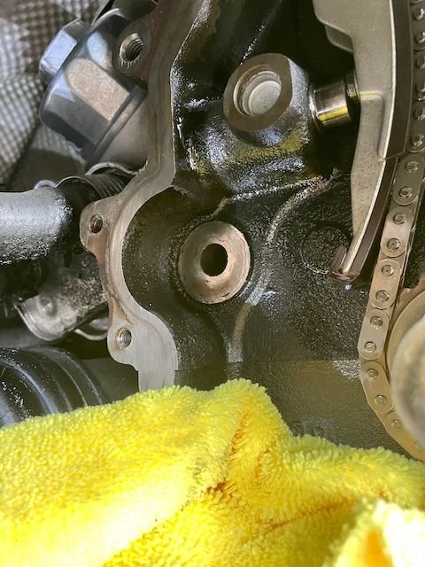

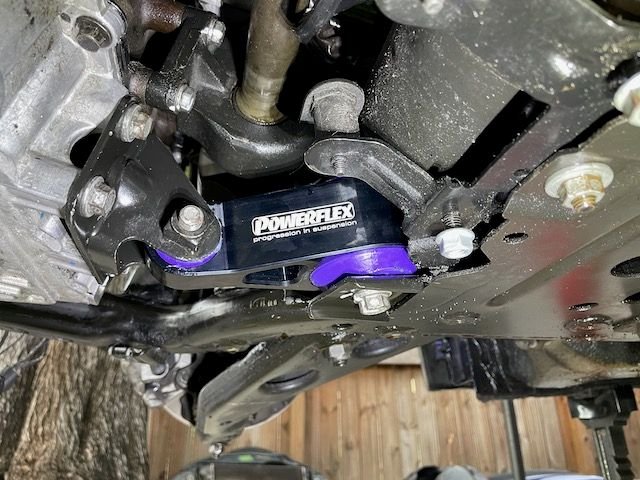

more work done today. some pics

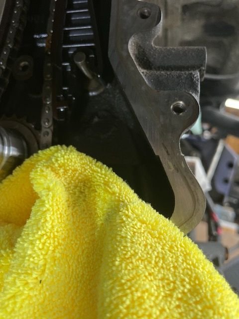

Old Oct 25, 2025 | 08:57 AM
  #31
ssoliman's Avatar
ssoliman
Joined: Feb 2018
Posts: 1,736
Likes: 329

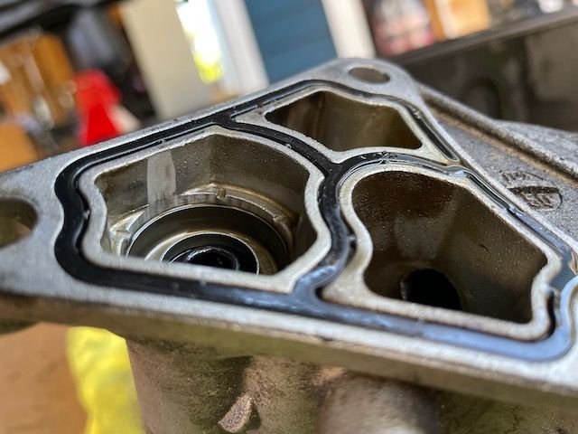

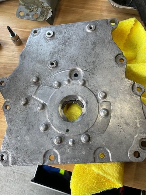

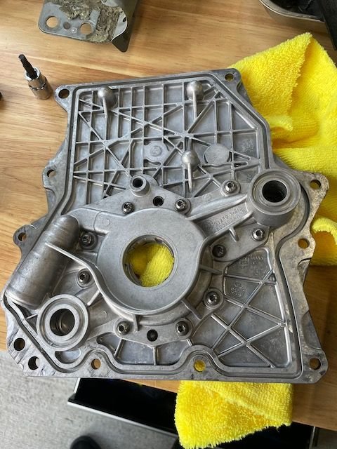

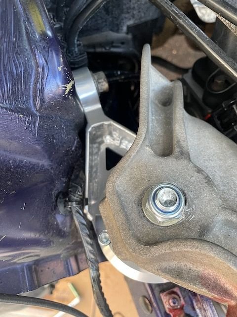

more work yesterday, some pics:

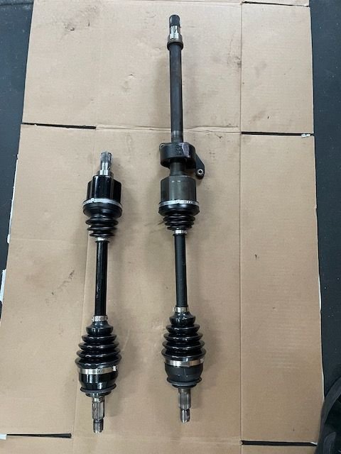

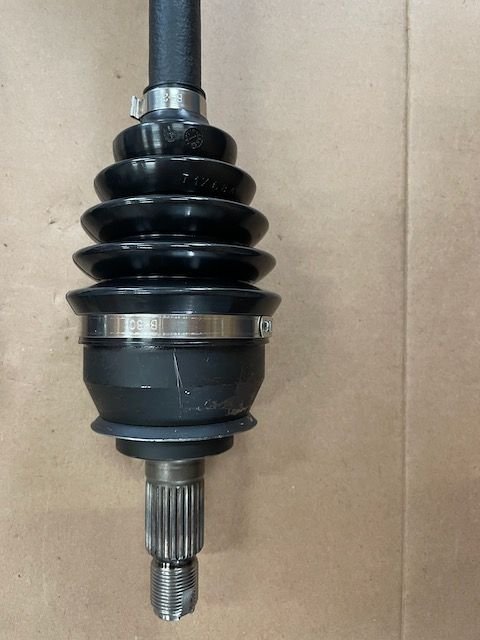

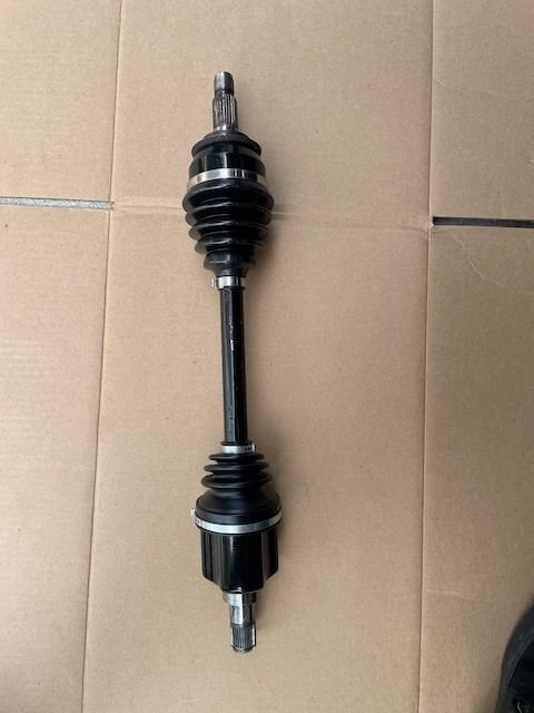

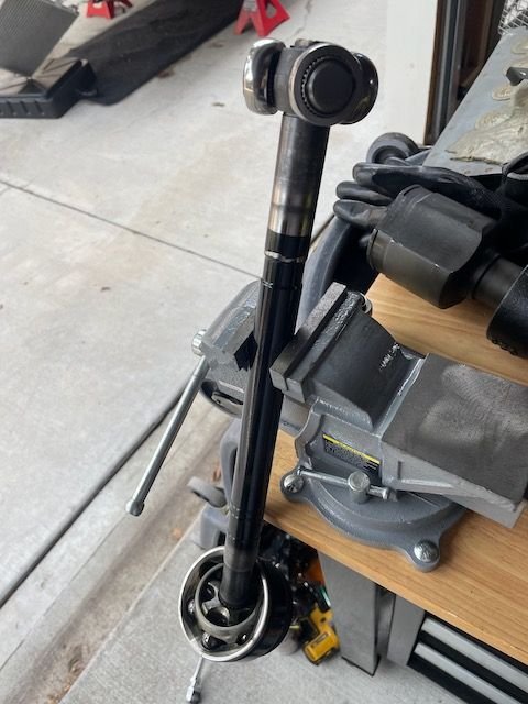

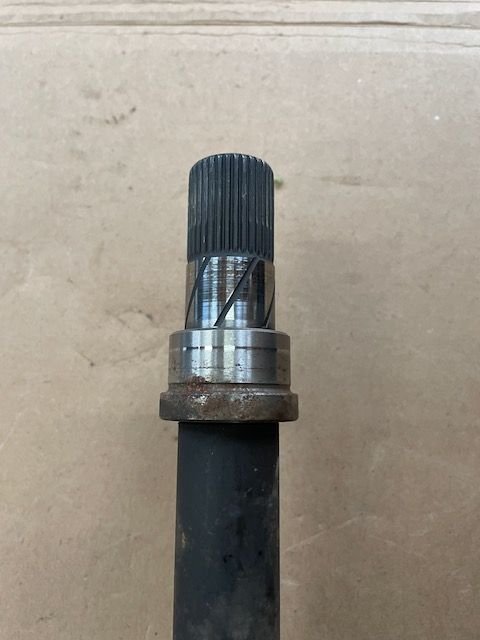

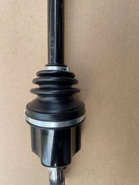

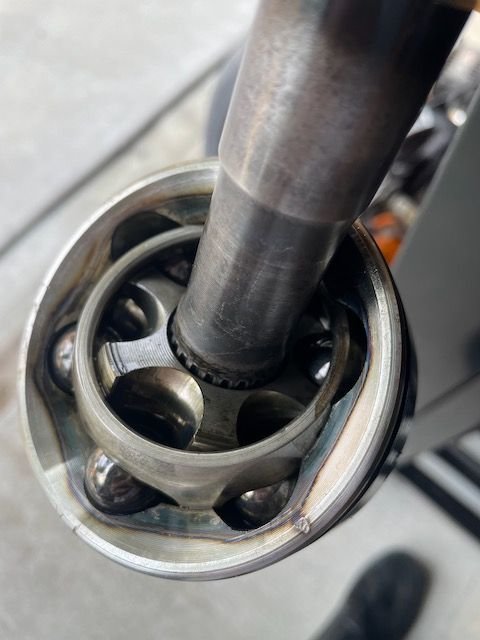

rebuilding the axles now. Anyone know a fool proof way to identify a stock axle?
Old Oct 25, 2025 | 07:26 PM
  #33
ssoliman's Avatar
ssoliman
Joined: Feb 2018
Posts: 1,736
Likes: 329

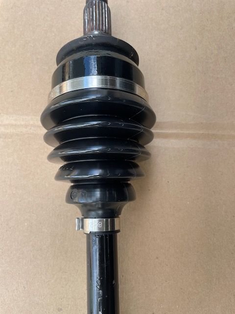

got the axles rebuilt today. some pics

I kinda feel like I should have rebuilt mine instead of buying replacements. The passenger side on mine leaks where it goes into the transmission. I've replaced the seal twice. But my originals were turned in as cores, unfortunately.
I used this to reseal the endplates on mine.
mine are not all original either i dont think
the left one is unknown
the right is now half GKN and half original. the GKN half is from a left side axle, originally
thank you, Dale. i think i am going to do the same on the water pump side. the pulley side was air tight so i will prob leave it be

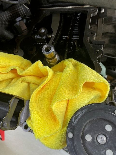

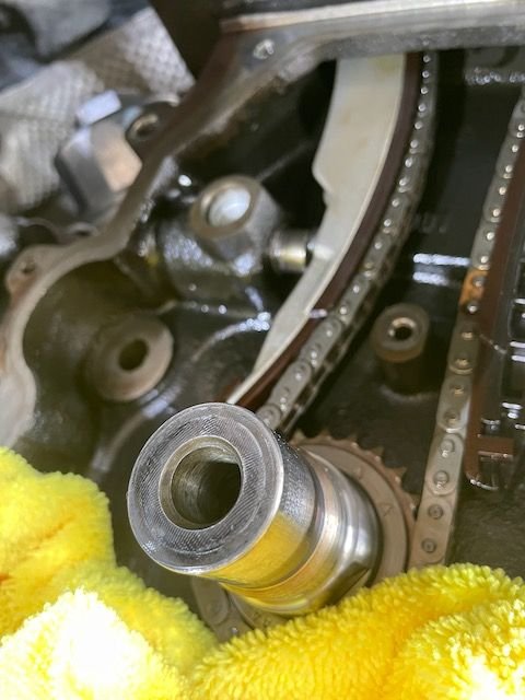

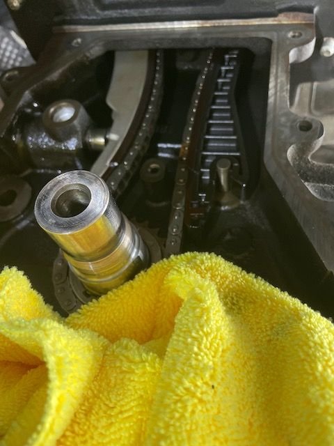

***question***
what is the proper way to install the timing chain tensioner, compressed or extended?
Old Oct 29, 2025 | 08:13 AM
  #41
phone_cover
Joined: Feb 2022
Posts: 332
Likes: 154
do it compressed so you can easily get the timing chain in place. then once it's all done, you can pop it open with a screwdriver or actual chain tensioner arm.
Old Oct 29, 2025 | 08:23 AM
  #42
ssoliman's Avatar
ssoliman
Joined: Feb 2018
Posts: 1,736
Likes: 329
sorry did not included enough detail
the chain is in place. will not be doing the chain, tensioner rails, sprockets etc this round. the valve cover is not coming off this time and the chain cover is already back on.
compressed or uncompressed?
Old Oct 29, 2025 | 10:15 AM
  #43
LukasH's Avatar
LukasH
Joined: Jul 2024
Posts: 333
Likes: 306
ModMini states compressed. You will get a short rattle at start up but once oil pressure is there, its gone. Should not take more than 3 seconds.
Old Oct 29, 2025 | 10:24 AM
  #44
Scoobaru2010's Avatar
Scoobaru2010
Joined: Oct 2022
Posts: 227
Likes: 185
From: Ontario, Canada
@ssoliman Compressed indeed, once you have it installed gently pry back on the tensioner to release it. Sometimes they wont release until startup as mention and you'll get a 3 second death rattle. Part of mod minis headgasket video i followed back last year, should be here about 14 mins in ->
Old Oct 29, 2025 | 11:40 AM
  #45
ssoliman's Avatar
ssoliman
Joined: Feb 2018
Posts: 1,736
Likes: 329
thank you for the feedback, Gents. I did see that video.
TIS also says to install it compressed and then "ratchet it out with a lever". that would be from the top, if the valve cover were off (the valve cover is not off).
I can't help but think that it would be safer to install it in the extended position. That way i am sure that the chain will be in tension on first start
i'm i overthinking it?
Old Oct 30, 2025 | 11:41 AM
  #46
phone_cover
Joined: Feb 2022
Posts: 332
Likes: 154
i think your risk with doing it expanded would be in trying to make sure you get the tensioner cover plug back in place properly. the risk with doing it compressed and letting the engine pop it out would be that the timing chain could skip a tooth before the slack comes out.
i think it would be less effort to retighten the plug than address a skipped tooth.
i installed mine with the oil pump removed. i was able to look at it both ways and spent a little time playing around with the two options. i don't think you really are going to create any problems for yourself doing it expanded. that's what i would do.
Old Oct 31, 2025 | 06:52 AM
  #47
ssoliman's Avatar
ssoliman
Joined: Feb 2018
Posts: 1,736
Likes: 329
thats what I was thinking. still waiting on the new cap / bolt with crush washer. waiting on delivery but not sure yet what I will do.
seems like its accessible from the top. so I could always do it later when I have the valve cover off.
now I'm feeling like I should have pulled the valve cover and done the chain, sprockets, guides. How important is replacing the chain and sprocket as a maintenance item (not currently having any issues at ~160k miles)
trying to avoid scope creep on this round of work

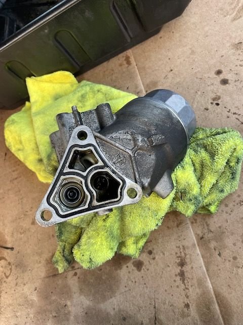

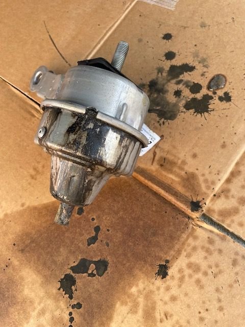

got the oil filter housing, drive shafts, and lower engine support back in yesterday

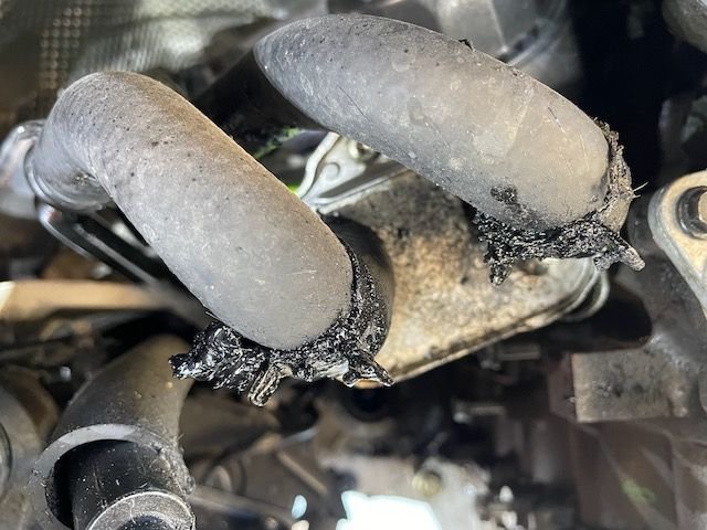

the black grease from the busted driveshaft boots is EVERYWHERE. went through so many shop rages
​​​Well not much help but more of an admission to stupidity and guilt. I too spent an inordinate amount of time cleaning up all that grease from a torn inner axle boot while refurbishing my axles. After all that work only to discover, again, grease was everywhere after my first drive - I had forgotten to burp the inner passenger side axle boot. A mistake I'll soon never forget. A kindly tip from my own faux-pas...
Make sure you burp the boots.
