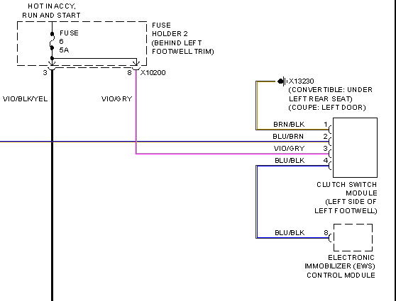

I'm taking over the diagnostics now, so I'm currently looking up the Clutch Switch Diagram, I will assume I need to jump Pin#3 & pin#4 (or press clutch pedal ) following the diagram below? (pin#2 goes to DME) I will also assume pin#8 in the EWS is expecting a 12v signal, and Pin#3 in Clutch Switch should be live 12v?
I have reviewed most of wiring diagrams and have a better Idea of sources to verify, including fuse box, ignition switch, Clutch Switch and EWS inputs. Hopefully these can narrow down the culprit.

Jumping the pins is only necessary if you want to bypass the clutch switch. Since you just installed a new switch I doubt that's your problem.
