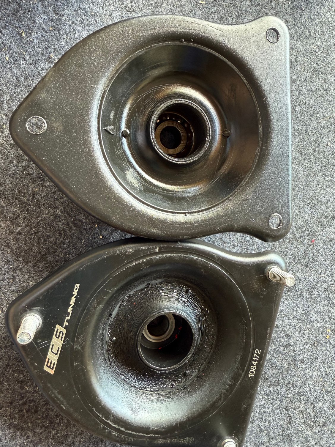

This next photo shows the old ECS mount on the bottom and on top is the genuine MINI mount with the studs removed. Note a little bit of cracking in the paint on the rubber.

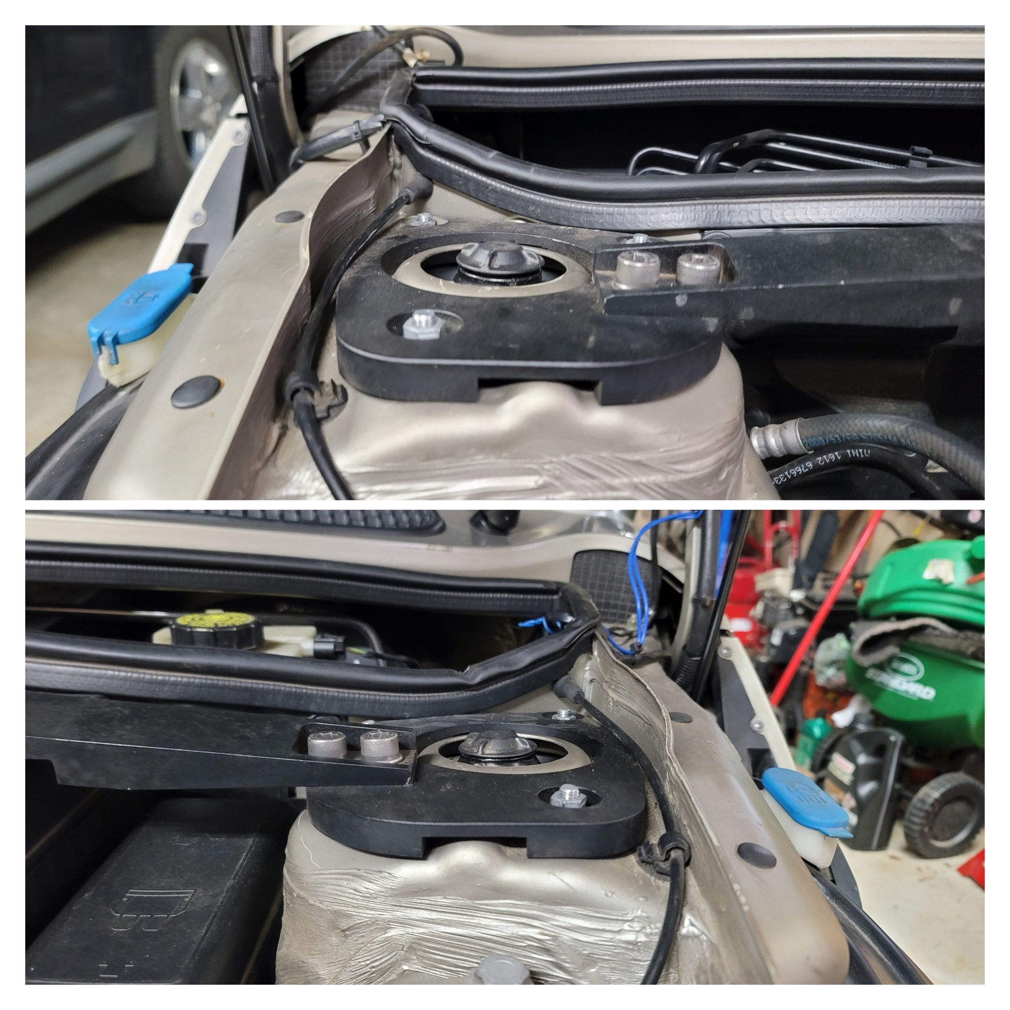

After install with the car back on the ground, we see a little bit of stretch from the center of the mounts but not a terrible bulge like what happened immediately with the ECS mounts. Hopefully this will be the extent of it and any crackly paint just flakes off. Kind of annoying how the large hole of the under-tower plate doesn't match the opening of the strut tower.
After a short test drive, there aren't any major changes, although the new under-tower plates add 4mm or so of buffer to mask any upward bulging.
I'll update here if there are any issues after I put some more miles on the new genuine MINI mounts.

The ECS plates that go on top of the strut towers use a special nut (which are currently out of stock according to their website). I had to destroy one to get it off, and the threads of others were worn out. I intend to get a different set of plates for the top of the strut towers that use the stock nuts.

That makes sense because the nuts on the ECS plates don’t seem to have enough thread to catch the threads on the upper strut mounts like the Way MotorWorks & Cravenspeed defenders , plus the special nuts are real expensive like the M7 plates…
