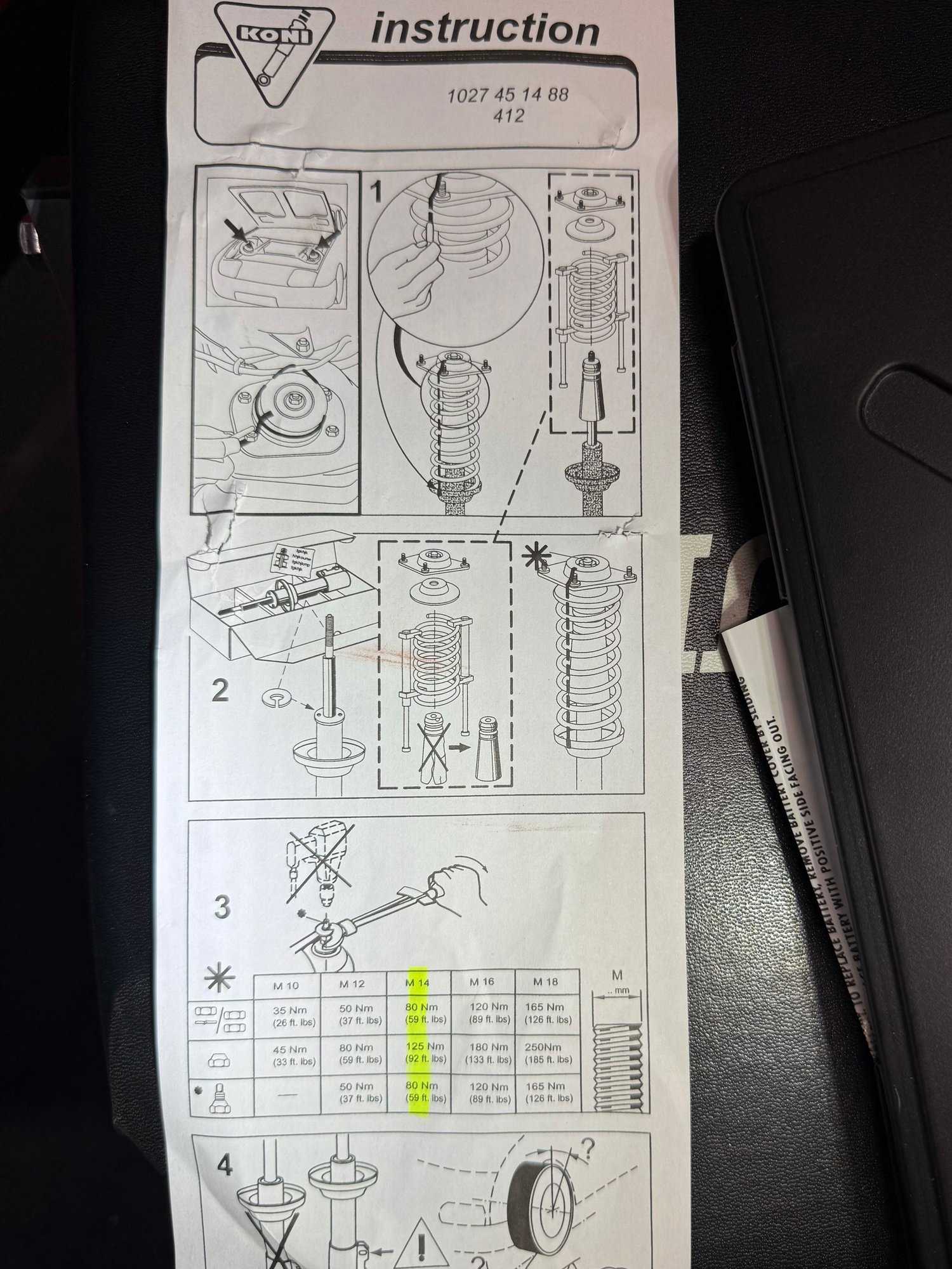

Well I found the paper I apparently overlooked that came with the Koni struts. I assume the nyloc bolt is one of the 59 lb/ft rows for the M14 on this chart.

I really doubt 12 ft lbs difference would cause your mounts to fail just from setting the car on the ground. The entire weight of the front end should be contacting the center race of each bearing, and if your springs were soft, it would just mean that the front end would sit too low.
I’m confused.
You still have the other washer on top of the spring hats, right? I seem to remember there being two washers per side, but it’s been a while since I looked at one of these.
Edit: I guess it’s actually a dust cover and a washer per side and not two washers.

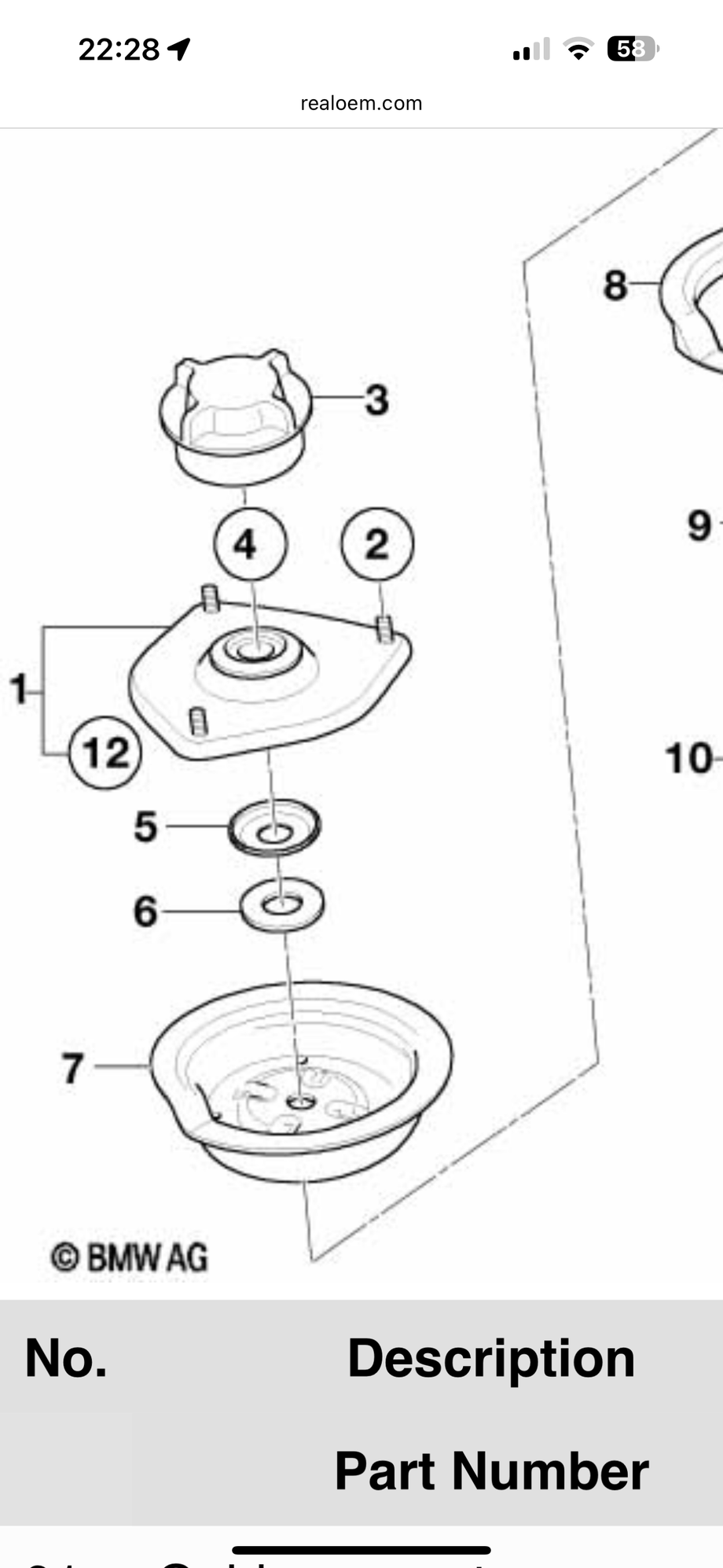

See realoem pic
Part #7 is the upper spring cup.  #4 is the upper mount that you are in trouble with.  Where are #5, and #6?  They are needed to keep the strut from coming thru the mount.  They are not evident to me on the Koni pic.

Originally Posted by noodlesandsam
See realoem pic
#6 is installed per the diagram. #5 is NOT currently installed, as it doesn't fit with the ECS mounts and their bearings are sealed already. In my previous attempt with the Lemforder mounts, I installed both 5 and 6, per the diagram. Same result with the bulging mounts both times.

Okay, that’s what I figured. I suspected that if you hadn’t installed the washer that the mounts wouldn’t spin properly on the struts, and you would have noticed.
Bummer about the stripped threads.
