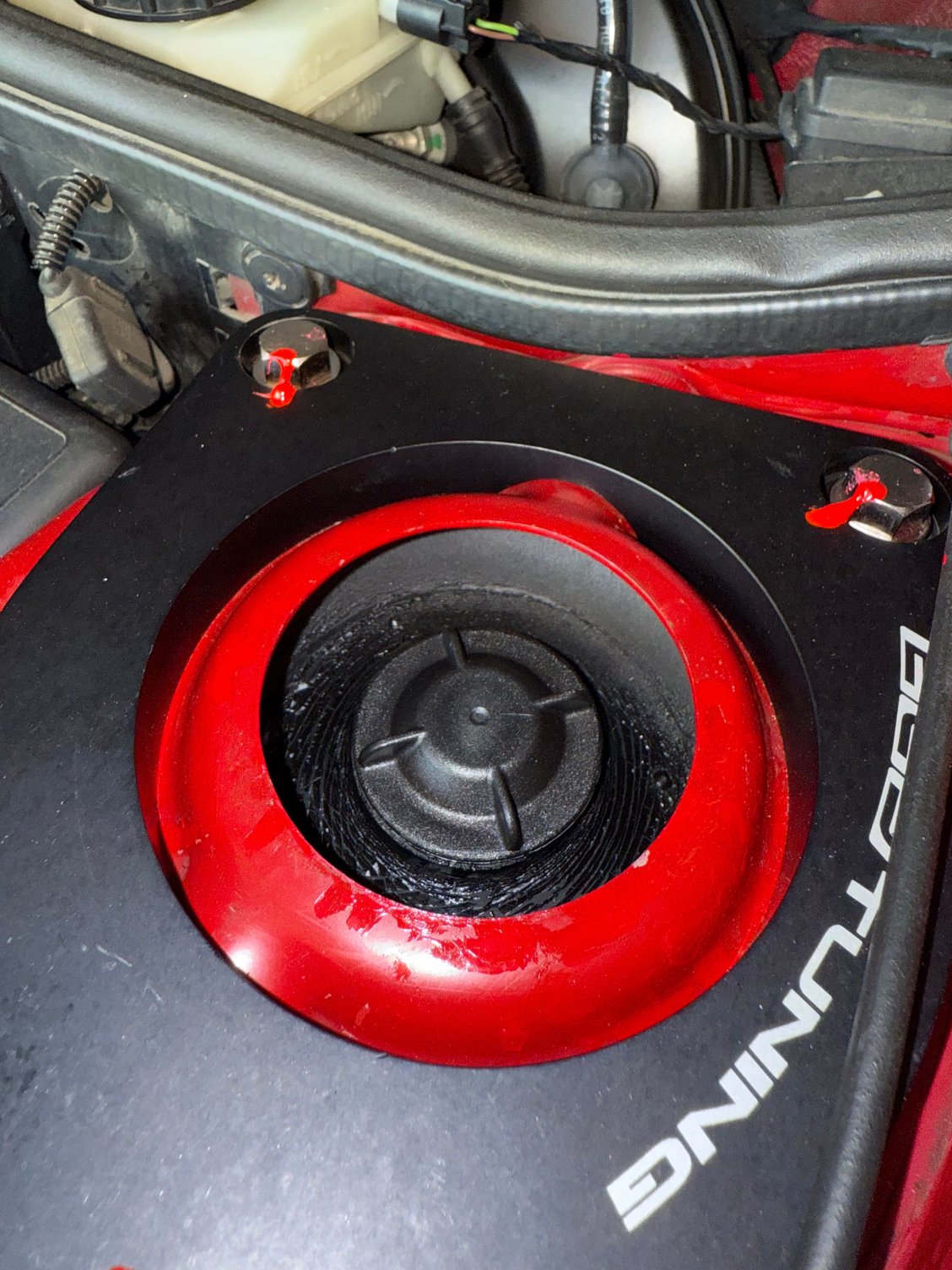

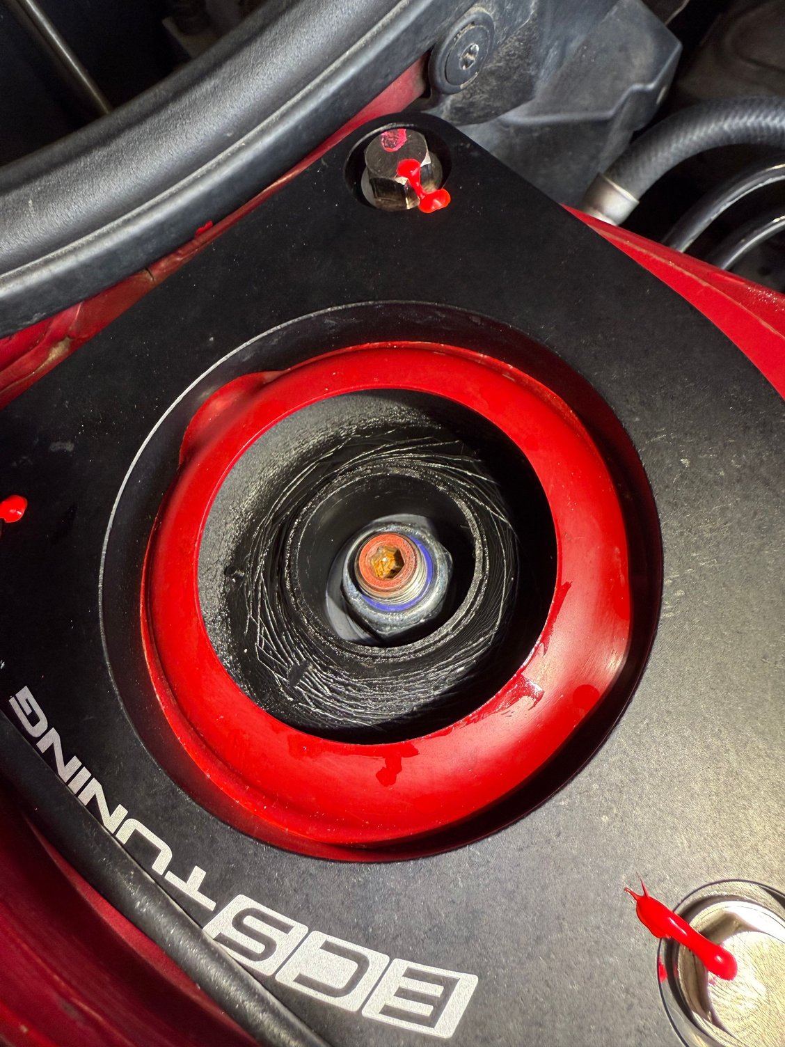

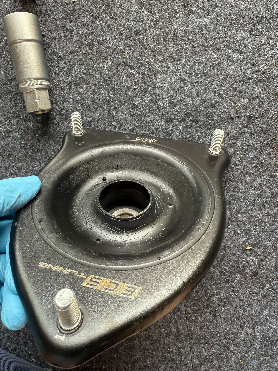

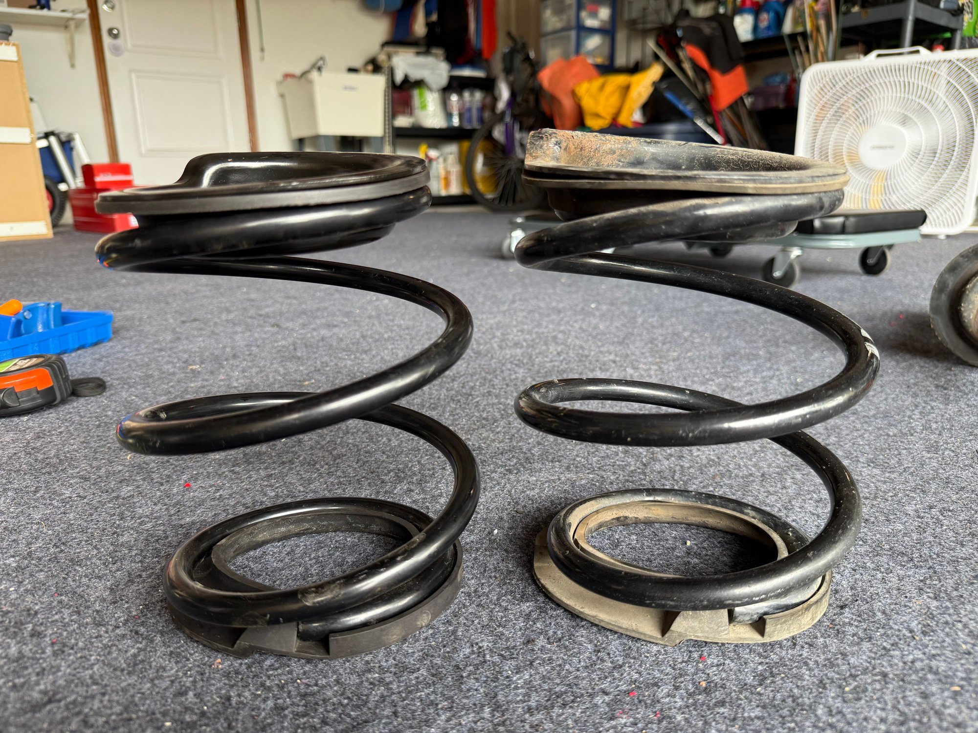

Okay, time for an update here. ECS customer service was kind enough to send me a new set of their mounts and front Koni struts. Today I removed the front right/passenger side strut assembly.
First, I compared the Koni Special Active with the original strut and found the Koni to be 1/4 inch longer from the tab (A) that secures into the steering knuckle, to the the collar on the strut rod (B) where the upper spring plate rests. Probably not a big deal. Also, on reassembly, I was extra careful to make sure the spring plate sat properly on that collar, just in case that could've been an issue in my previous attempts.
Next, I disassembled and compared the original springs from the car to the Lesjofors I previously bought from FCP Euro. Not as obvious in the photo, but the original (right) is a little taller and has a slightly different profile than the Lesjofors, especially visible when seated with the spring plate and rubber spring pads.
Continuing on, I swapped the original MINI spring in with the fresh rubbers and plate, and turned to the new mounts. Out of the box, the new set of ECS heavy duty mounts already shows some cracking in the paint if you look closely.
New vs the previous set that have a little over 100 miles on them, where the rubber has deformed and the paint is flaking off:
Next, I reassembled, using a brand new Koni strut and ECS mount, along with the original MINI coil spring. After a short test drive around the neighborhood, here is how the new mount looks:
It still looks bad but I think I'm going to call it progress. The mount doesn't seem to be bulging up nearly as bad as before and I probably wouldn't think twice about it if there weren't all the cracks in the paint. If I take a pick or my finger nail, I can scrape off the flakes of paint and there is normal looking rubber below. With the dust cap off, there is about 3/8" between the top of the bearing and the opening of the strut tower. The old, bulged ECS mount on the other side is level with the opening of the strut tower.
Also, the right side of the car with the original spring and new strut/mount is sitting about 2cm higher than the side with the bad mount and Lesjofors spring. The newly changed side will probably settle lower but just sharing all the observations I've made.
Tomorrow I'll work on the driver side, again swapping the original springs in with the fresh mounts and strut. Then I'll put some miles on the car and see how it looks. If the result is still bad, I think I'll order the Project Silver camber plates and be done with the rubber mounts.

Originally Posted by GLEX
I just finished installing the ECS mounts. Initial impression is positive, they're nicely packaged and seem to be higher quality than the Lemforder alternative.
The bearing felt smoother and appears sealed unlike Lemforders, and I elected to leave off the little sealing washer since it didn't sit right with bottom of the already sealed bearing.
Things were looking great until I got the car back on the ground. The new mounts are now bulging almost as bad as the previous set.
So that brings me back to where I started and has me thinking this isn't an issue of the mounts being defective. Again, everything is torqued to spec, new bumpstops, Koni struts, etc. When I started this whole suspension refresh, I found some concerning rust on my rear coil springs. With those NLA from MINI, I ordered Lesjofors from FCP Euro. Since I was replacing the rears, I figured I'd also do the front springs. Before installing, I measured and found the dimensions of the old and new springs to match, including the diameter of the metal making up the coil. However, now that I have two prematurely and strangely worn sets of strut mounts, I'm thinking maybe the Lesjofors springs are not a proper replacement and I should swap the originals in. What do you think?

So when checking the top mounts for cracks all seemed well, untill I noticed they were bulging exactly like yours!
I replaced my top mounts the 6th of January 2024 with Lemfroder ones and only drove about 6k miles on them. Again, I am running stock shocks and stock springs. I am stumped and am convinced this is the cause of my rubbing noise.
This weekend I'm working on swapping in new mounts on the front, polyurethane bushings in the rear shock mounts, and new sway bar end links. Unfortunately, I've been hung up with one of the studs spinning on the strut mounts. I'll have an update for you in the next day or two when I'm done, but I'm optimistic about the new genuine MINI mounts. I found an R53 group on Facebook with a lot of people from the UK, and dozens of reports of the same issue I've had. Some say Corteco mounts are okay, but the general consensus is that anything except genuine MINI strut mounts can be expected to fail anywhere from immediately to a few thousand miles. I also found generally bad reviews of the Silver Project camber plates, so I went with a new set of genuine mounts. Fingers crossed.
