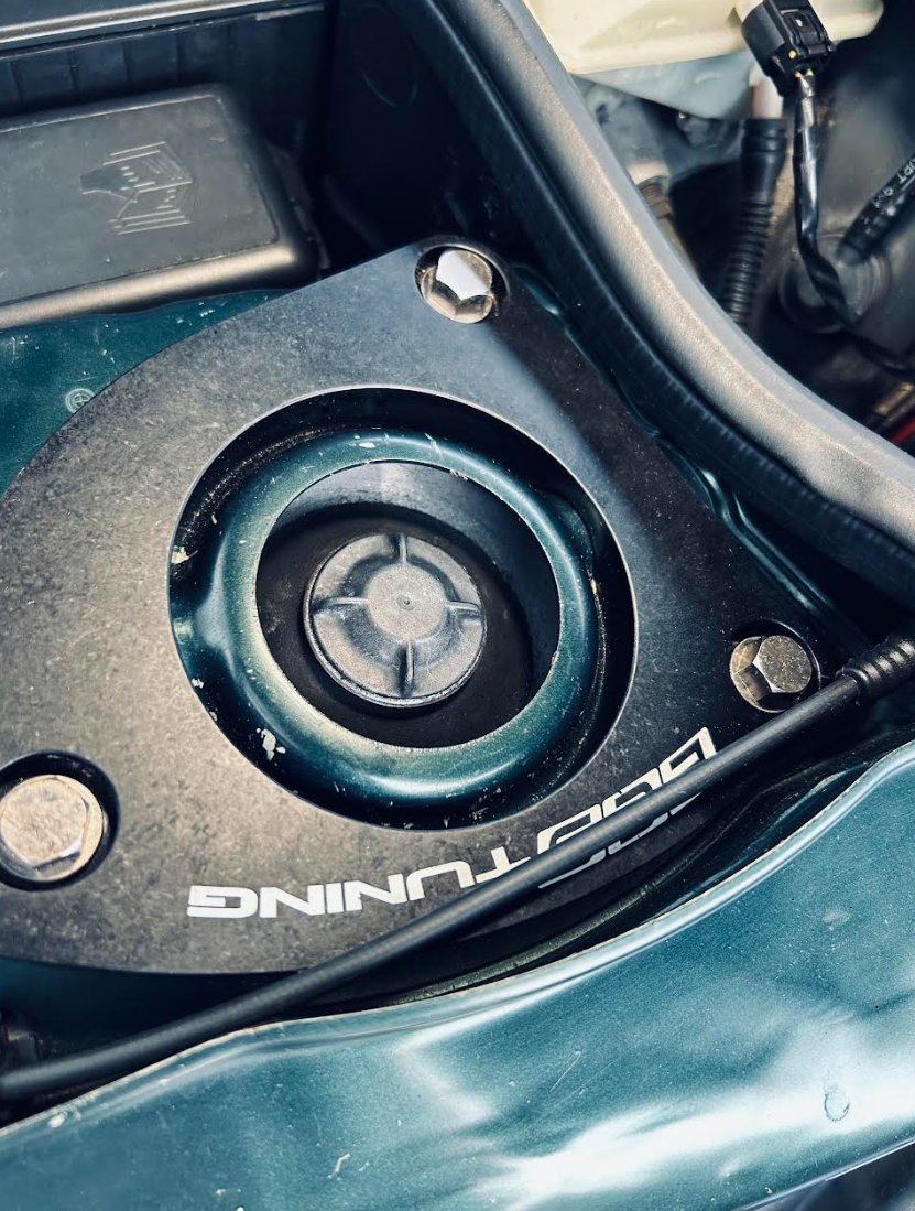

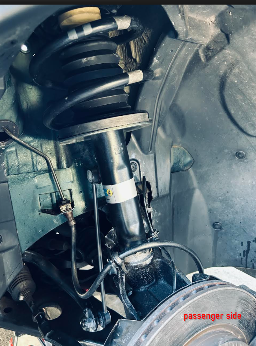

I replaced mine from last month ( may ) front struts. My R53's with 01/2004 production date.
Below is exactly what I have when I replaced the original stock factory parts. Struts are Delphi brand and the mount has something faded mini\bmw on it.
I replaced with Bilstein B4 with Lemforder strut mounts ( right now no bulging, i hope it lasts )., replaced also the washers and bump stops new and the boots.
I reused the stock MINI springs, & the rubber supports. They all fit just like the stock factory mini parts no issues with the bearing cover + lemforder mount.
Thanks for the feedback on the B4 setup. How are they riding? I recall from my research that the B4 is roughly equivalent to the stock strut ride quality, while the Koni FSD/red/Special Active is supposed to be an improvement.
While I'm an amateur in the garage and wouldn't put it past myself to make a dumb mistake, this strut stack is a well-documented, pretty simple assembly. I've done it twice now, checking my previous work and getting the same result, so I'm wondering if maybe this is a Koni fitment issue. I double checked the Koni part number from my ECS order with Koni's website, and I've contacted Koni to see if they have any input.
I also reached out to a well-known MINI mechanic who said this all seems normal, and I don't need to be concerned with the springs or nut torque spec. I don't know, it sure looks wrong to me plus the car sounds off going over bumps at low speed, like I previously mentioned.
Oh man even with this STOCK Bilstein B4 it's a night and day difference well ofcourse maybe because the DELPHI ones are really bad, all are shaking inside the cabin, the dash everything., I replaced all 4 with these all the annoying noise are gone.
I tested it on humps it's quiet, also in bad streets here in NYC., with some really not deep potholes. My past experiences are with japanese cars nissans and saburus so with this MINI I am really new. This bilstein B4 is equivalent of OE KYB this is what nissans ussually used.
But again I just want this car to bring it back to stock factory., & make it reliable. It will not be a daily driver car., it's only for weekend joy ride ( weekend warrior kind ).

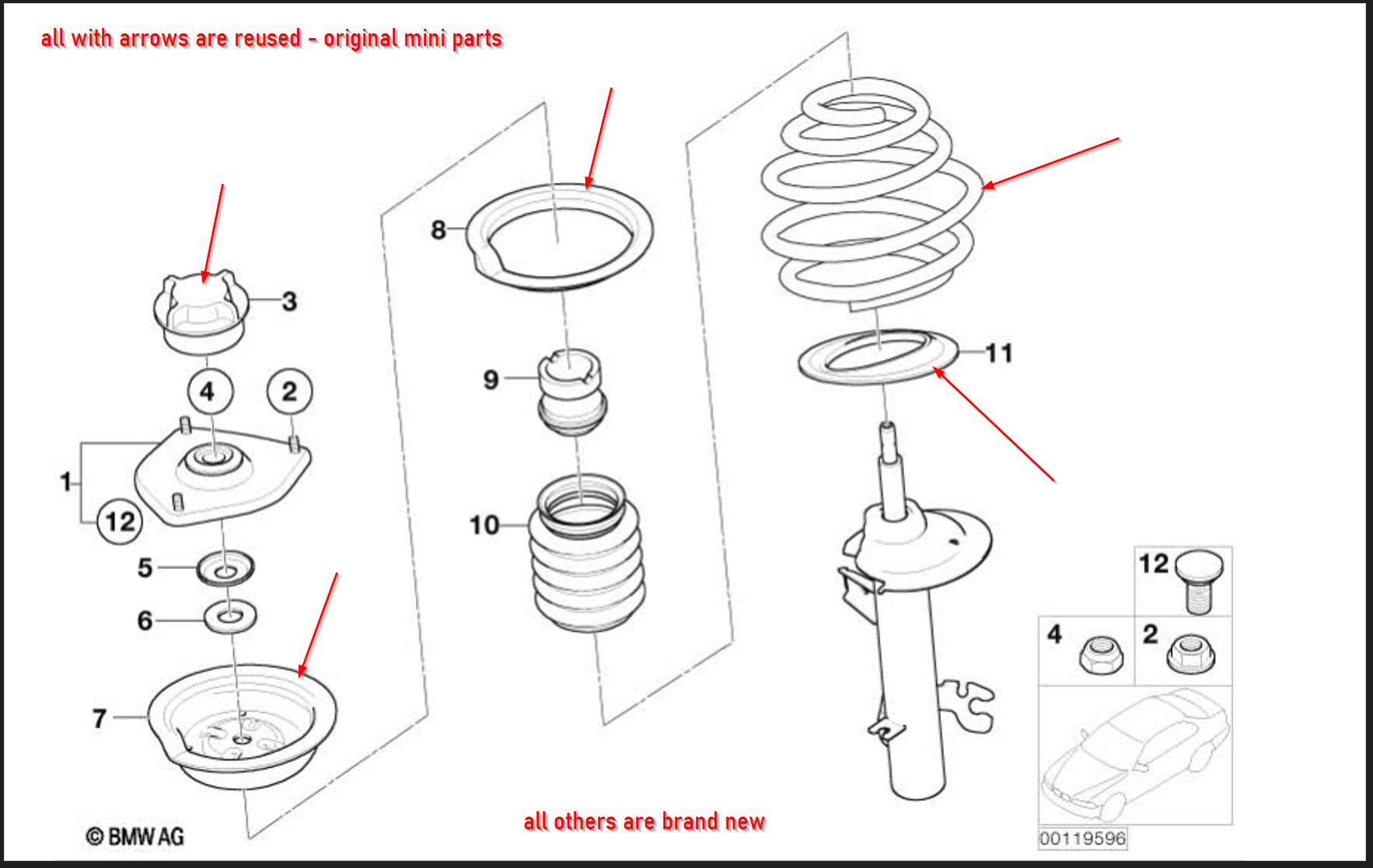

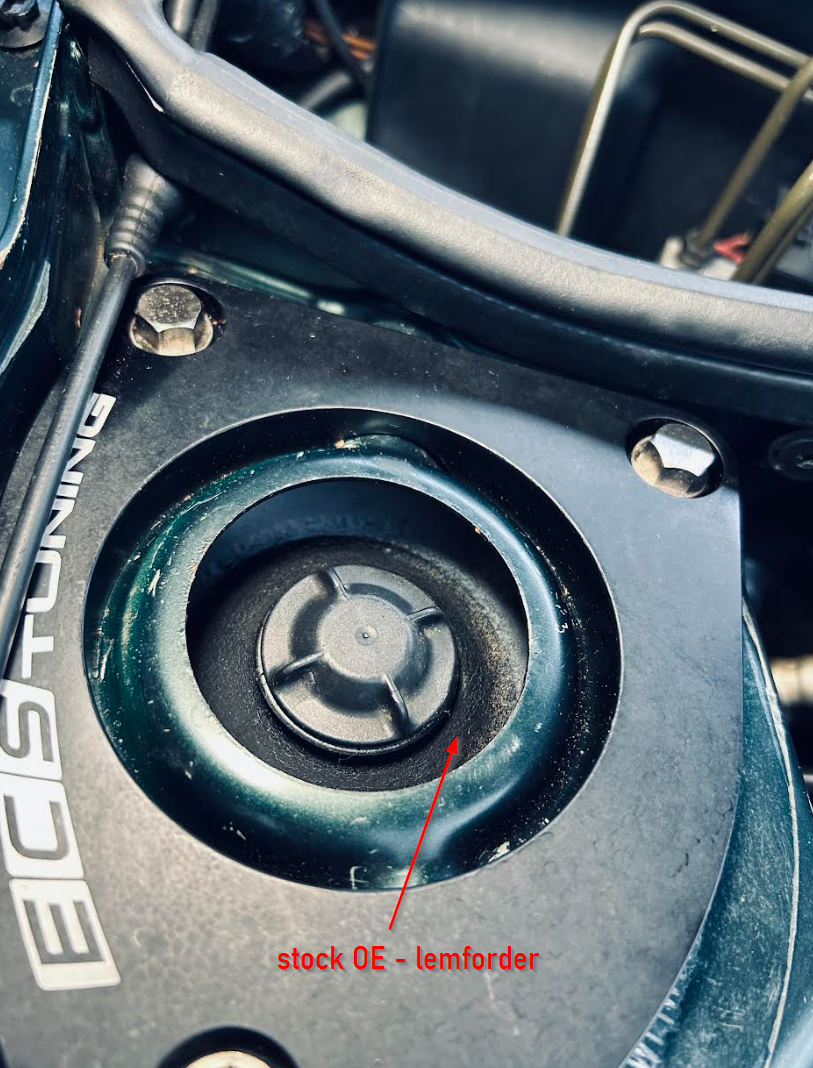

Here man like I said I rebuilt my struts to stock factory using these: ( For now NO mods. ) I just want an R53 all stock.
Bilstein B4 - it includes the nut, for REARS they included bumpstops, no bumpstops in front so I had to buy separate.
Strut Mount - Lemforder
front Bump Stops - URO
Bearing cover - mini
Washer - mini
Dust boot - mini
Ends Links - Lemforder
Pinch Bolt - BMW ( there's no mini available at the time, not sure if this really matters it's 10.9 grade ) - I replaced it. I just don't trust the original bolt that's been there for 20 years.
Anti-Mushroom plates - ECS brand new
Here's what I did, here we go:
For the OE stock Lemforder here's what it looks like, wheels on the ground.
Here the Lemforder mount unlaid looks bulgin a little.
Fully assembled unlaid, all with arrows are reused original MINI parts.All others are brand new.
Here's the assembled one and installed, my OCD attacks whenever I assemble something I want everything clean. Forgive my disk\brake assembly it's ugly but that's for another time.
Installed with wheels on the ground, this is taken today 06/19/2025 so you will see dirt and the uglies.
since there's no way for me to grab the boot and check the distance., then let's go back to my heartbreaking pinch bolt - carrier disaster I still have the original assembly.
Here this is the original MINI part - it's by DELPHI original OEM mini.
and to avoid confusion here... for those english ( unit ) fans and the fanatic metric guys.. I have both.
Hope this helps.

  #44
Mforce's Avatar
Mforce
Joined: Jan 2023
Posts: 189
Likes: 28
Here without the cover. That's the Lemforder mount + Bilstein B4 combo.
Is yours like that?
