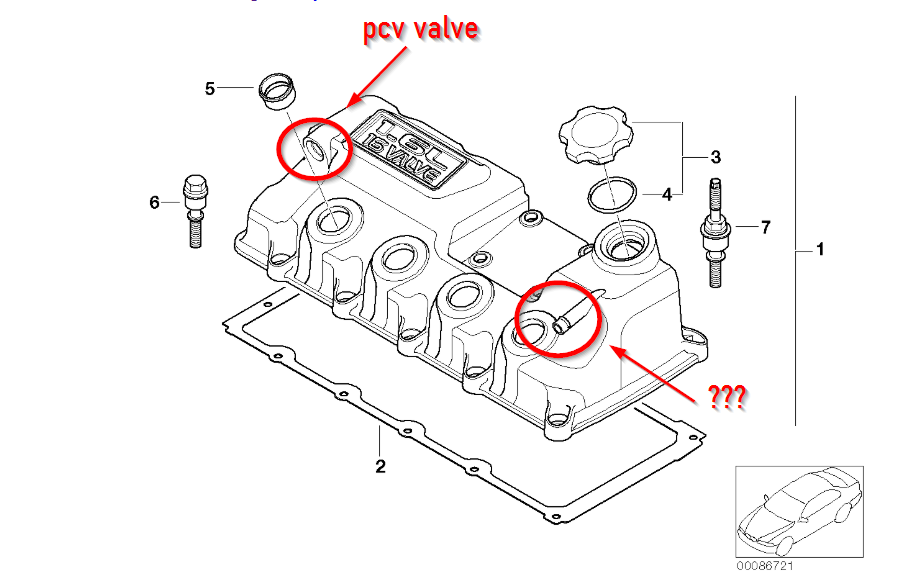

Hello,
Just a quick question, if you are facing the engine from front of the car what is this tube for? another PCV valve? ( on right )?
Please see below. Thnx in advance -- I have a R53 2004

It’s a breather.

Yes, it's another valve cover vent port, the line should run down into the main air intake tube. You can cap the line with a breather filter and close off the inlet on the main air intake to avoid oily pcv residue building up in your intercooler w/o throwing a code.

Deepgrey and WhiskyB,
wait if this is the breather why put in a PCV valve? and when you say breather is it air coming to engine? or coming out?

When the PCV valve is open, it’s a fresh air source for the crankcase. When the PCV valve is closed (high manifold vacuum), it’s effectively a vent outward.
The system goes back to at least the sixties; my van has one. The breather is the oil cap, and there’s a line from the PCV valve to the carb.

Yep. I had added a small cone type filter on that breather outlet and posted a picture of it here on NAM, after installing my Catch can.
I was kindly informed by a credible contributor here, that the Supercharged Mini engine is a and intended as a 'closed system' and furthermore a filter on that outlet only defeats its engineering and is not recommended.
I removed the filter and ran the hose back to original/stock.
