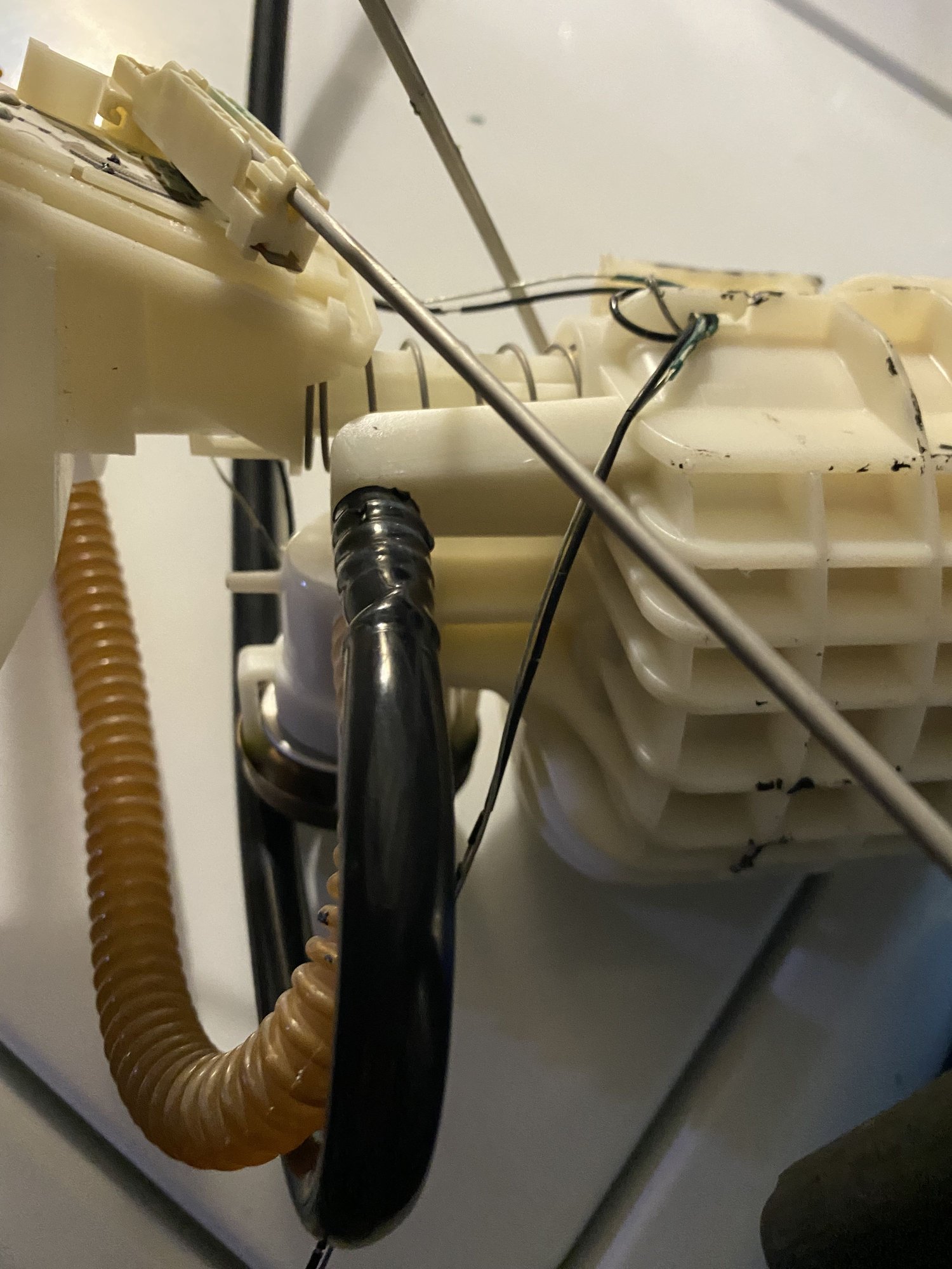

I have added some photos of the pump that came off and the broken hose + peeled wiriing on the pump. My question is, is there an issue with those wires being that way and if they were to touch each other cause some sort of short, spark, fire etc? Second am I able to replace the hose that broke by itself without buying the whole pump? I wanted to reinstall the pump in hopes that it would not start due to the broken hose before shelling out on a new pump. I appreciate any and all help on this issue. Thanks!

Yep pump needs replaced, never saw one that bad with the coating falling off the whole thing.

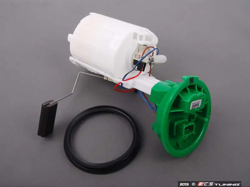

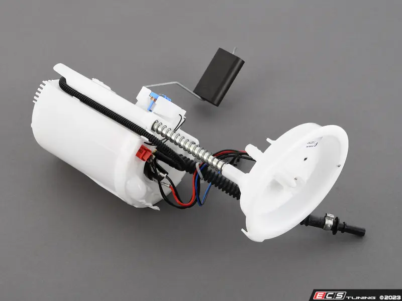

The part on the ECStuning site calles for one that looks closer to mine (green top) https://www.ecstuning.com/b-hamburg-...146765121~ham/.
Was the one you posted just for reference?

Blame that on ethanol. Had same issue a while back. In-tank pump hose brittled & broke.

Those are the ones linked above. Yea seem like ethanol over time must degrade the plastic.
Copied the wrong picture for reference. Green top. Has a white hose that hard to see.

So I just received the new fuel pump and when installing it, the black hose from the fuel filter sending unit to the fuel pump broke!!! I am FURIOUS!!!!!! When fitting it into position it just snapped.
I now have to figure out what to do as that hose appears to be sold together with the filter sending unit everywhere i've looked and cannot find it by itself. I was thinking of putting some sort of adapter fitting to add another piece of hose from there to the pump inlet but IDK if that would work as the hose would need to withstand fuel. Any suggestions?
Here is a photo of the hose that snapped. And also some of the coating on the wires on this sending unit appears to be gone. Im assuming its ben this way as thats how it looked when removed so would it be safe to say nothing should happen if they touch each other while on and running?

Well i bought a new aftermarket off ebay and arrived yesterday. Today I decided to go to they junk yard and get a fuel sending unit and found a 2008 that was clean and had both sending unit and fuel pump (OEM)…Grabbed those 2 for the price of the aftermarket one, installed them today and car started right up. All is good now. Will be returning the aftermarket pump.
