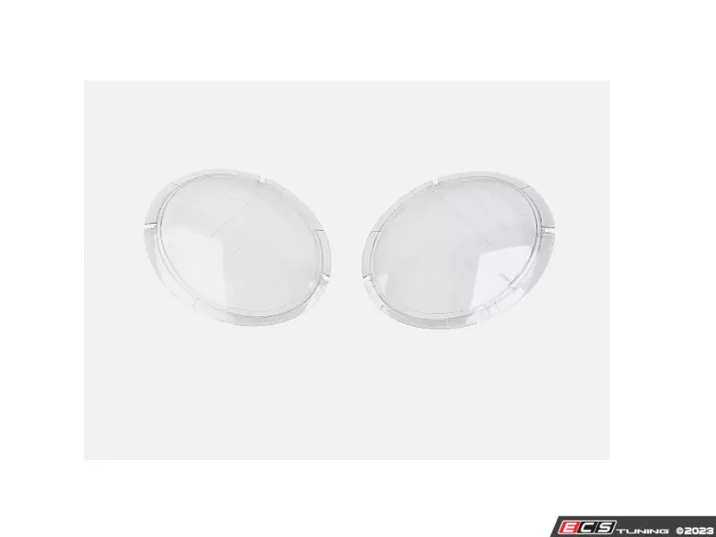

We do have the halogen lenses (dont fit factory Xenon) and trying to work with a supplier to make the Xenon ones for the Gen 1 MINI, No eta yet.
https://www.ecstuning.com/b-bremmen-...adlights-lens/
