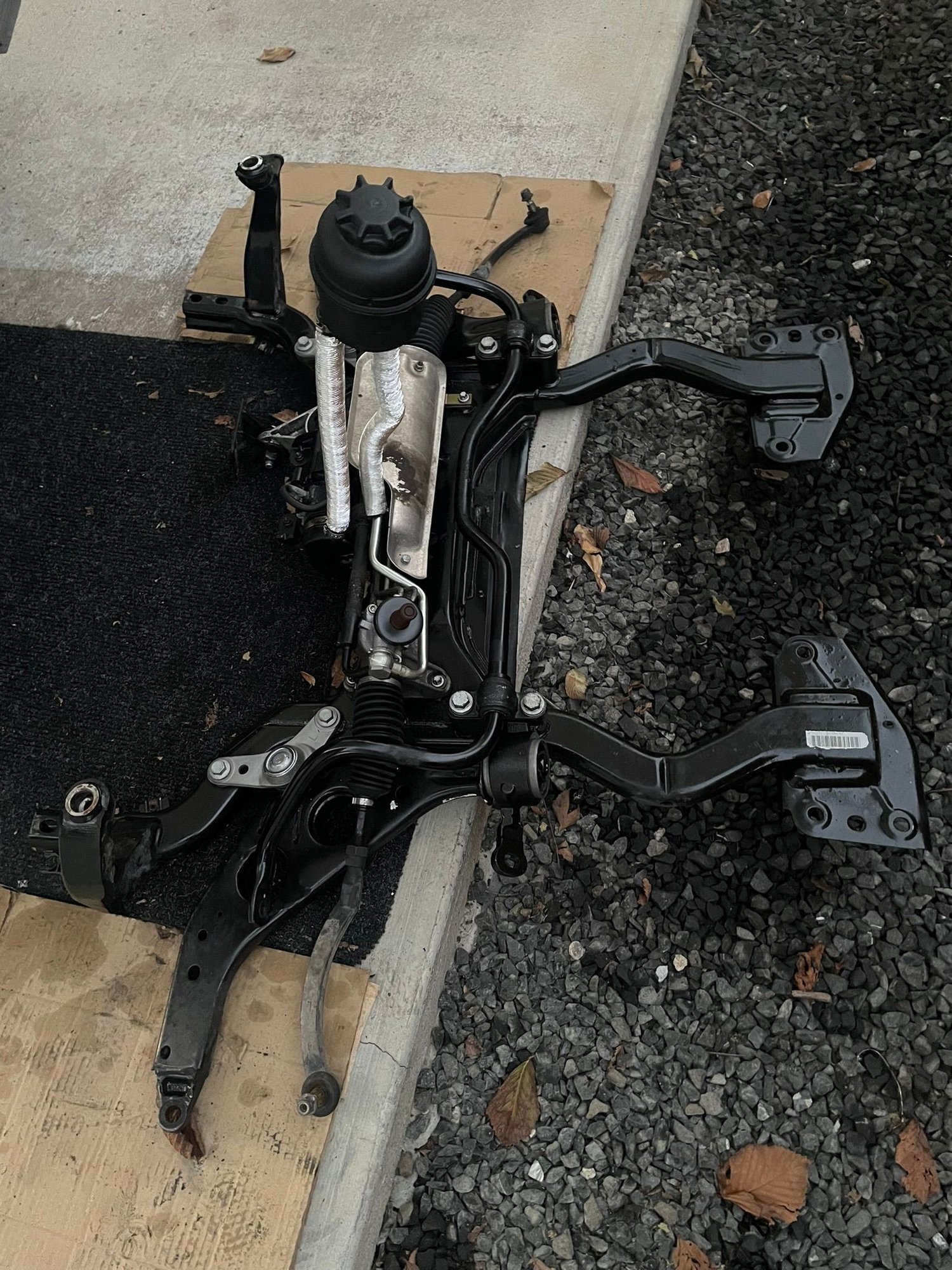

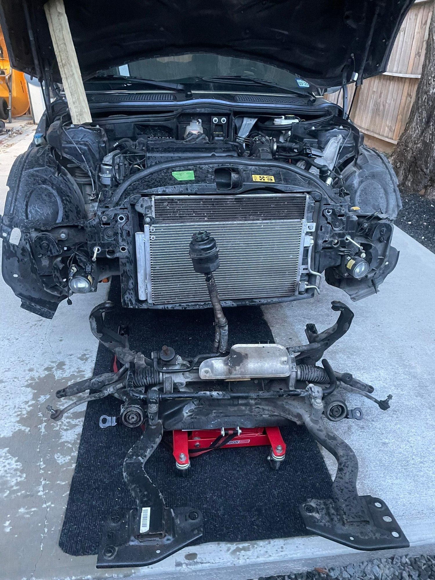

no activity on the clutch replacement yet. i was able to do some work on the subframe while it is out.
-new control arm bushings
-new swaybar bushings
-new inner and outer ball joints
-new power steering hoses and reservoir
-new tie rods (not installed just yet)
Note on the control arm bushings, this (pic attached) assembly lube makes install a breeze. without it, nothing but curs words...

That subframe looks like new! Did you respray it or are you in a rust free state? New seen one that clean here in The Netherlands.

All I did was degreaser and a quick power wash. It was full of grim (power steering leaks)
we are in the south

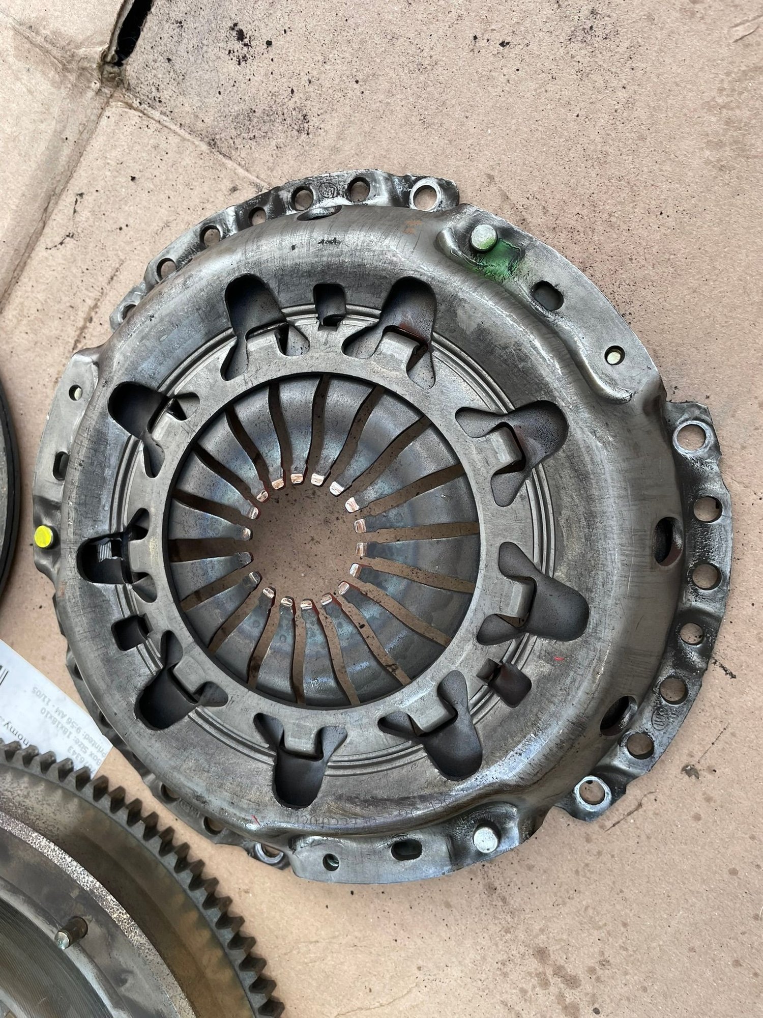

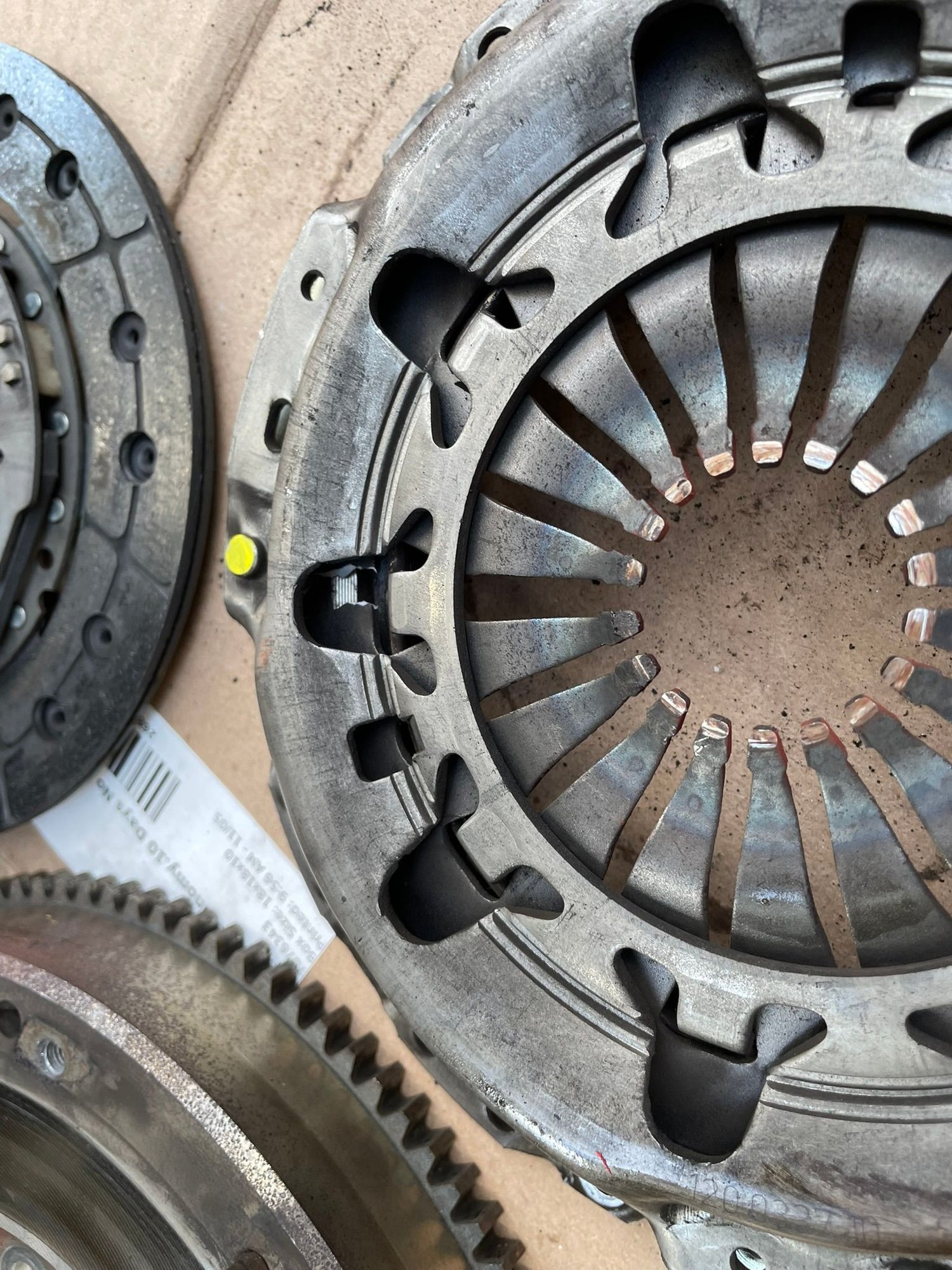

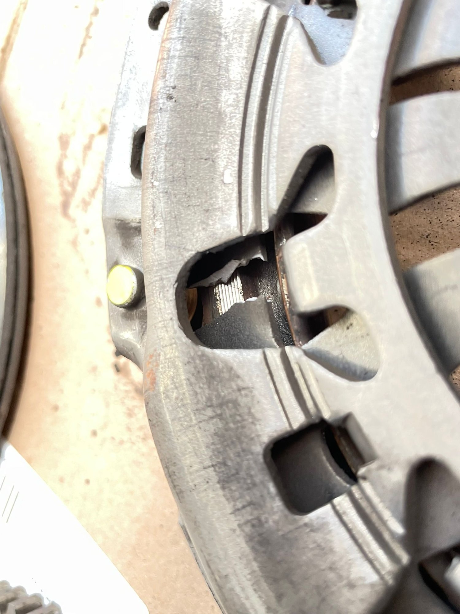

I got the trans out. Looks like it had the stock clutch (Luk) in it. Looked ok at first, was not too worn, but then, on closer inspection, THIS. The pressure plate is broken! Everything else was in order. So mystery solved. I'm going to replace and put everything back together.

Woah that's quite bizar. Glad you found the issue and thanks for sharing. Never seen this before.

yes sir, if it were a bit to the right i would not have seen it. would've been hidden behind the outer shell of the pressure plate
