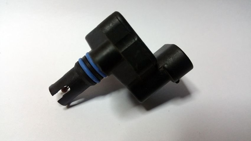

Here is what the old man. sensor looked like.

Did the end of yours (map) look as mangled as mine in the picture?
I haven't noticed any driveablity issues before or after.
No. Not at all.... and the receiving hose was still intact.
I have an '04 R53 - Your Map sensor shows a broken rubber/plastic receiving hose stuck on the MAP sensor.
My original rubber/plastic hose never pulled out when I removed the original MAP sensor.

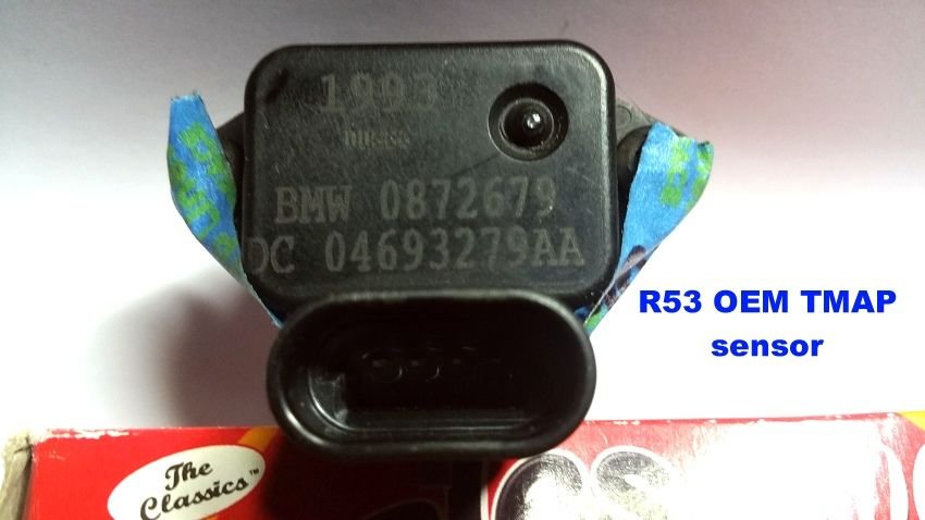

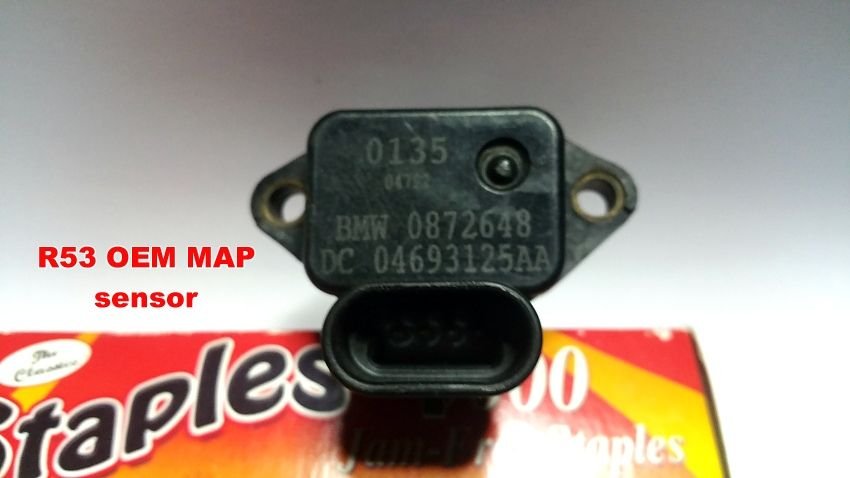

R53 - OEM MAP sensor (0135)_# 0872648
R53 - OEM TMAP sensor (1993)_# 0872679
The images above are of my original factory MAP & TMAP sensors off my 04 R53.
There has been some confusion as to whether these MAP & TMAP sensors are the same/interchangeable - I've learned that they are not.
I've tried to photograph the part numbers so you can compare/reference.

I have an '04 R53 - Your Map sensor (broken) rubber receiving hose looks different than mine.
Mine (rubber hose) has a 90º angle...
R53 - OEM MAP sensor (w/rubber hose still attached)
No mine looked very much like the mangled
It also has me wondering if the (broken) hose that is still attached to the one in your image has anything to do with the problem you are having?
No, the replacement piece and the old BMW piece looked very much alike. Neither of them had any rubber on the ends. When I took out the old sensor I looked down the hole and there appeared that there was a rubber line down there but no way to attach it. Since both sensors looked alike (no rubber) I thought I just needed to screw it down. All the YouTube and info. I looked at didn't mention attaching anything - so now I see mine should be connected via a rubber hose somehow. I don't know if I can grab the hose with a pair of forceps, if there is enough play to pull up to attach the rubber hose to the sensor. Since it obviously broke off that tells me whatever rubber is down there must be in very bad condition (rotting).I don't know how to proceed other than going to my indy to have it fixed, especially taking out the bolt that is stripped.

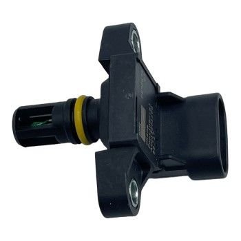

I am confused because my OEM sensor looks different from the ones I see on Amazon.
Look at my picture the area where the sensor is much thicker and it looks like tubing is connected at the small orifice and the second Pic from Amazon is much slimmer.

Well, that's because the receiving end of the MAP sensor line snapped off at the base of your MAP.
That plastic/rubber that you see on the "shaft" of your MAP sensor shouldn't be there. It's not part of the MAP sensor. It is the end of the broken vacuum line that got stuck on there when you tried to remove the sensor.
Put a pair of pliers around it and gently twist it off from the MAP sensor. See pic:
This is the line you need to replace:
Image taken from WayMotorWorks website. Price is listed at $27.95.

Yes that is the map tube broken off on the map sensor

Okay, I understand now what I'm seeing in these photos and why mine seemed so different when it wasn't.
