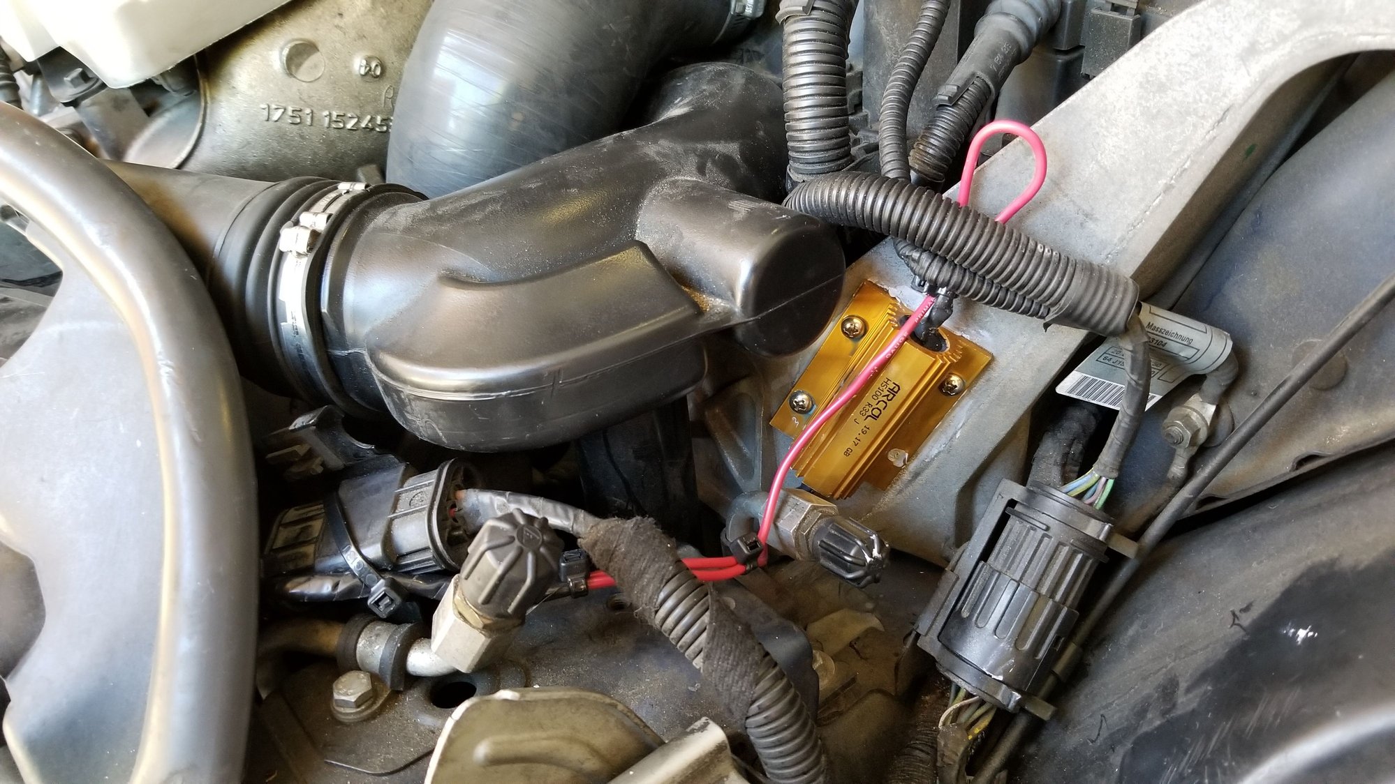

When my 1st stage fan stopped working I also checked the fuses and the large green relays (?) and was a little confused as to which fuse was actually associated with the low speed fan.
I ended up performing the100W 0.33 OHM resistor bypass mod instead. I also had no idea that the 5 amp fuse had anything to do with the low speed as it was labeled "engine".

HereYaGo - Bypass Low speed fan resistor fix discussion thread - post #867 shows an image of the wiring mod. but you may want to skim through the previous comments to have a better idea of how this mod came about
Here's a link to the Mouser HS100 R33 J / 100W 0.33 OHM 5% resistor (I myself) and others have often used.

Did the Mouser mod on my '04 JCW about 8 years ago and have had no issues ever since!
