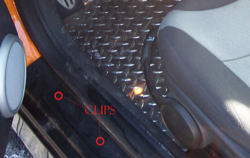

recently i have removed all flares and rockers. Rockers are by far the hardest.
here is how to remove these while keeping most clips
Rockers
3 sets of clips on the rockers
1. under the sill, You WILL need to remove the sil to get them off and back in. Once the sill is off, pop then up 1/8 inch then turn 90 degrees, then pull up the rest of the way.
2. on the bottom, there are the common screw/anchor. they just screw out and the anchors then pull out
3. the clips on the side, these i dont know how to save, and dont know if there even is a way. I just pulled mine and they all broke, doesnt damage the rockers, so...its like a $5 job for all those broken clips.
the most tedious part of doing this is removing the sil. Take your time because its rather thin and will bend if you PULL it off, and theyre like $50 each. A paint scraper would probably be your best bet. Then of course, they need to be re-adhered.
Another thing to keep in mind is wether you are actually painting the entire rocker, even inside the car where the sil is. I dont know if you want to paint that, you will be steping on it an aweful lot.
Front Flares
open the hood, from here, you can see all of the clips and how they are to be removed. there is one nut/screw and several grey actual CLIPS, they ALL come off, just be gentle cause they are brittle. If they do break, dont worry, a quarter each or something.
Rear flares.
just pull these off. The back clips just pop off and pop back on, no loss here
