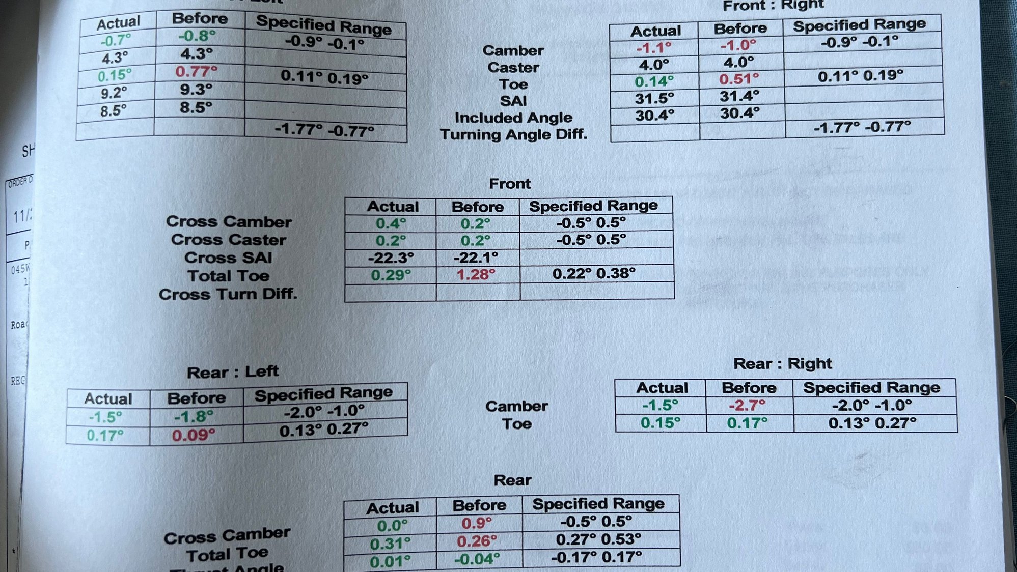

Originally Posted by Zsm
Hi @OutlandishnessDue , here's the alignment specs for my kid's MINI R53 with Hotchkis lowering springs and adjustable rear control arms. Sits about .75 / 19mm lower than stock. The anomaly on the right front corner is due to a mushroomed strut tower. We banged it back down a little more so next time we align it, the specs will be closer to the left side.
Before the alignment, the previous set of tires wore out in less than 10K. That front toe setting killed the tires quick. Now with over 12K post alignment, tire wear is down to 5/32 on Conti DWS06 plus (205/45-17)

@Zsm much obliged!
