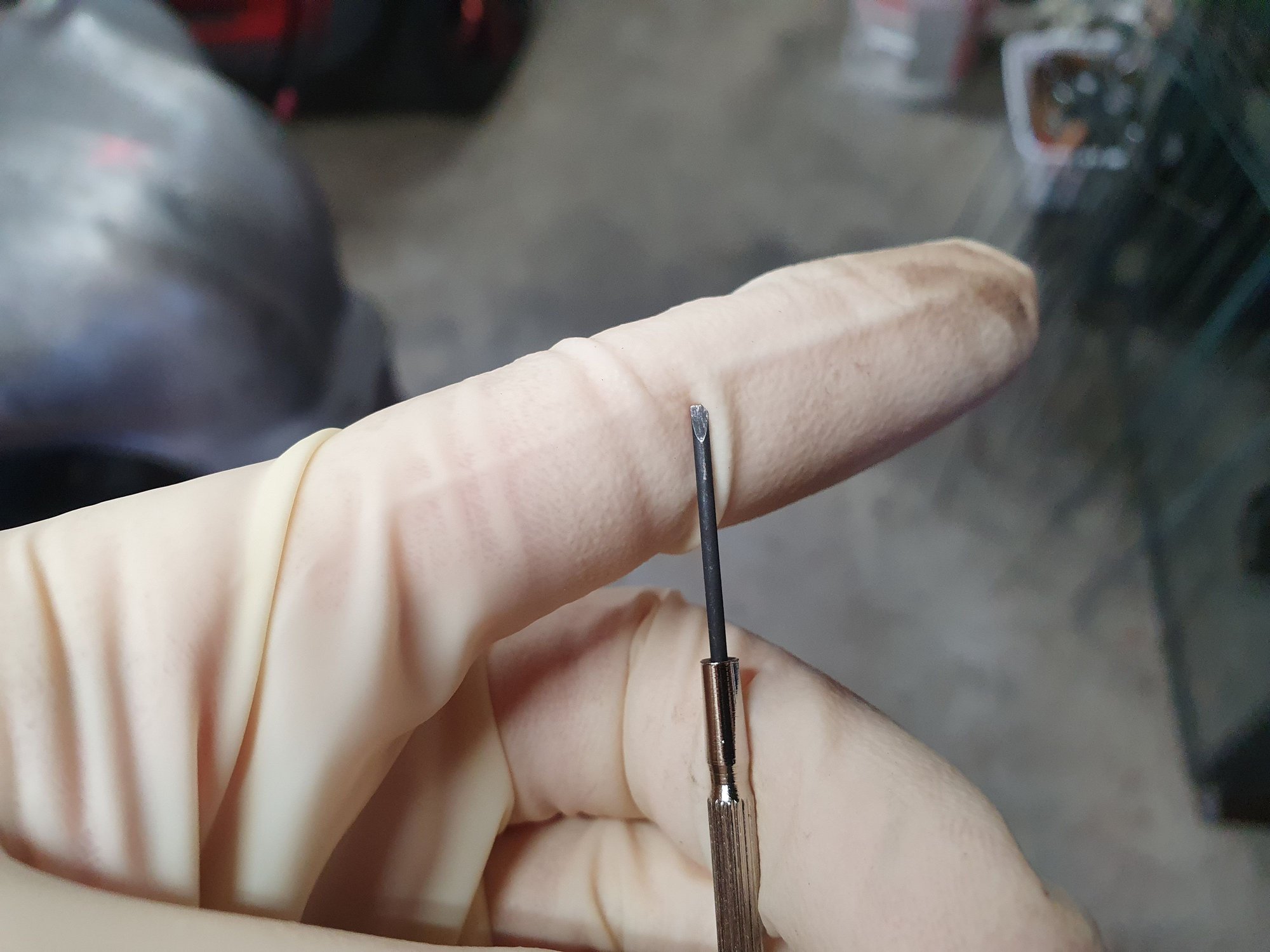

I went with a new K Series tucked engine harness from Jackspania racing. Looks to be pretty nice quality but I did run into one issue. The Crankshaft position sensor didn't want to plug in correctly and upon further research, there are two main types of K Series CPS's. One for K24s and one for K20s.
K24 plug on the left, K20 plug on the right that came with jackspania harness. The locating slides on the sides of the connector are different. K20 being right in the middle and K24 being lower set.
Not a huge setback but with the connection being different it needed to be fixed and if any of you run into this issue hopefully this will help. Before you start be sure to note which order the wires are in on the harness you are putting on the car. In my case the jackspania harness wires aren't the same color as the Honda harness wires.
You'll have to first remove the connector lock. Just use a pick and pull out with it. Should come off easily enough.
Then use something to unclip each pin from the connector. I have an eye glass screwdriver set and it made quick work of it.
You will have to depin the connector to replace it with the correct one for your engines CPS. Also the wire arrangement isn't the same from K20 to K24.
Once you have the wires rearranged and back into the connector. Just put the pin lock back in.
Once it's all back together it clips in like it should. Not too big of a fuss but something to look out for.
For more info on this I'll post the link from Hybrid Racing that I used to put the K24 plug onto the engine harness. I just used the old CPS connector from the harness that came with the engine.
Not sure if it was a mistake I made when ordering or not but regardless it was a problem I ran into. Cheers.
