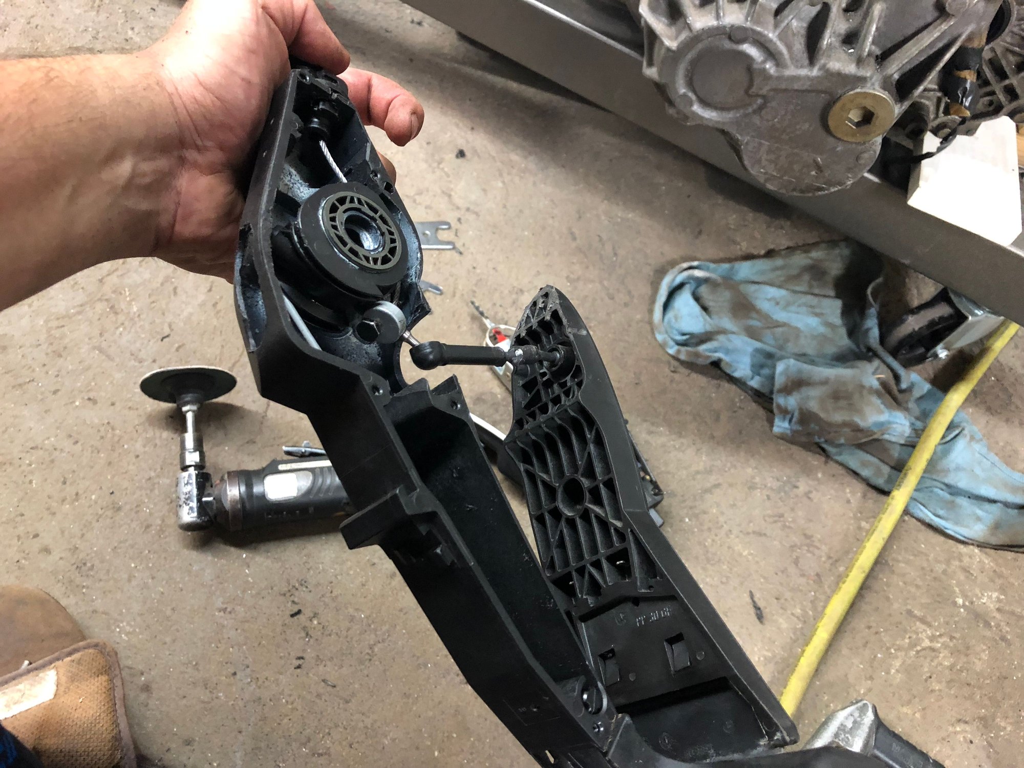

Today I spent the day modifying the honda throttle cable and the throttle pedal. I wanted to use the s2000 pedal but I figured out a way to use the stock mini one. Not much modification to the cable itself. Just had to drill one hole into it. The pedal box had to be shaved inside a couple places.
