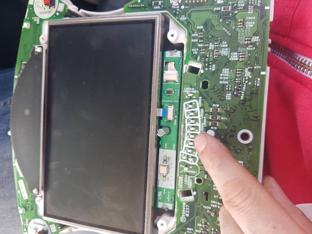

Here is one disassembled. It look like you could take out just the screen... and I think there might be a window on the cover.

Is part#3 just a bezel or does it incorporate the non glare screen protector?
Old Mar 8, 2024 | 09:34 AM
scubus's Avatar
scubus
Joined: Mar 2016
Posts: 353
Likes: 53
It looks like just a bezel. As soon as my hip feels up to it I'm going to go pull the unit out of the car to get a better look.... I just had a hip replaced Tuesday so I'm not sure I feel up to taking anything apart just now
