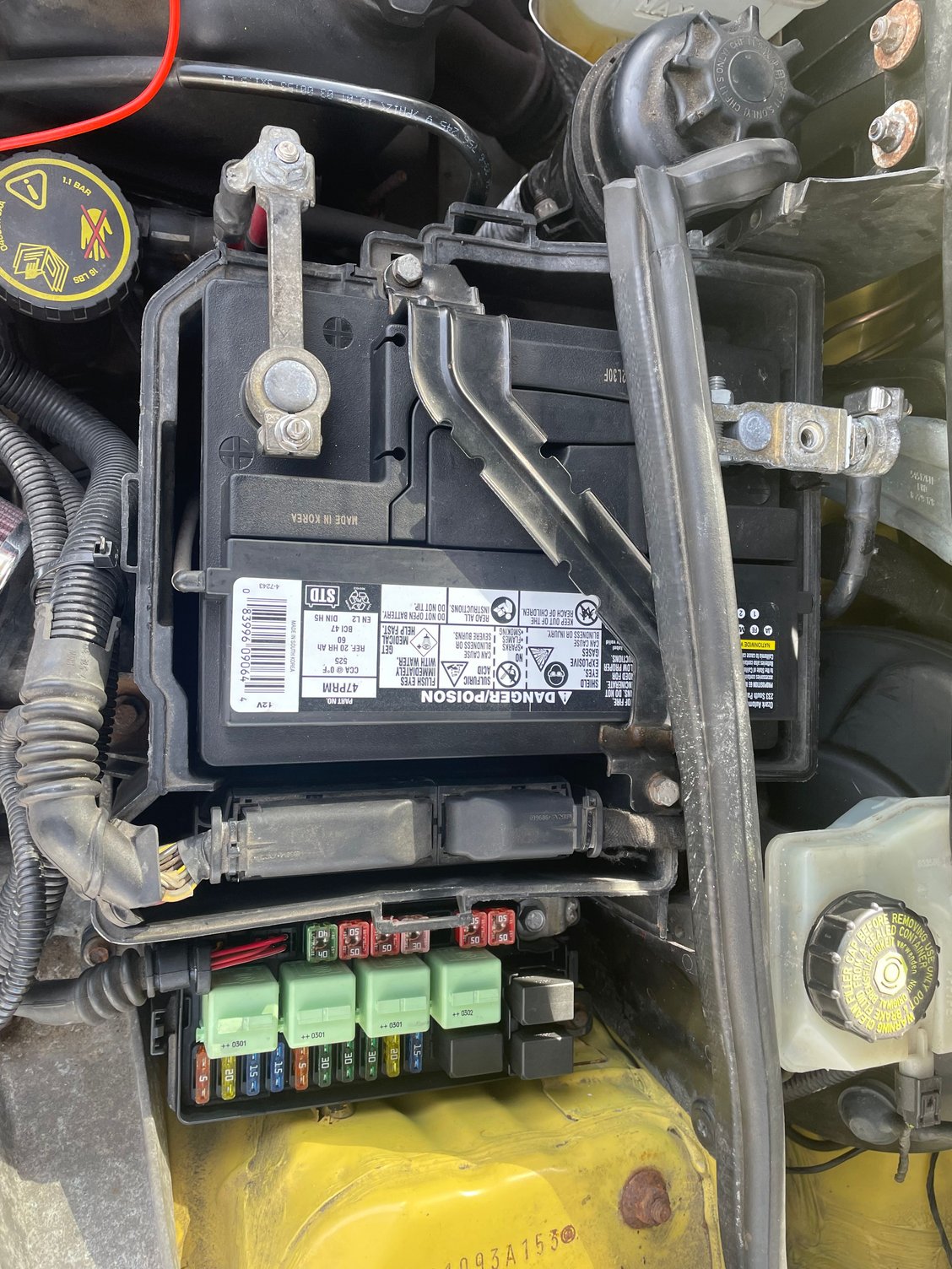

So I pulled the 2 additional relays (I think there’s just those that I was missing) on the interior panel and that did nothing. I also disconnected the cable that’s bolted onto the positive terminal connection and that drops the drain about .3 amps (from 1.6 to 1.3). I believe that’s connected to the fuse box battery connection (which you can see in the picture) because disconnecting that side does the same thing and when they are both disconnected there’s no change.
Assuming what I disconnected is not the alternator wire but the fuse box, I can’t seem to find a wire that’s semi easy to access near the battery/air filter. Does anyone have a diagram/visual for this?
