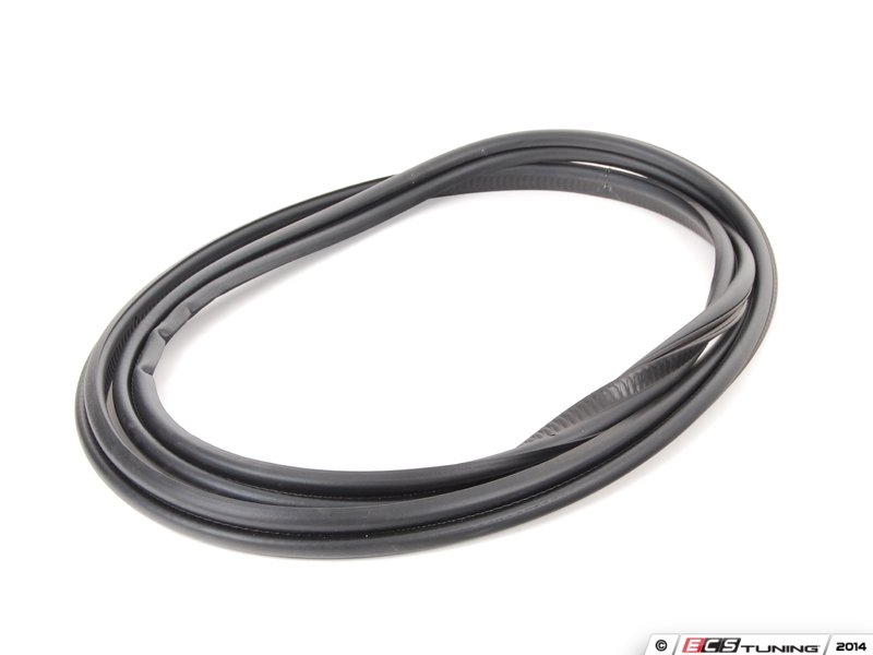

This is the main seal: Its like 160ish right now.
https://www.ecstuning.com/b-genuine-...t/51717132471/
Is the trunk lid grip handle seal leaking or do you have a sunroof with drain tubes that leak/clogged?
