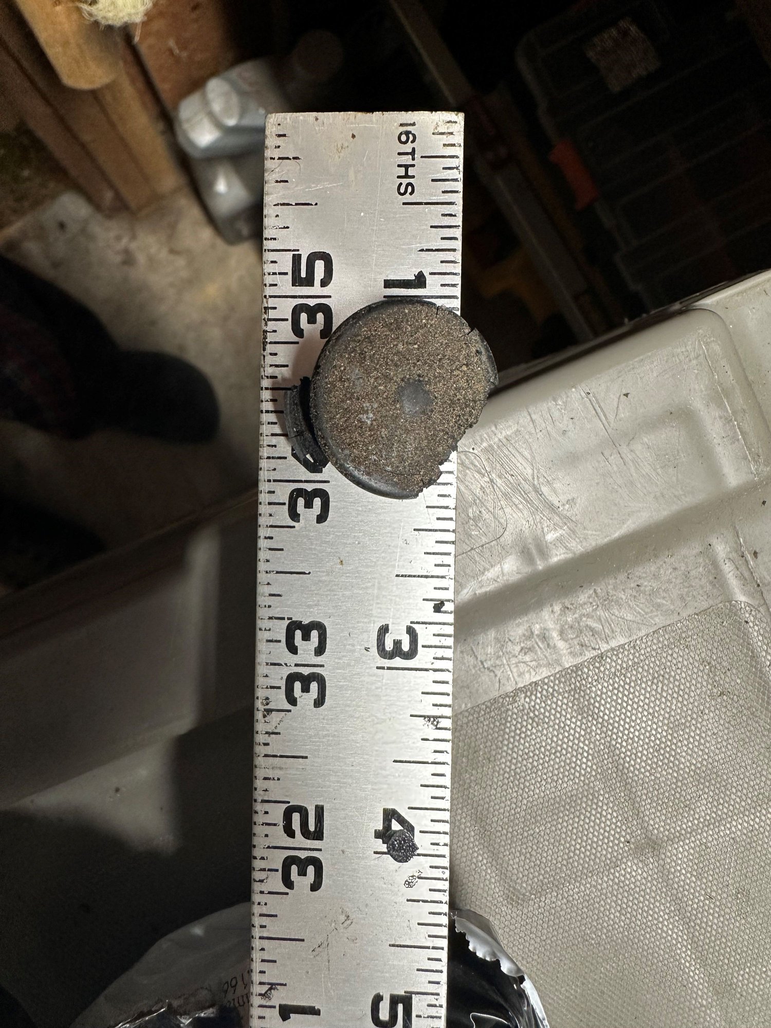

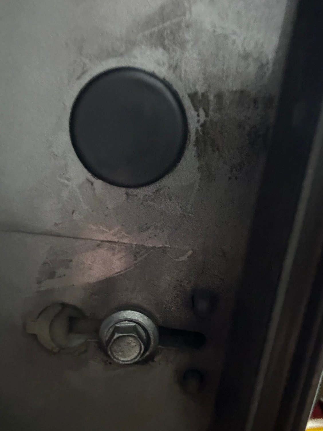

I was working on the inside door of my Mini when I saw these "plugs" in the bottom on the door, inside. Its falling apart and there are two of them in the bottom of the door. When I pulled it out it kind of crumbled in my hands. It is a soft rubber not plastic. Are these needed to keep moisture and dirt out? I cant find the part number anywhere. Will a strong plastic tape do the same thing? Any insight is appreciated.
This side faces up in side the door
This is the side that faces down toward the ground

Looks like maybe 31mm?
Here is 25mm
https://www.ecstuning.com/b-genuine-...h/51718126605/
Lots of various ones here: https://www.realoem.com/bmw/enUS/sho...diagId=51_5496

How about a photo of where it came from...

Just got an Amazon kit. The hole size is 25.4mm. The new plugs are more like rubber vs the old plastic plugs. Worked perfect.

I think it is Part Number: 51718126605, Blind plug (D=25MM)
