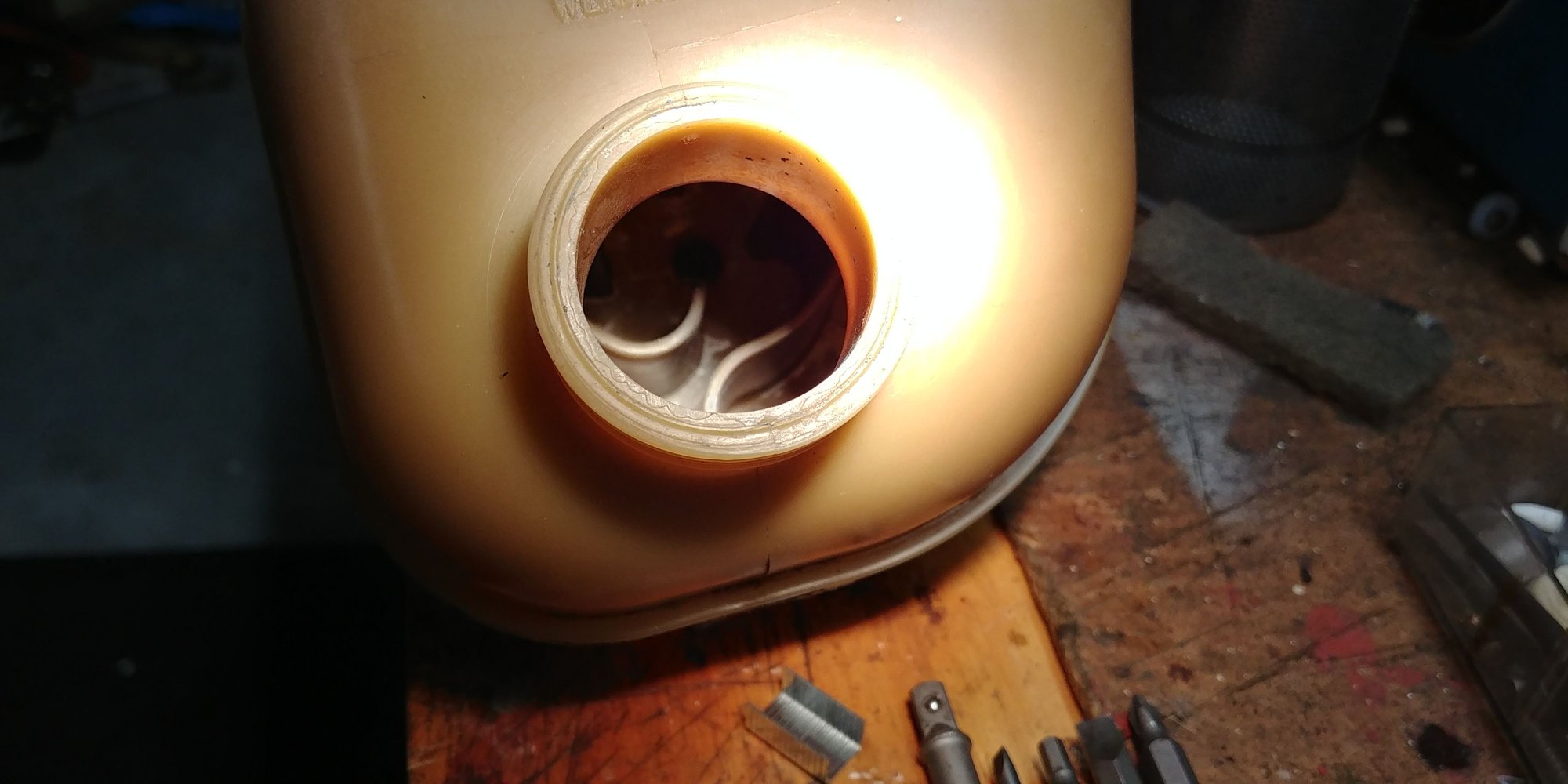

Andy-One other thing...You mention that the reservoir level is at "MAX". The correct level should be where the coolant is just at the level of those "S" molded configurations in the bottom of the tank. There's a possibility that the system is just "puking" the excess until it gets to the correct level. Use a turkey baster to remove the excess and see if the leaking stops.

Stan - You have a picture where the correct level should be? Are you still using the molded plastic OE tank on your GP, or have you switched over to the tank that WAY sells?

Andy, I'm running a CANTON on the GP but I just took a pic of the original recovery tank that shows the ribs inside. I have found that the coolant should be level with the top of those ribs, no higher.

Stan -
Thank you for the pic, good to know that you can only see the ribs from inside the tank. I will remove some fluid and see if that changes things, especially give I'm at the MAX level, it must have been even higher than that before. If this resolves my issues, I'm moving to the Canton tank as well. I'll keep you posted.
