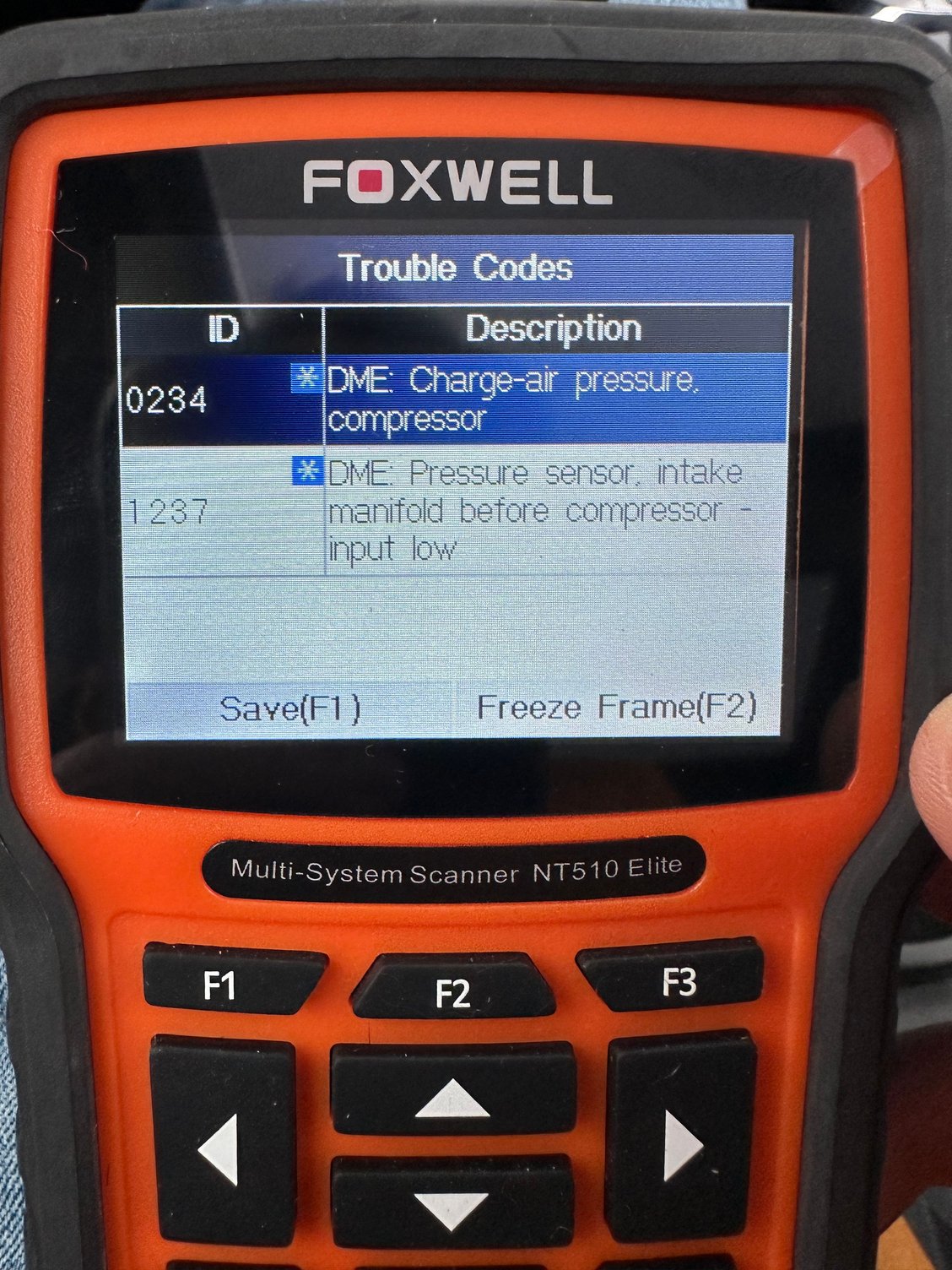

I have a couple codes in the mini, P0234 and P1237 that I think will get fix by switching the Manifold MAP and TMAP sensors.

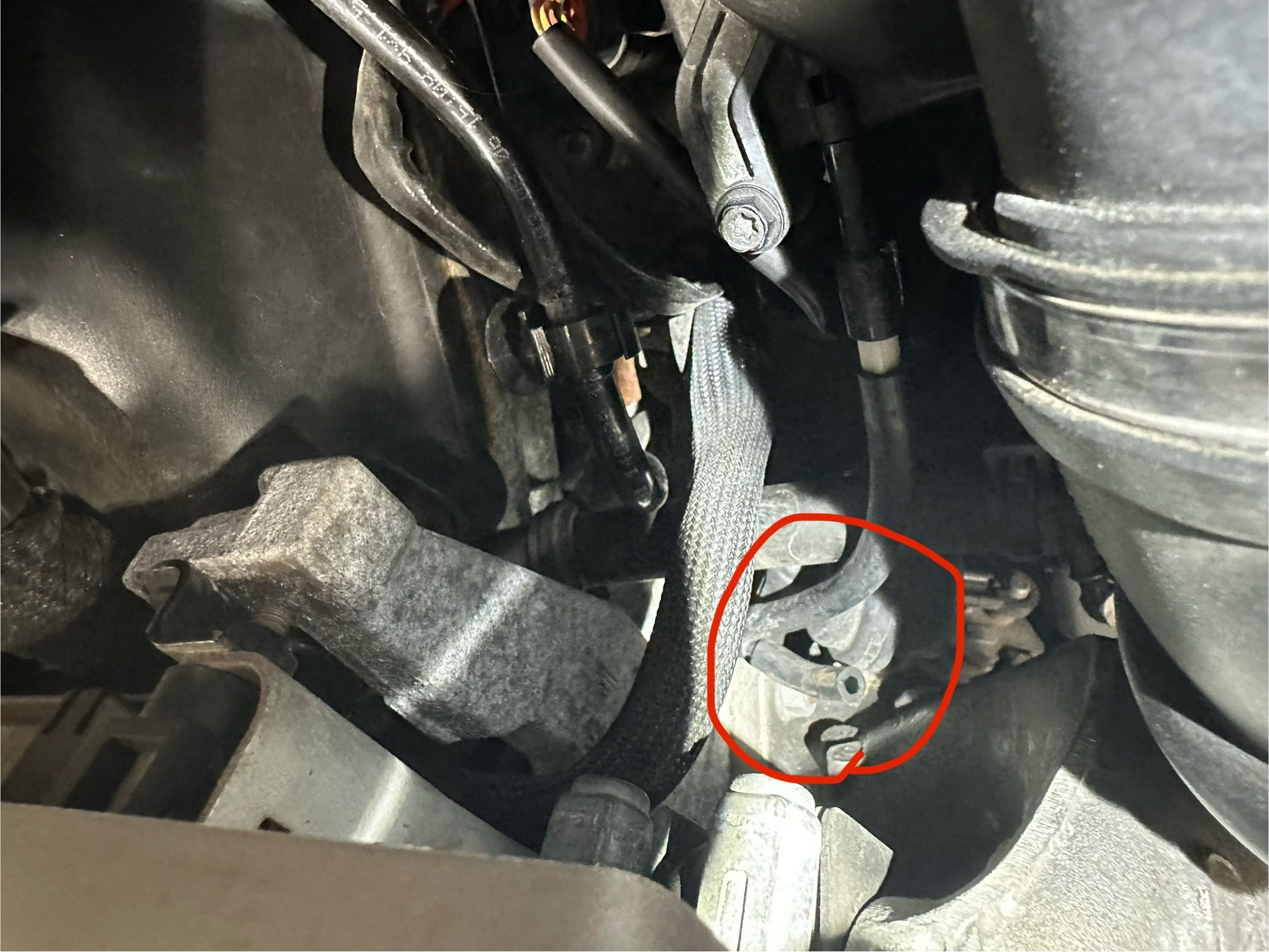

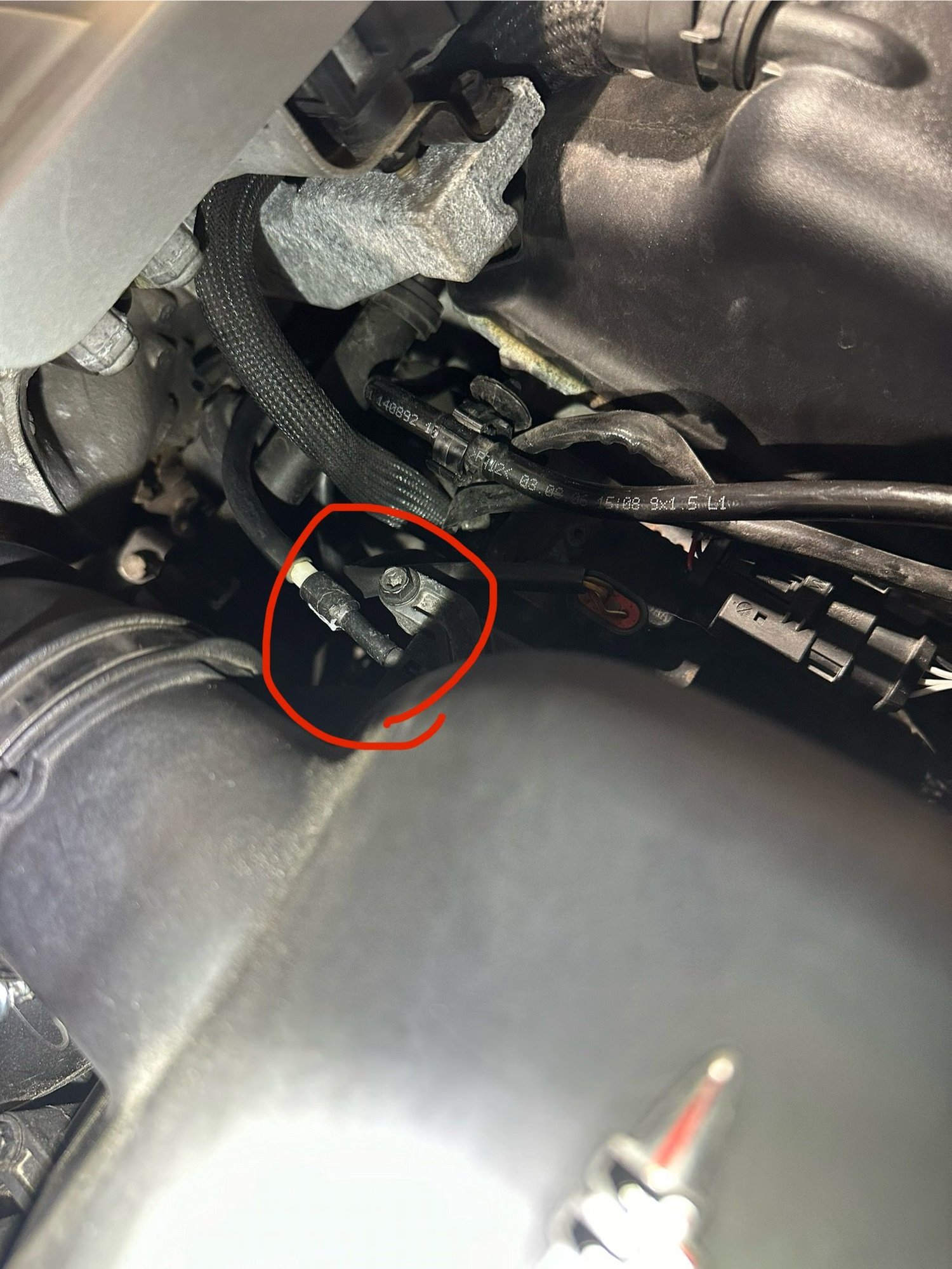

I was about to do that and I found that the line that comes from the airbox one portion is connected, but one seems like it’s Brocken? Is like a Y; If so, where does that line connects to, since I can’t find where it goes.
I posted the images of the line as best as I could.

Apparently you have the JCW intake, so the T connection splits the line so it can go to the bypass valve.
It's hard to tell in the pics, but I'm betting that's where the connection should be made.
Correct this and it will likely fix your codes.
Thanks for the reply
yes, I have the JCW intake (came like this)
so, one goes in to someplace in the engine, and the other one goes to the bypass valve?
That’s the hose I need?
(really new to trying to fix things, so explanation with apples and oranges is greatly appreciated)
have a great day!!
I connected the line, cleared the code and so far has not come back!!!

This information was really helpful, after looking at item, found where that line needed to go, connected and codes are gone so far!!!
