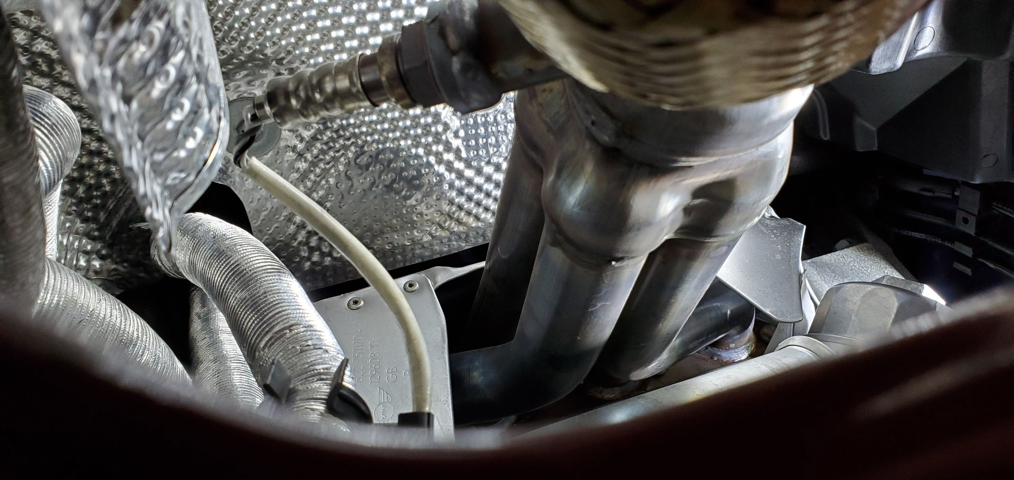

You have to build a tomcat or test pipe to connect XForce obx suspersprint to factory catback. They are not bolt in on the bottom end.
that’s why mine is still in the box over a year later. But yes, I’d rather. 421 than 41 header. The only other option is scorpion but they are money. Money since you have to buy them with cat in the US.
the factory system is a 4-1 header, only big difference to most 4-1 is the shortness of the runners because of the precat.

"As far as 4-1 vs. 4-2-1, the RMW shorty header (with cat) and their race header are widely acknowledged to be among the best performers on a R53 Mini, and both are 4 into 1 designs."
+1! The RMW Shorty V.2 header with GESI cat is excellent and throws no codes.
