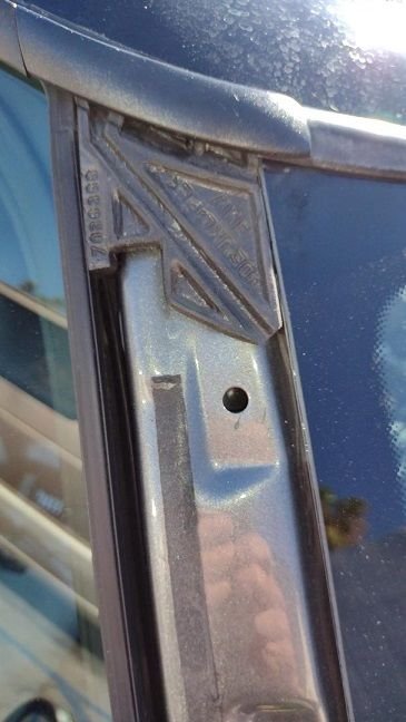

Yes- much more comfortable here in Redondo. 60* mornings and 70* days never get boring. I've been living on a boat for years ! I couldn't resit and just had to pull the A pillar trim off. This trim is the old design 51137073472. I was surprised there was no long foam gasket behind it. One foam piece at the top corner (see photo) Then a 1/2" x 1/4" piece of weather stripping on both the plastic trim and frame. I can’t fathom how the trim got so distorted without heat. The top is bent as well as the leading edge. It will never be the same. The long foam panel/piece is shown for the 2003 model year @realoem. I assume I should order one of them even though it is not on this car.
Has anyone seen a pillar trim installation w/o the long foam gasket ? Could there be a reason the dealer did this during the windshield replacemnt ? Pelican auto is just down the road 20 miles and has the trim, gasket and clips so I'll make the trip soon. Is this the correct clip to order ? https://tinyurl.com/ycxwx5k3

Yes - Those are the correct retaining "button" clips for the exterior A pillar trim. A nice little bonus; as those pictured even have the little "O" rubber gaskets with them.
​​​​​​My 04 R53 (build date 10.'03) did have the original full size/ large pillar gasket as well.
