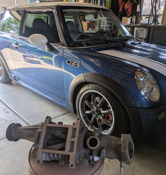

I decided to have a go with an Eaton M62 off a Cobalt SS, along with all the fabrication needed to make things work. My mini runs beautifully, so I'll enjoy summertime behind the wheel and this will likely be a fall project as the season wraps up. This mod has gained a lot of traction in the UK, but if anyone still active at NAM taken this on, please let me know! Whether this works out for me or not, I'll keep folks informed on my progress.
