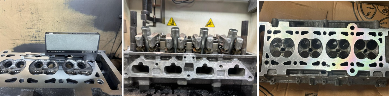

Some updates on my cylinder head. Going with a port and polished upgrade complements of @MiniManAdam. In a few places you'll see very minor rougher porting that I added (and will soon polish) from 80 grit on a dremel to get tenth of a millimeter precision across them all. All in all the channels are almost exacly a third bigger on the intake side and 16% larger on the exhaust (compared to the JCW which I read is 12% on the exhaust only), which should really open up the flow. Plus I have a ported intake manifold and supercharger + horns to install, and a Newman street cam as well! Here's some photos of the intake, then exhaust. For comparison, most of the outlined parts seen around the ports on my original head has been removed.
My emissions inspection is due next month and I've never rebuilt a head. So I finally broke down and took something out for a rebuild. The machine shop noticed the lifter caps needed replacing which I may have missed, and have those coming for just $5 a piece from Detroit Tuned. All in all, with me wanting this done right - plus this assures everything properly pressure checked and leveled, I'm glad this part is in the hands of an expert.

Took them forever to get to it, but the head looks great and the new cam is installed. I need to match the gaskets to the enlarged ports, then back on the block. From there, it's reinstall everything that can go on the motor before installation, then finally back on the vehicle. SO ready to get back on the road. Hope to share some real progress later this week!

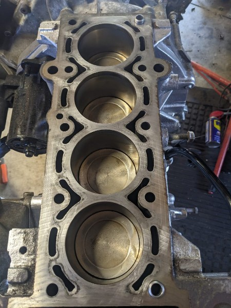

Block deck throughly prepped and cleaned (WD40 and scotch bright pads are amazing) and the cylinder walls and pistons look fine:
Head reinstalled on the car with new seals and gaskets and an aluminium thermostat housing. Thanks again to the magic of a Bentley manual + Mod Mini videos in making things easy:

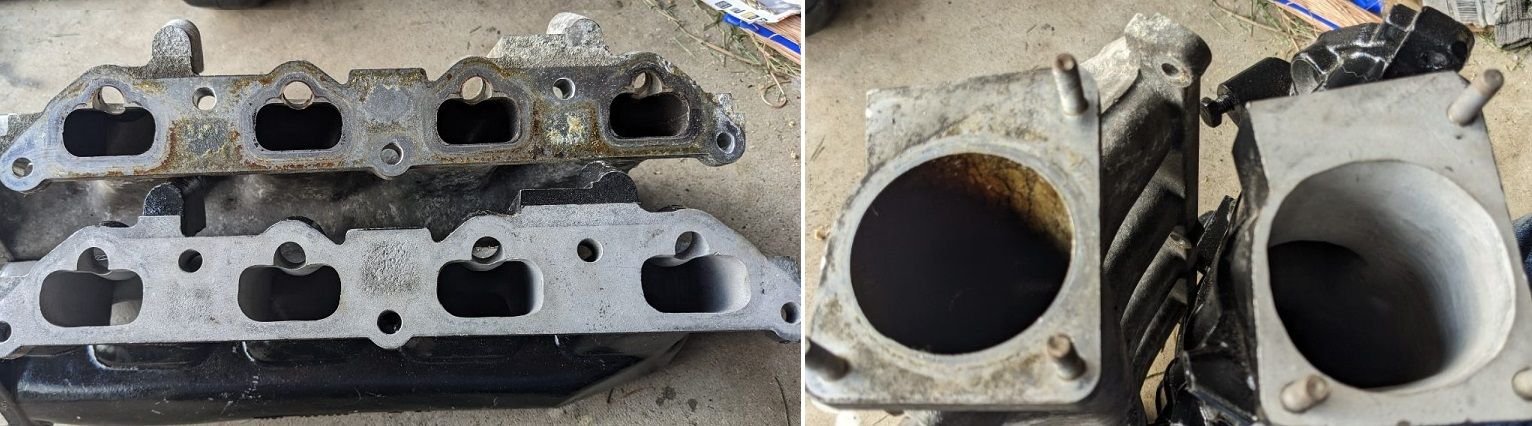

Ported and rebuilt supercharger ready to install! 15% larger on the lnlet side. A cleaned up and smoothed before and after on the outlet is picture as well (same done to the corresponding downtube from intercooler to the intake manifold):
And ported intake. This I just installed! Both inlet and outlet size on this is increased by roughly 10%. This (along with a machined gasket) matches the enlarged ports on the head:
Expecting some big gains with all this increased flow. But now I'm concerned the bottle neck is my boost tube and throttle body. I may look into that but at the same time, I'm SOOO ready to get this car going.
