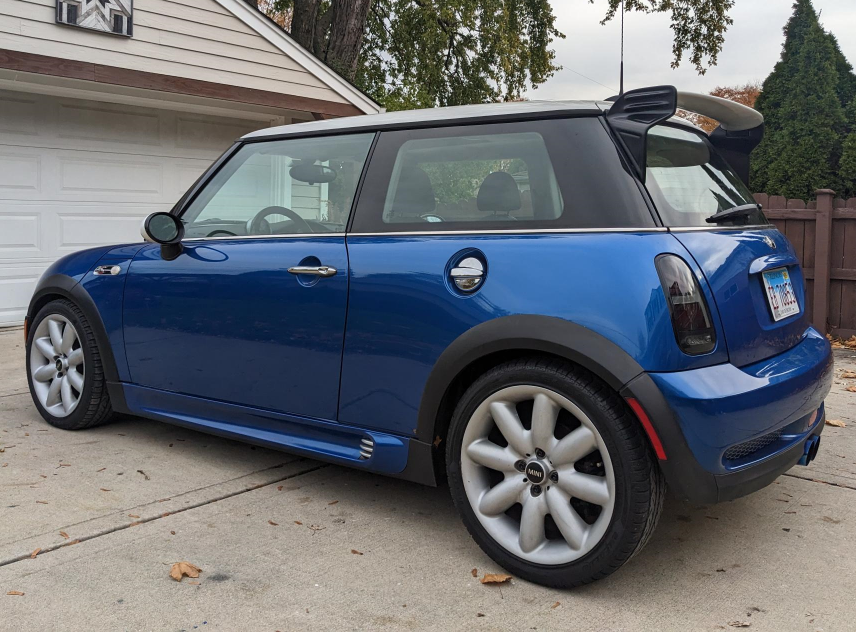

It's been a while but I've been busy on the Mini! With the weather so unseasonably nice I started with paint and bodywork before going in the motor. I managed to remove/repair nearly every scratch and took the aged clearcoat to a showroom smooth finish with high grit wet sanding, polish, and wax. I added cowl scoops for a soon-to-be cold air intake and R56 aero side skirts. Finally, added sweet union jack taillights and painted the chrome hatch handle body color, as it didn't go with the new look. Here are some pics!
Putting my pint of PPG to good use. Besides skirt inserts and the hatch handle, the cowl scoops came glossy black and didn't match at all:
Finished product! Wasn't sure whether to go with black or chrome fins for skirts but happy with my choice. I have a GP style spoiler coming and that'll be it for the body.
Beyond the taillights, I also bought fake grill stickers for the bumper off Etsy and IMO they actually look really nice. They were glossy and reflective, accentuating their "fake-ness", but I covered them with a matte clearcoat that both protects them better and makes all the difference:

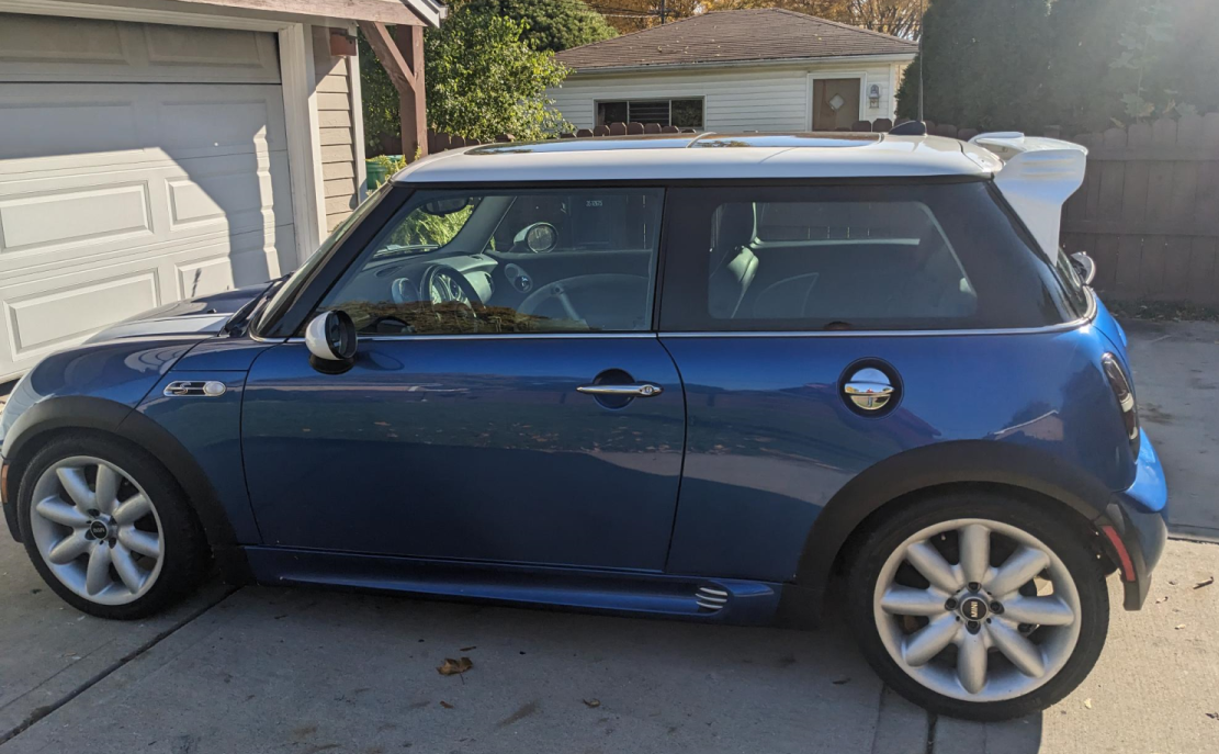

Alright friends - I have a decision to make. I ordered that GP spoiler and spent the weekend painting the thing to match, getting the factory wing unstuck from the strongest double sided tape ever invented, and working with the tabs and some heat to clear the hatch of my car (fitment wasn't great and it took some work). Now that it's done, I'm not sure its the look I want to go for. I really didn't like it in black but throught the repaint to roof color would help. With sleeper in mind I may go back to the factory spoiler which IMO looks pretty good. Regardless, here's what I came up with - thoughts welcome... And one final thought - what if I painted the sides hyper blue and left the wing in white?

I really dig the wing, and all the exterior mods, but sadly it does not scream sleeper. It draws attention. (at least to me it does)
If you want sleeper, the stock wing and less fancy outsides are in order. Take a look at my car that is basically all stock appearing - (and dirty too). This is more sleeper IMO. That said, I've been thinking about adding the wing as it adds a little more aggressive appearance to the car. Either way, I really dig what you've done so far!

I used SEM trim black in a rattle can for the uprights and a white blade with a white roof. That should make it stand out less. A black roof and all black wing should hide it even more. My wing had separate side fin covers for the uprights but I preferred the look without them. Eventually I’ll get around to blacking out the heads of the blade adjusting bolts. The silver fins covering the original spoiler holes are the factory covers for the accessory carbon JCW wing.
For more of a sleeper I would probably go with a non-S cover panel/wing, non-aero side skirts, black non-S side vents, no stripes, a body color non-S or cabrio fuel door, and possibly a black roof and mirrors. A custom single sided exhaust and rear bumper trim would also make make it look more like a regular Cooper that had its hood replaced with an S hood.

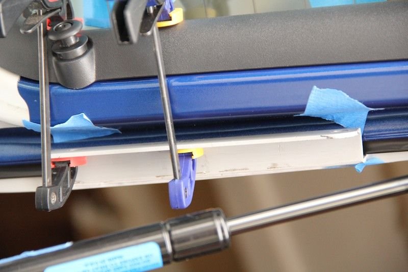

Looks like the install is exactly the same as the Orranje, and I wanted that wing - bought my soon-to-be-installed cam from those guys and they are great - but the shipping costs killed the deal. The build quality on the knock off is solid and @MiniManAdam has used one on both his rides for a while now with zero issues. And based on your photo the gap issues are the same - I love the idea of using those plastic racheting clamps to close the gap a bit further - it's the biggest challenge I had with clearance and fitment.
Another challenge I faced was that the provided push-in threaded inserts, even snugly mounted into the drilled holes on the hatch popped loose once I scewed on the wing. I applied some JB weld on the edges which has kept them in place, but perhaps a better setup comes with the Orranje version.

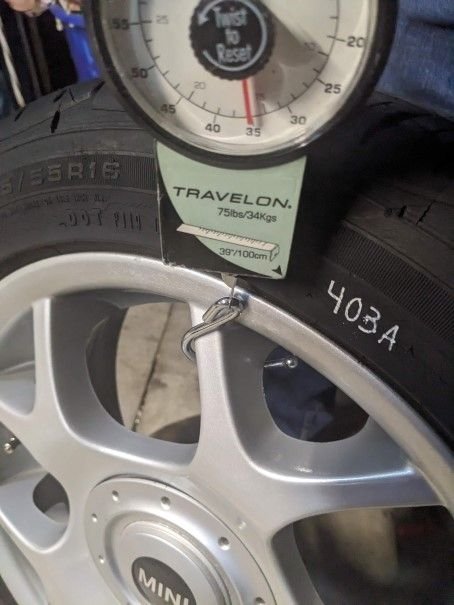

So one setback of working on an 18 year old car is that it seems if it's been done already it's been posted. Then again, the upside is I can find about anything here. In this case, I "upgraded" from those heavy AF 17" seven spoke wheels to 16" factory x-lites, and between the exhaust, intake, and this it's had by far and away the best performance improvement to date, from noticable acceleration gain to a much more comfortable ride to superior turn-in, and I've even gain an MPG on fuel ecomony. In the transition however, I lost the runflats but I'll keep a compressor, patch kit, and can of fix-at-flat at the ready instead.
But seriously, just look at the weight difference - around 12lbs a side for 48lbs less unsprung weight!! Downside is they don't look nearly as nice IMO but a tradeoff I'm willing to make. They have crappy Kelly all-season 195s at the moment so next here are 205s that grip.
