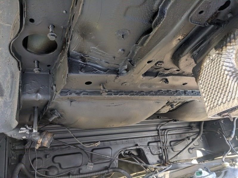

Beautiful weather and tons of progress on the build this weekend:
Front subframe treated, and here's the before and after rear subframe - hours of prep but the result looks great. Adjustable control arms and whiteline sway bar installed as well:
And found a guy with a press to get those control arm bushings knocked off the list:
Also caught some spots of underbody rust hidden behind the gas tank. Spot applied POR15 where rust was, then two coats of rubberized undercoating to future proof the rest

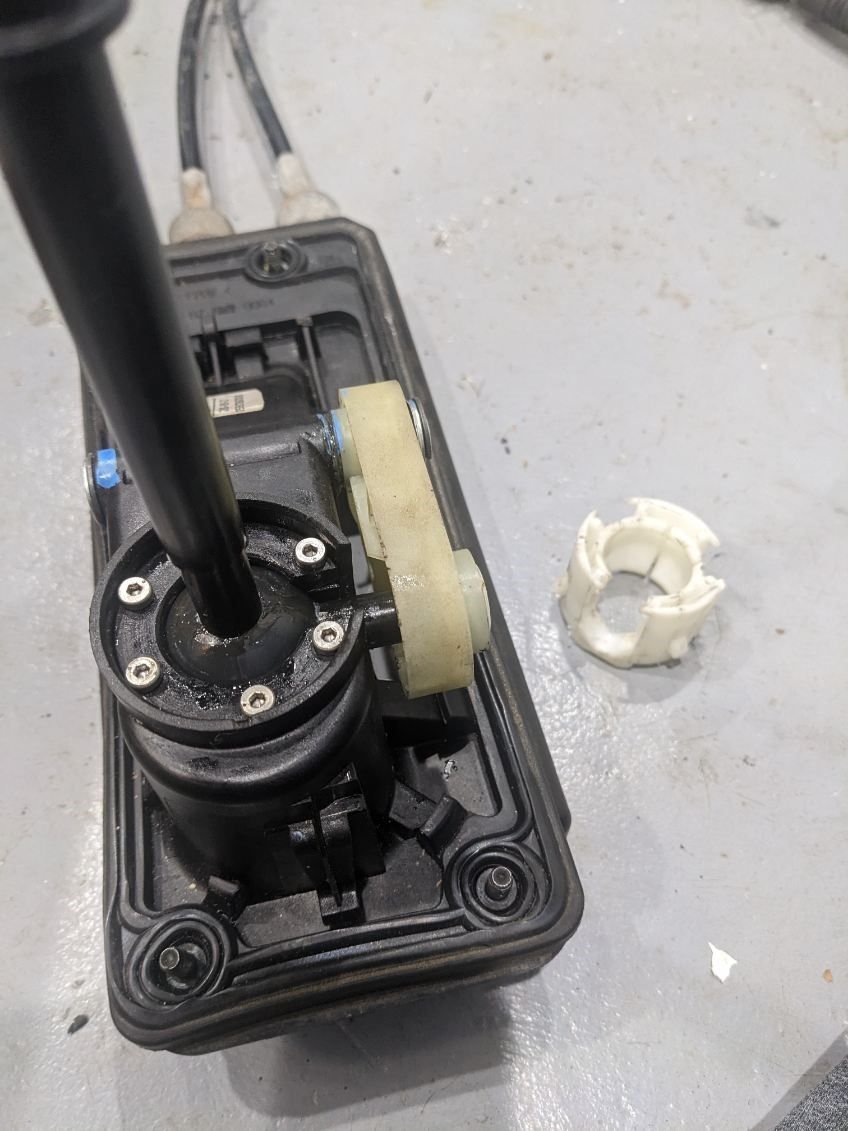

And finallly - I was tired of a sloppy shifter, and followed the lead of @MCS4FUN on an adjustable two piece bushing care of CravenSpeed.
All this gets reassembed when I come back from work travel. Feel great to enter the phase where things go back ON the car.

Looks good! I have a question: with the cravenspeed two piece bushing, the cravenspeed website says that it's not compatible with the r53. What did you have to do to get it to work for you?

^^^ I noticed that disclaimer on Cravenspeed's website too, so ordered instead from Way Motor Works. My thinking is that WMW's fitment description statement is correct: i.e., "Will NOT fit 02-03 MINI shifter box that is white with the 3 ribs, you must have the later black shifter box that came on all MINIs 2004+." Although not described as being Cravenspeed product, open the kit image in a new tab and it'll show that within the URL.
Edit: BTW - for anyone planning on doing the kit upgrade, obtain a replacement Viton o-ring (acts as shift lever "bump stop") with details on that outlined in post # 416 of my own topic.

Thanks for the info! DT says its the cravenspeed kit too, so I'm guessing it's for the R56 shifter box. Will order this as I've got the whole exhaust off the car anyway!

^^^ A worthy upgrade and great timing for you! As mentioned in my linked topic (post # 405 and subsequent), another nice aspect of this bushing kit is that once installed, the ability to quickly and easily adjust clamping tension to suit preferences by simply popping-up the shifter boot.

Agreed! I can feel the change in the shifting even before it's on my running car - even detached from the tranny it doesn't flop around any longer which took a lot of fun out of a gear change before. I had an extra o-ring on hand that fit and you'll need it for that bump stop - mine was dry rotted away. Also, the WMW one linked fit perfect with my black shifter box '06 Cooper S.
It would be a REAL pain in the *** to do this without already having the exhaust removed - great timing. I had a lot of corrosion on the nuts that hold the heat shield down which made for a good time to remove them. It's also a lot of fun to lift all three plastic clips at once to get that OEM bushing off - while simultanously needing to push it out from the bottom, given the whole we only have two hands to use setback...

Excited to try this out and strange that they don't list this as compatible; they could have just said just post 2004 cars! I've literally replaced every other piece of the shifter mechanism to try and get out the slop! Ordered it and paid extra for quick shipping so i can get it on this weekend! Thanks for the help/info and hope you can get your car together quickly! Those exhaust holders are so annoying.

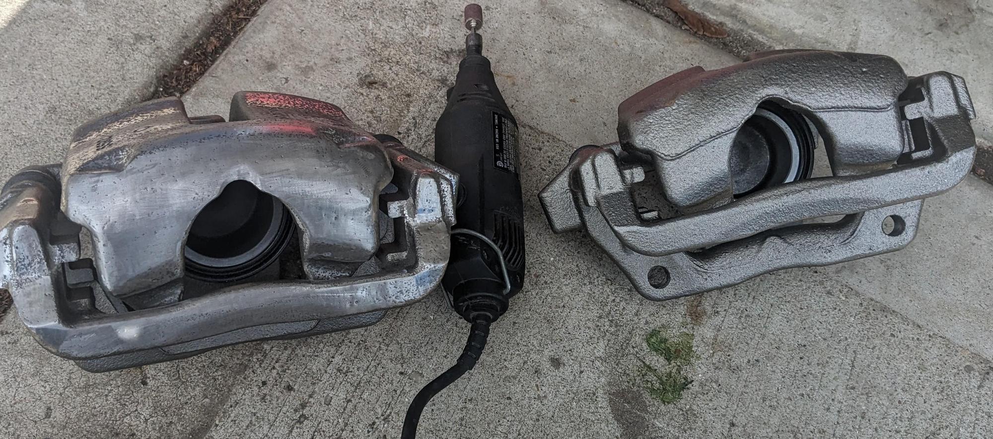

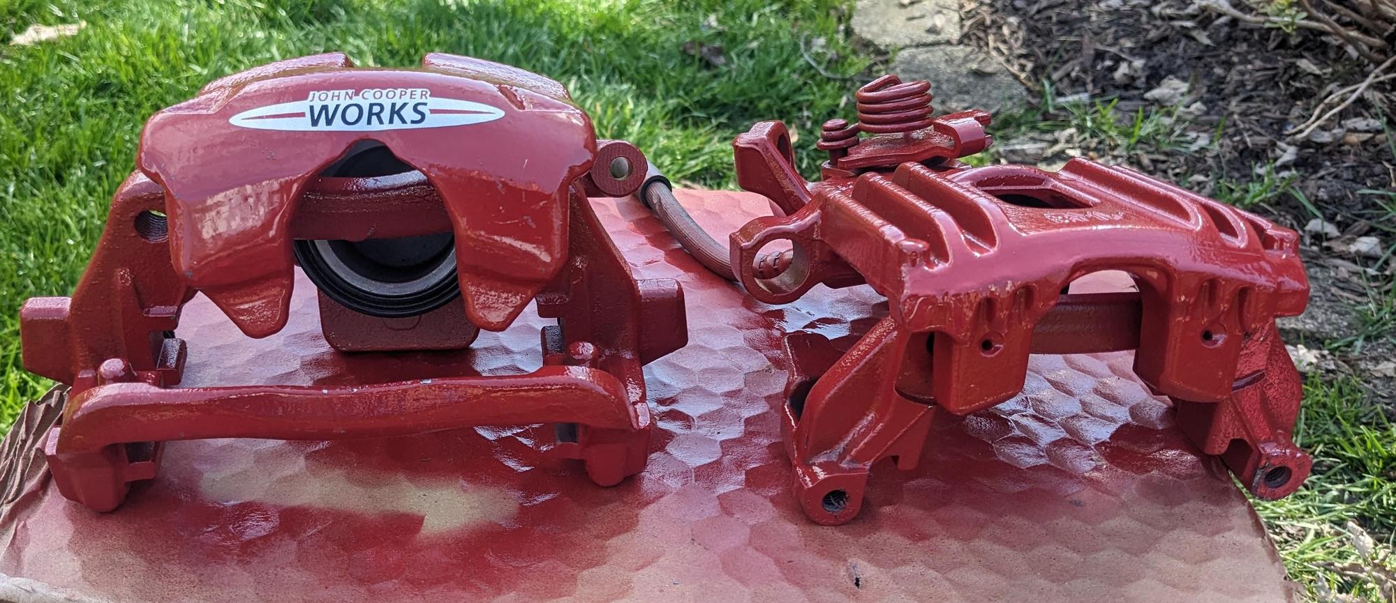

Spring cleaning and yard work this beautiful weekend, but also time to play on the Mini. Catback reinstalled, and my R56 front brakes came in the mail so had some fun with the calipers:
Chose to go with a JCW look for the front calipers. Used a dremel to remove the casting lines and polish them up on the front, and did the same for the rears:
Here they are painted - high heat primer, caliper paint, ceramic coating. You can't see the minor remaining pock marks and imperfections when not zoomed in, love the results. I ordered the JCW stickers (I like the newer look better) from the UK:
And 100% completely done with the back half of the car!

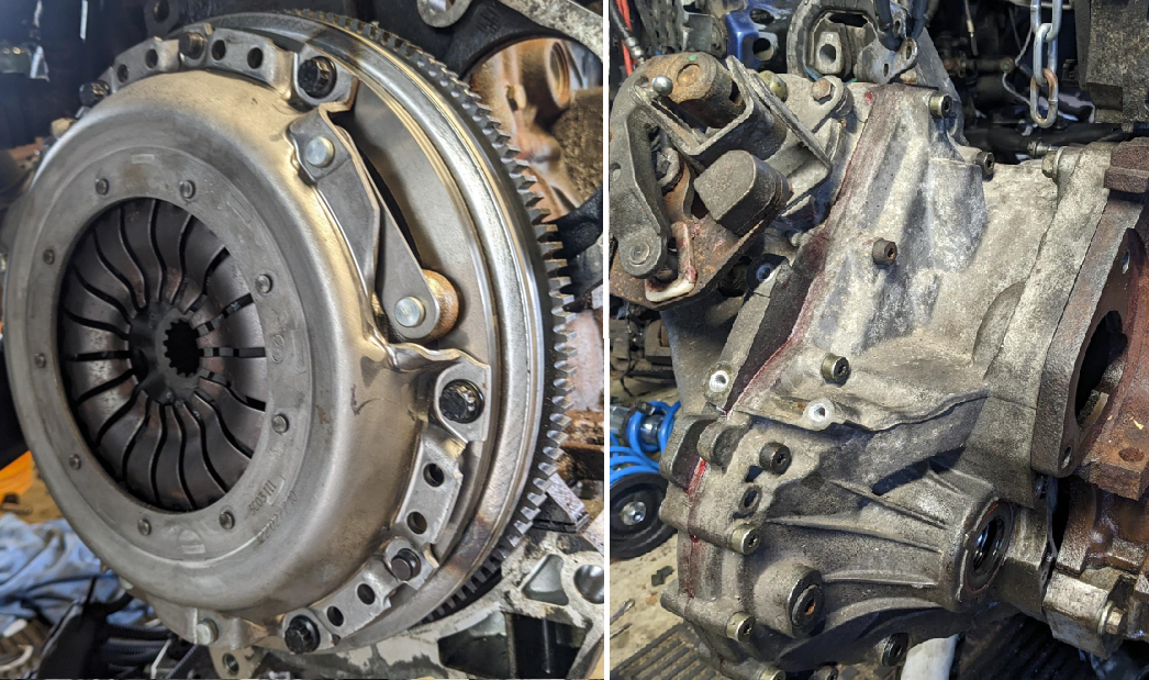

LSD installed, and the transmission is finished and back on the car! Everything looked fresh but with this much work to make it this far, I went all out. Stayed dual mass with a new LUK flywheel, pressure plate, clutch, and bearing. Replaced the input shaft seal for the trans and the real main seal for the motor. Also replaced both crusty, rusted axle seals. With any luck I won't end up like my friend @Boostmaster and have to come back here any time soon!! Some pics:
Before and after differentials. Thanks to the walk through by Mod MINI - my new personal hero - this was a super easy job. Take the old one out, press some bearings, swap the ring gear, and drop in the new one:
Clutch installed - complete with ARP pressure plate bolts that I found on eBay cheaper than OEM. Back on the motor she goes:
A question for folks - how can I check that the clutch isn't binding while the block is still pulled? Beyond this, all the remains are some guages and the motor mods! Then, I expect to reinstall the drivetrain in the next few weeks - SOOO excited.

Excellent work!!! Glad to hear about the progress.Only way you can tell everything (clutch-wise) is working is when engine is under load (e.g. running- ask me how I know )
For gauges I added a boost gauge and a oil pressure gauge (check my thread for details - it all works perfectly.) For voltage, I added a cheap amazon USB adapter that plugs in the cigarette lighter port and has a digital LED read out that works great!
I purchased the 3d printed gauge mounting cups off ebay. They fit fine but the install of the screws in the back of the center display are a royal PITA. (you've been warned)
Now, just take your time and check all the electrical, the water lines, oil lines, and all of the bolts for proper torque. You're almost there!!!
Don't forget the tune. Adrian worked wonders for me and it was relatively cheap and easy considering there was no dyno and it took like 20 minutes.
If you get stuck or have any questions please feel free to reach out. I am happy to help if I can.

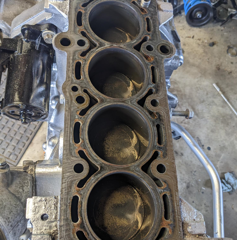

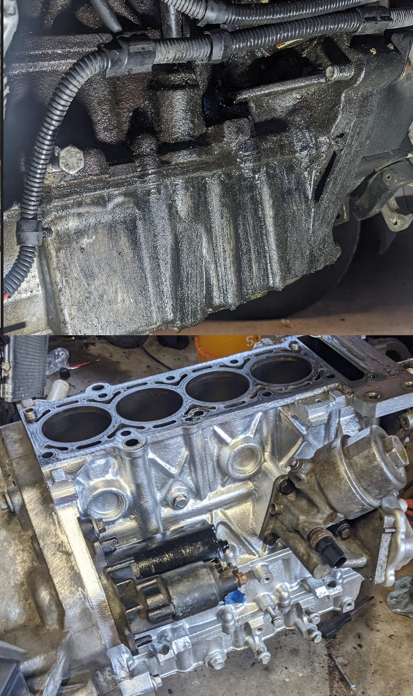

More progress over the past week - and a quesiton. I've got the crud and oil-soaked mess of a block painted and squeaky clean and am now going beyond any prior experience and deep into the block. The photos below show a before and after on the engine block - loads of brake parts cleaner and gasoline to remove all the grease, and wire wheel and dremel work to remove surface rust. High heat primer and bright silver engine paint make it easy to spot future oil leaks:
Now my question - there internals of the head looked fine but there is a good bit of carbon buildup on the pistons. Is this normal? Should I be concerned about piston rings or anything else deeper into the motor? See below, and thanks!

Personally, I would clean off the tops of the pistons, check for the factory hash marks on the cylinder. If they're there I'd leave it alone. Maybe put a little oil in the cylinders and let it sit so see if it dribbles away quickly. Otherwise, I'd probably leave it alone. BTW, that silver paint looks great!!
