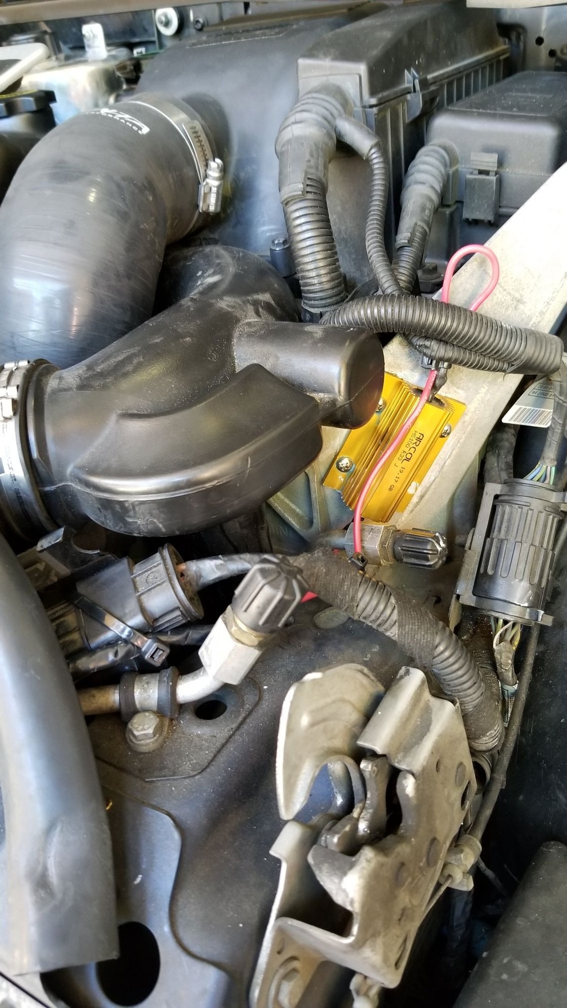

Best bet is to do the Mouser Resistor Mod. I did this 5 years ago and haven't had an issue since. if you replace the OEM one with a similar Resistor, IT WILL FAIL AGAIN! There should be a Thread on it in the Forum.

USNAF2- Do you think that is best on a 20 year old fan rather than replacing the entire fan assembly. All thing will fail sooner or later. This is the fan with two connectors and didn't think there was a resistor relocation. I read a bunch of the long fan thread but don't recall seeing the Mouser Resistor mod. I will search for it. THX

I preformed the "Mouser" low speed fan resister mod on my single plug, pre-facelift '04 R53. It's been 3years since then and - I have to say it is one of the best decisions/mods I've ever made/done.
However If I recall; I think (I think) this particular mod only pertains to cooling fans that have the single plug and not for the early 2plug version.(?)....
Edit: I believe this is the discussion in question Low Speed Fan Resistor - we need solution
Perhaps you might jump to this part of the discussion pertaining to the early 2 plug version/ alternative mod.
Although there maybe more info on the 2 plug mod in the preceding pages/comments.
