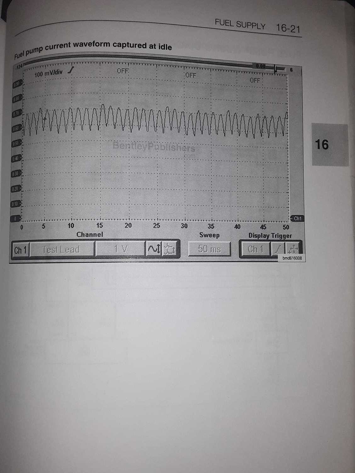

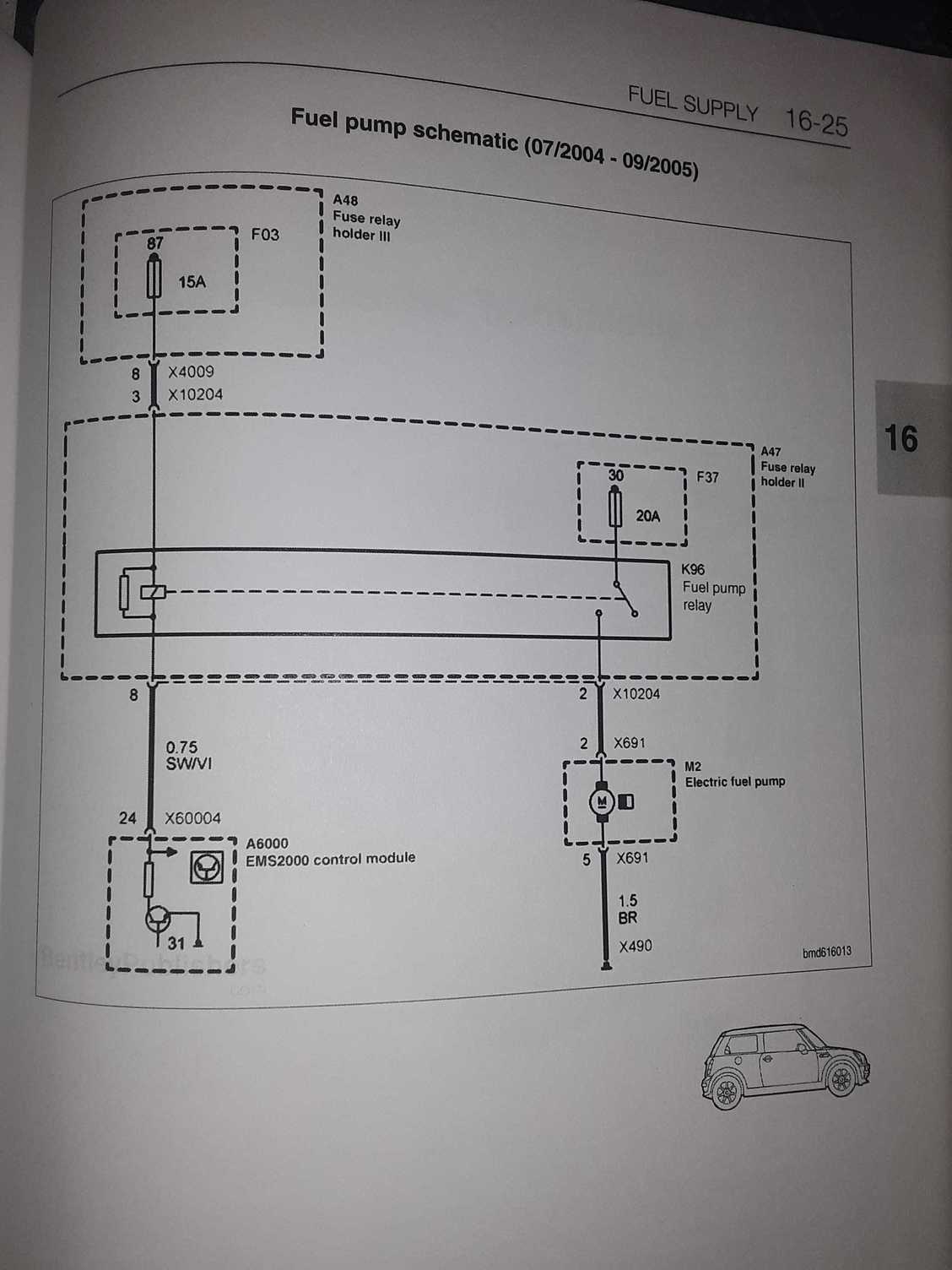

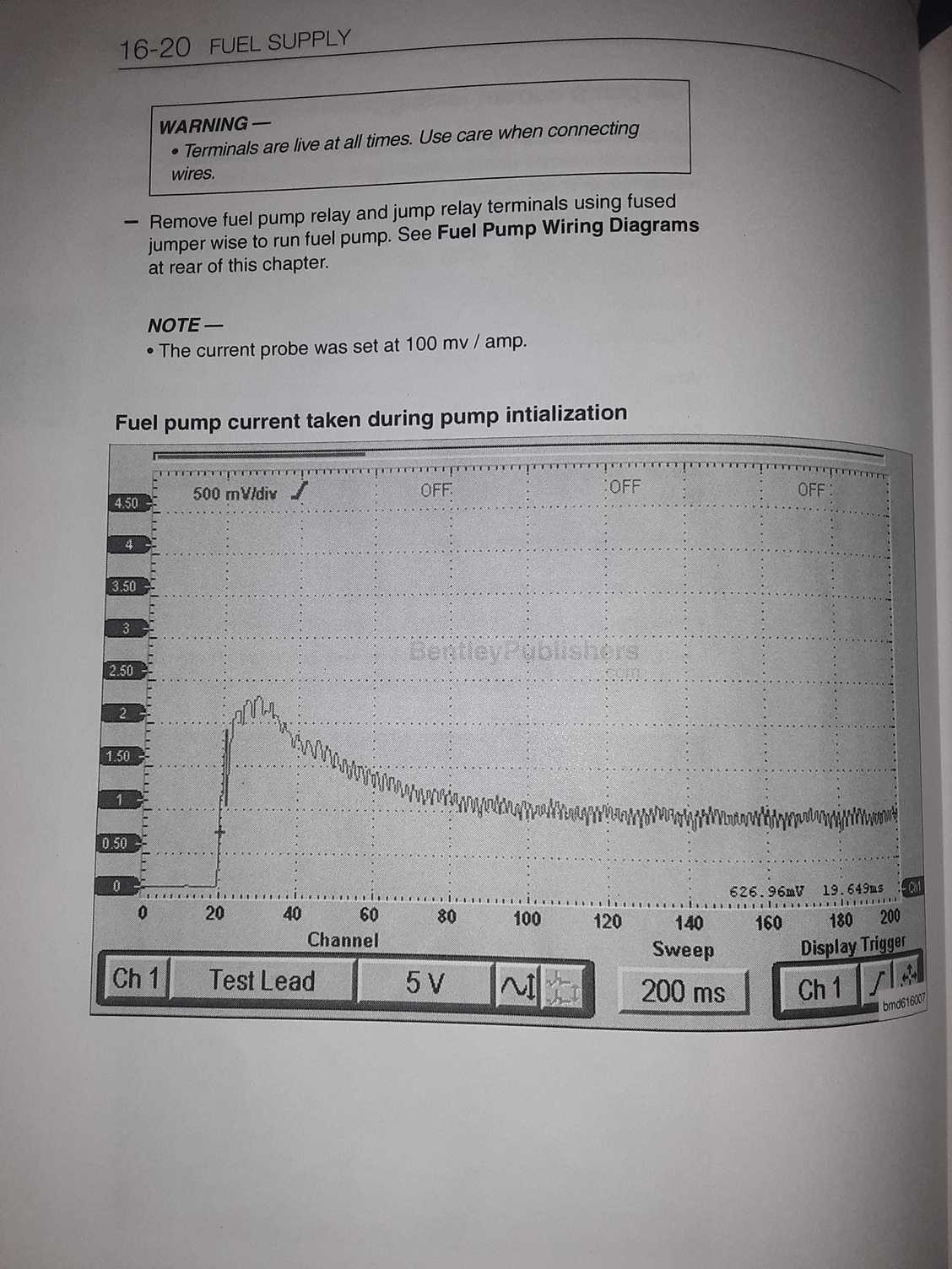

You can rent/borrow a fuel pressure gauge kit from your local parts store. Also fairly inexpensive to buy at Harbor Freight, Amazon, etc. Some of our vendors carry them as well. Threads onto the Schrader valve at the end of the fuel rail, accessed by pulling the intercooler. Watch the boots as you R/R the IC; rubber tends to get dry and brittle with age, heat, oil etc. then tear or fall apart. Not a bad time to change them out "while you're in there" if they're looking questionable. Also make sure the vacuum line from the fuel pressure regulator is attached securely at the other end at the underside of the supercharger discharge / intercooler input horn. These have a tendency to come loose, creating a small vacuum leak and may contribute to this issue.
Fuel pressure should show and hold ~50psi after spooling up the pump before start up. See below from
Bentley Junior 'Diagnosis Without Guesswork Bentley Junior 'Diagnosis Without Guesswork
