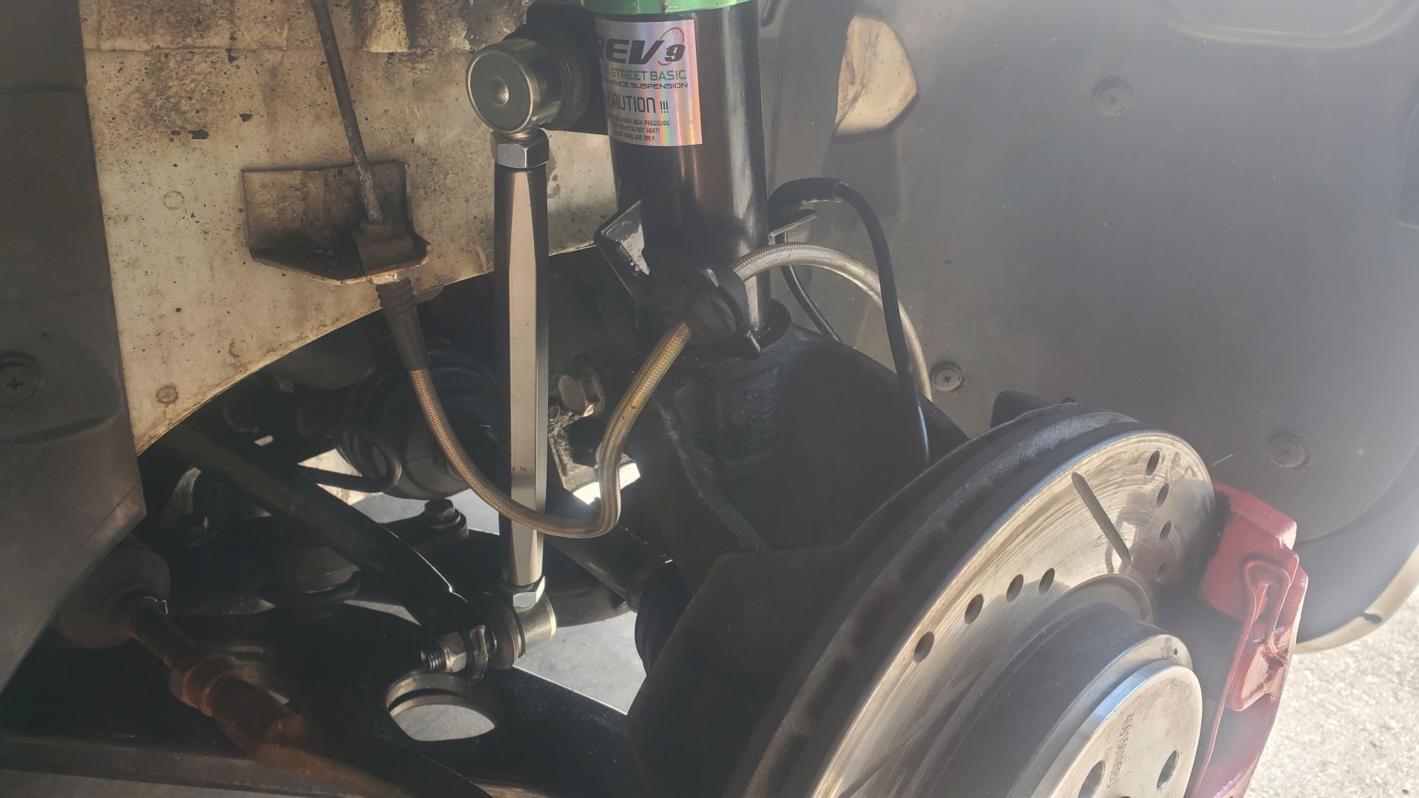

So if your running coilovers and need adjustable front end links , instead of spending 70-200$ for a set you can spend 45$ shipped from maxspeedingrods. I used a set of adjustable end links from a tesla and they're much beefier than the r53 aftermarket ones and far far beefier than oem. You DO need to slightly enlarge the swaybar and strut mount holes but that's totally OK because it uses a larger end bolt then too.
here's pics..

On a daily driver it probably doesn’t matter much if the amount of lowering is moderate and/or you don’t push the car too hard. One thing to watch for on the front is the ends of many adjustable links are too big and can rub on the axles. The Powergrid/Detroit Tuned/WMW links are quality links that don’t seem to have this issue due to their lower profile heads, but they are also on the expensive side at $160
Ideally the sway bars ends should be horizontal/parallel with the ground. On a 1st gen, the front links should be longer and the rears shorter when the car is lowered. If the Tesla links in the first pic have enough range of adjustment to reach the proper length and don’t rub they could be a great deal if you don’t mind enlarging the mounting holes.

If your front end links are still installed as shown in the first two pics the sway bar is most likely being pulled further out of position than if the stock ones were used. It would be best to check your end links and sway bar positions while the suspension loaded with the car on the ground.

Are you sure these are still "needed"? Between these two pictures, looks like the adjustable link might be extended almost to the same length as the stock link? Do you still have your stock link? You should go compare the lengths now that everything is dialed in.

yes you can get by with stock links .. i tried and yes they will work.. though I do have them set different length than stock would be so that the angle of the swaybars stayed correct.
the oem ones though i can flex and bend by hand , these adjustable ones are absolutely solid with no flex.
