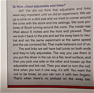

Quick snippet from a book --- answer being given by one of the owners of Texas Speedwerks who were a very well-respected tuning house back in the glory days.
I'm convinced enough to give them a go since I'll soon be installing coilovers myself.

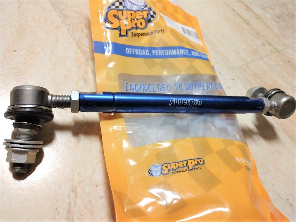

Many options out there --- the kind that they usually supply with the coilovers that you buy are mostly just junk quality, but can of course be used if wanted.
Since you're in Australia,
maybe SuperPro would be a good option for you if you're convinced you'd like go this route.
https://superpro.com.au/
After looking at all the different varieties, I myself chose that brand because they're highly affordable compared to others, I liked their design, and yes the blue color is cool too.
But, I ordered the wrong size --- seller refunded my money but told me just to keep them so I still have them:
Be warned that those particular ones need to be installed "backwards" to prevent rubbing,
Orranje (a shop in the UK) makes note of that aspect:
https://orranje.co.uk/shop-by-brand/...sway-bar-links
And,

So,
maybe give SuperPro a ring to ask them questions and see if they'll help you determine correct fitment.
