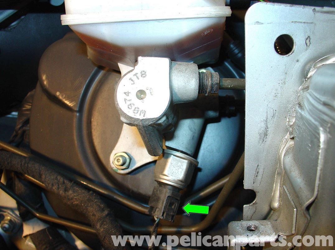

Also by any chance did you spot an unplugged connector left of the brake reservoir? I got one with red and blue wires, and still no clue if it's supposed to be plugged somewhere (though the car isn't complaining about it).
Since it was obvious to me that the clutch slave on my car was in noticable new(ish) condition and not leaking - therefore I saw no reason to replace it and go through the new replacement procedure. Bleeding the existing one on the car, with a pressure bleeder 4 or 5 times(@12psi) was super easy and painless.
Other than the brake level sensor connection that plugs into the lefthand side of the reservoir, I didn't see any other wires or connectors.
Perhaps the wires you discovered (if not for the reservoir), might it connect to the master cylinder?
I'm not sure.

.....Also by any chance did you spot an unplugged connector left of the brake reservoir? I got one with red and blue wires, and still no clue if it's supposed to be plugged somewhere (though the car isn't complaining about it).
@Fradow - By chance does the wire connector in question look anything like the one pictured below?
