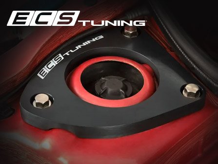

Most do the sandwich. I have the top plates. If you change out the suspension to coilovers then its easy to do the plates. Most plates on the underside will change ride height a hair. https://www.ecstuning.com/b-hamburg-...7400-0070~ham/
https://www.ecstuning.com/News/Mini_..._Plates_28248/
