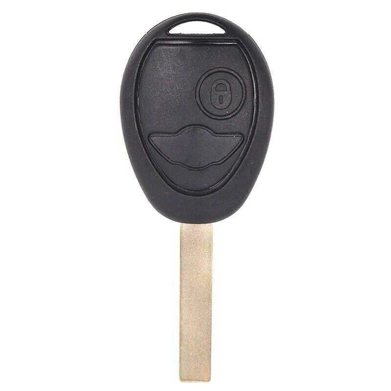

the previous owner gave me 4 keys. Two egg shell ones and two other ones I’ll send the pics of them. Would the recharge work if I use the FL key? I don’t understand how they expected the FL keys to work. Can anyone explain?

Sorry I think I may have confused the matter for you. The PL and the FL fobs are both egg shaped.
Early pre face-lift key fob. (Non rechargeable but replaceable coin battery)
