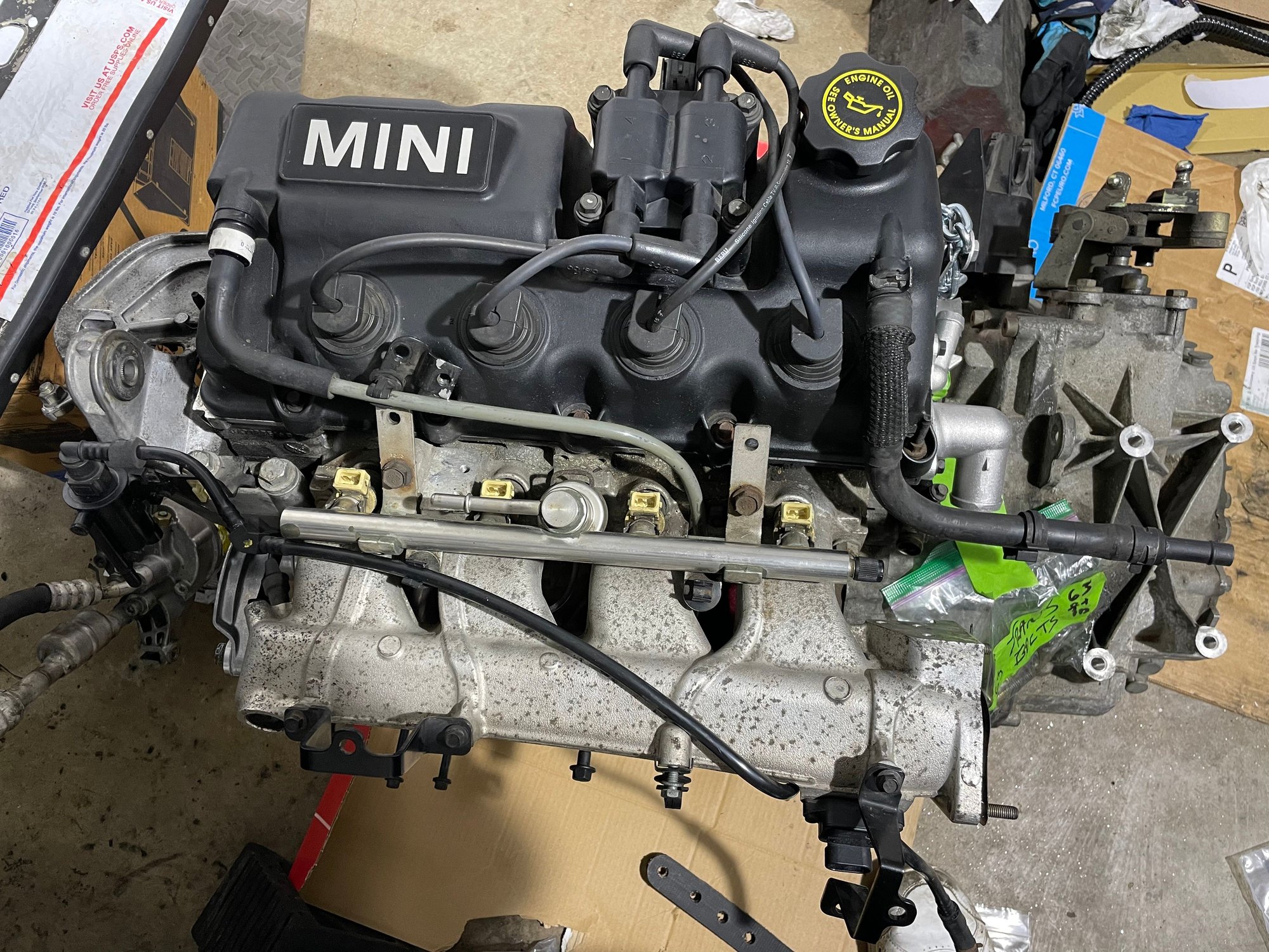

Engine Out!

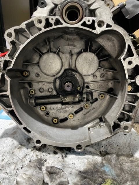

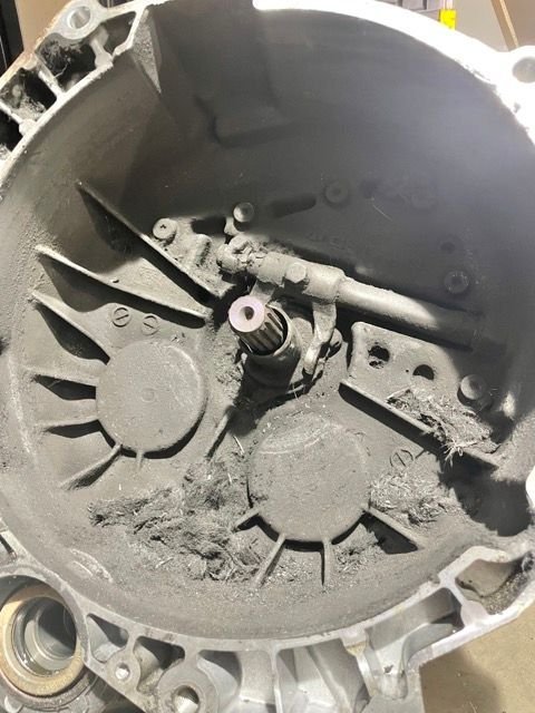

I pulled the engine and separated the transmission. It was stuck but finally they separated. The flywheel was ok, although it was scored and needs replacement. The clutch disk was completely, entirely gone, and its shredded remains were all over the bellhousing, along with a good bit of grease.
I scrubbed and brushed and steamed it pretty clean. The engine ran well before this, so I'm pretty confident that the engine and transmission are fine. Once the flywheel arrives, I'll put it all together and reattach the transmission to the engine. I feel as though I've reached the apex of this project: Everything is now re-assembly, except for the shocks and brakes. Here are some photos of the damage and cleanup. I will clean a bit more before installing all of the clutch components.
Car without its engine
Engine Out!
Damaged clutch and friction material everywhere.
Closeup of clutch disk. Yikes!
Transmission bellhousing before cleaning.
Bellhousing after cleaning.
Big mess after cleaning.

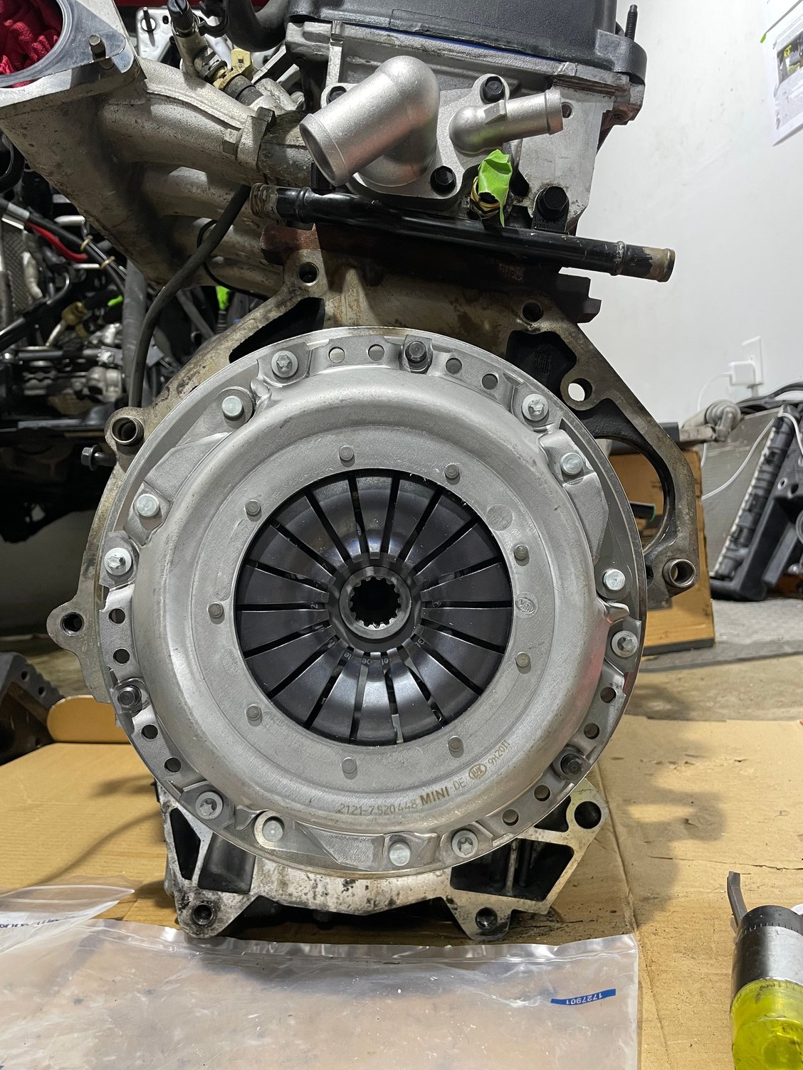

My flywheel came in, so last night I assembled the clutch and bolted the transmission back to the engine. The two mated almost immediately. It was very easy going. I guess it pays to spend a long time carefully aligning the clutch plate, and having the engine out helped as well.
I’d like to test the clutch somehow, but it will be a while until I can reinstall the engine and reattach the clutch cylinder.

Another thing I learned: Clutch alignment tools are fairly useless, at least on these cars. My clutch/flywheel is 100% stock, and I was able to reach in with a finger and feel the clutch disc’s alignment against the clutch plate. You can very accurately center the disc this way, much more accurately than with the alignment tool. I had several false starts, in which the disc moved very slightly, and had to loosen bolts and start over. I followed the bolt pattern from Bentley carefully… first hand tight all around, then 25, 45, and finally 66 ft-pounds of torque, each time in sequence. Once I reached 25 ft-lb, the disc was aligned perfectly all around and I didn’t need to keep re-checking.

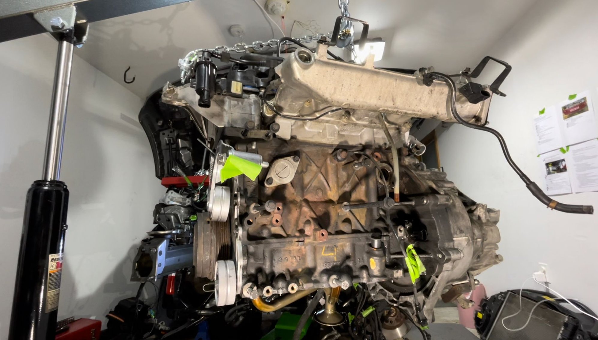

Installing engine
Finally putting the engine in!

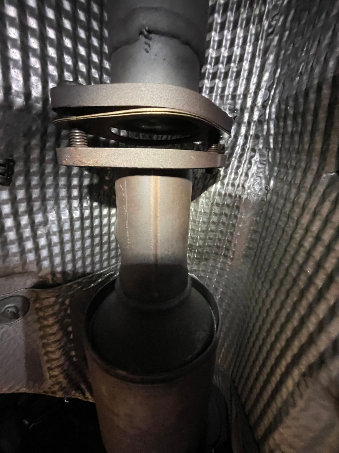

I’m hung up right now: I disconnected the exhaust at the catalytic converter and then attached it to the exhaust manifold.
Then, I fitted the engine to the passenger side engine mount.
But, I can’t get the exhaust lined up at the catalytic converter, which is also stopping it from lining up with the other engine mount. I guess I’ll just keep working it until it lines up. It’s pretty tedious moving the jack, then crawling under the car, moving the jack, but sooner or later it should line up.
I’m not really using the brace across the engine any longer, except for a few things I’ve tied to it.

If it doesn't fit force it, if it breaks it needed to be replaced anyway!
Only kidding.I learned a long time ago that taking a MIni apart is easy, getting back togther and everything lined up is a bear. Hope you get it soon.
