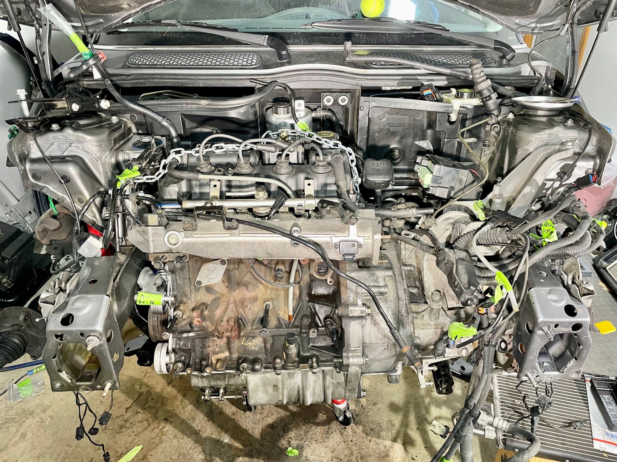

Engine is in!
I got the engine mounted! Yahooo!! It was much more work than I expected.
First I had trouble aligning the exhaust, so tonight I removed the CEBT (center exhaust bracket thingy), and that did the trick. Then the engine wouldn’t go far enough back, so I lowered the subframe. I forgot to loosen the steering link so I raised it again to loosen it. I hope I didn’t do any damage.
With the subframe lowered, I lowered the engine WAY down and got the shift links connected. They were a bear. Attaching them to the little ball joints was easy, no tools, but getting the sleeves to fit in the transmission bracket was quite difficult for me. But I got that done, the exhaust was attached and I finally got the mounts attached on both sides, and off came the hoist.
I still have a lot of work ahead of me, but I’m pretty certain there’s more work behind than ahead. Time for a well-earned cappuccino.

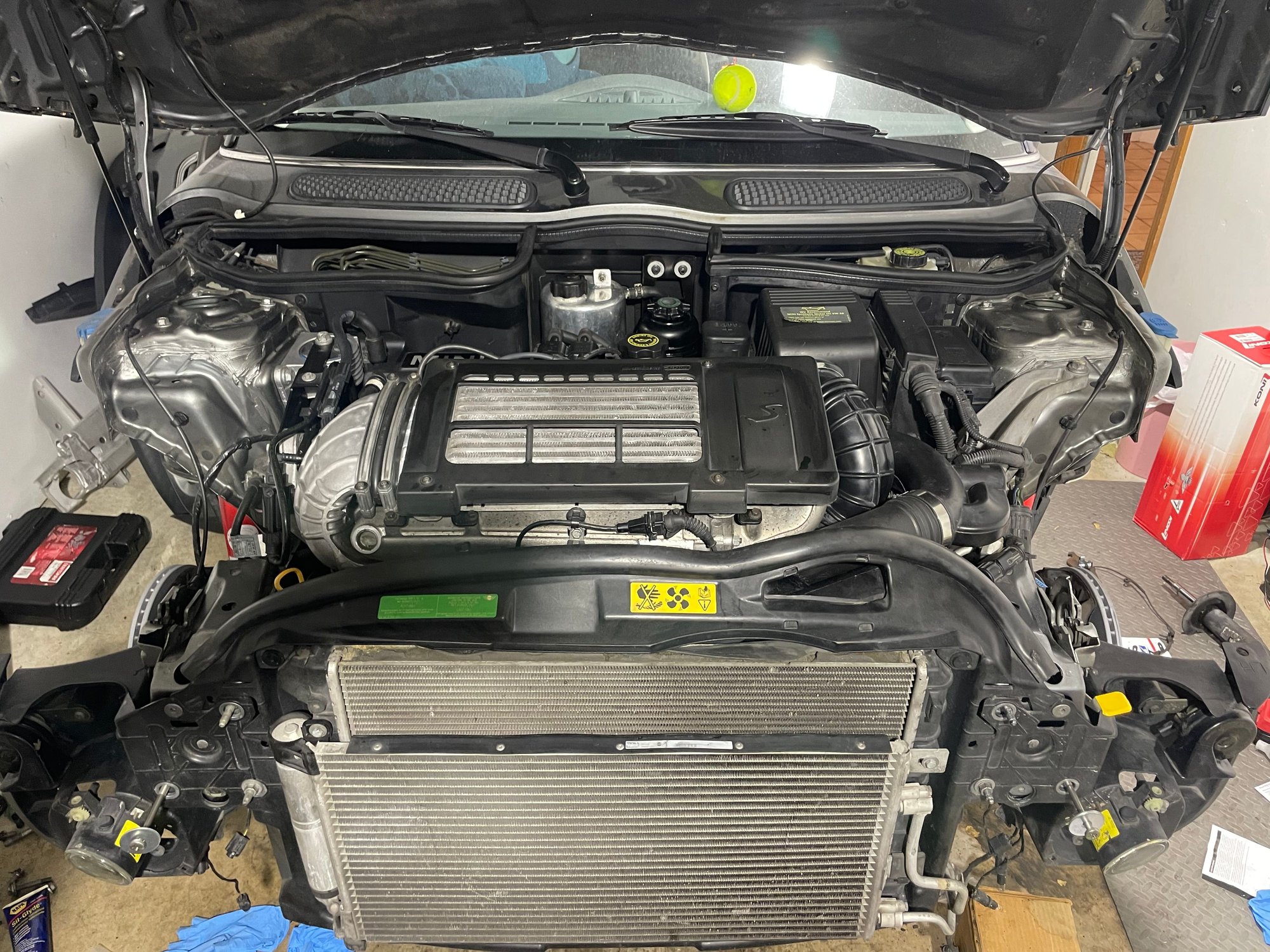

Latest Update
Since my throngs of adoring fans (all two of you), are clamoring for an update, here goes:
I’ve reattached all engine electrical connectors, the axles, filled the transmission with fluid, everything behind and below the engine is perfect, installed the intake and the throttle body. The throttle body was filthy and got half a can of throttle body cleaner, which helped a lot.
Engine-wise, I only need to replace the intercooler, air intake, and the radiator/condenser. Then fill it with motor oil, coolant and power steering fluid. Not much at all!
On top of that, still need to reattach the subframe once the new bolts show up, attach all the suspension stuff, replace the shocks and brake pads/rotors, and flush the brakes and clutch. Maybe I’ll do the brakes before I put the radiator back on, to make clutch bleeding easier.

Today I put the intercooler on and started to put the air cleaner box back in.
I cleaned off the top of the intercooler for about 20 minutes. Then I put it on, and it wouldn’t fit, and finally I realized that I did a great job cleaning the bottom of the intercooler. Another 20 minutes cleaning the top.
Then got the air cleaner plastic parts and cleaned them up and there was a little metal bracket laying with the air cleaner parts. Hmm… Where’s that go?
It was a small bracket that bolts to the transmission and supports the throttle body. And it wasn’t going on easily, so off comes the intercooler and off comes the intake pipe and in goes the bracket and back on with the intake and back with the intercooler.

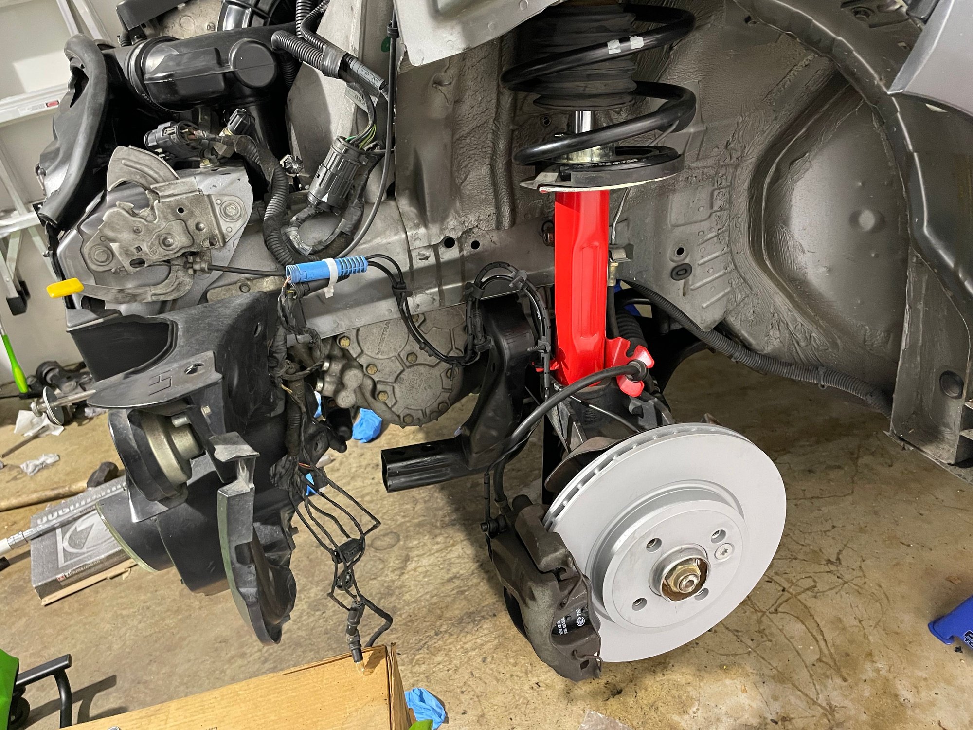

This is exciting! I had a very productive day!
First I drained power steering as best as I could. Then I put the subframe back on and installed the outer ball joints. Torqued everything to spec, which was fairly difficult with many bolts because it’s necessary to hold the bolt with an Allen wrench while torquing the nut. For most, I used a torque wrench with a crow foot.
Both front struts installed. Replaced the front brake rotors and pads. Put the radiator and AC condenser back on. Filled the oil and coolant. Tomorrow I’ll add more coolant and the power steering fluid, put the battery back in and see if she starts up.
This has been the biggest car project I’ve ever taken on by a long shot! My skill level has notched up a lot.
