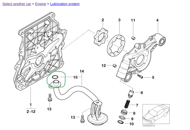

Maybe the oil pick up tube seal into the bottom of the oil pump?
May can you describe it in more detail. You thinking of leaking?

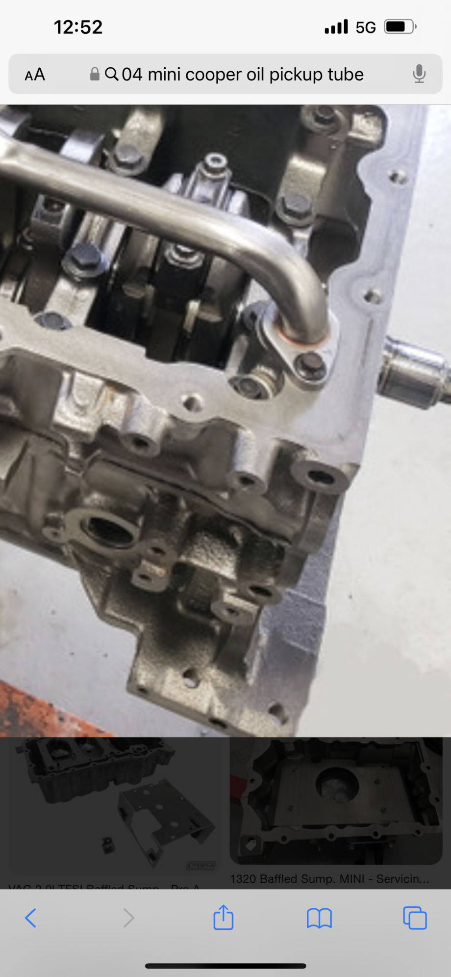

There is a rubber seal on the pickup tube where it attaches to the lower block.

Part #15 above.
If this O-ring is dry, brittle or cracked and not providing a good seal, it's like when you try to drink through a straw with a crack in it - doesn't work very well. This usually presents itself at idle.
