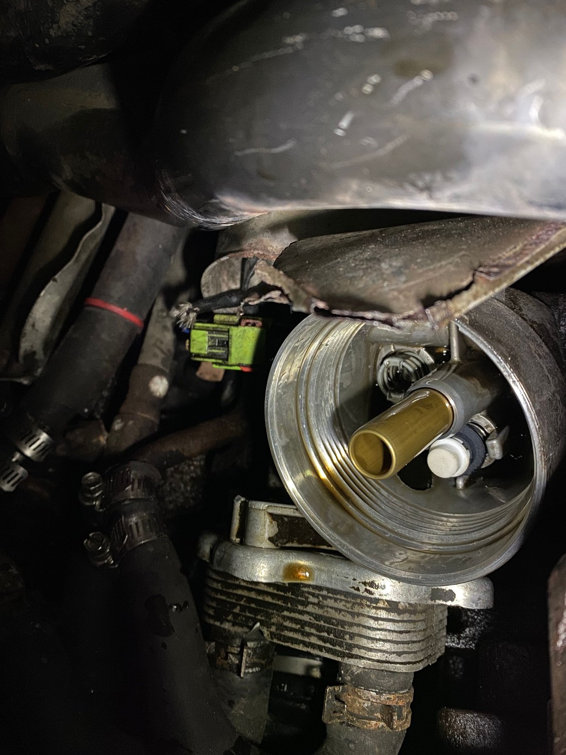

May can I ask you how to remove/change exactly the plunger?
- Pull with force? Is there a secure spring?
- Do I need to remove the housing or can i change the plunger just by open the oil cover?
- Can i open the Oil cover from the housing, without draining the oil?
- Yes, just pull it firmly (it will probably break one of the 3 teeth/tabs that hold it in, but that shouldn't do any damage in the pan and is too large of a piece to get past the pickup screen)
- No, you can do it by just removing the filter
- Yes, but you will lose a small amount from the filter, but why not drain and change the oil and filter, since you already have the filter off.
Awesome, thank you so much for the detail description.
I open the oil cover and took out the oil filter. The plunger is moving up and down.
But when i move it in a circle there is a kind of imbalance

Yes you can remove the plunger by grabbing it tight with your finger and pull it out. You can remove the oil filter cover without needing to drain the oil ( it will spill a bit of oil out when when you do that )
