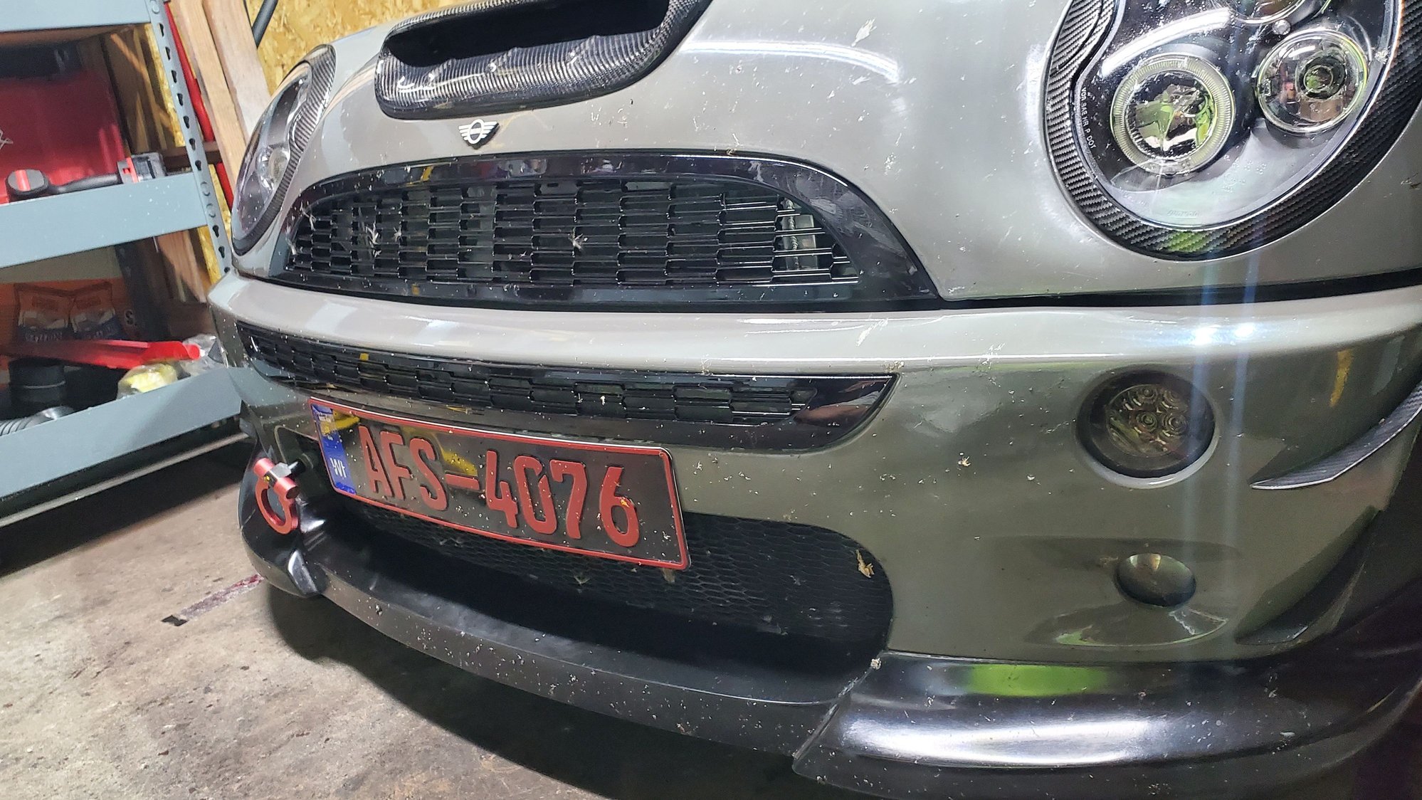

Sooooo major ISSUES running stock ic...
I went on a 14hr round trip , pretty much strait through driving and heres my issue..buuut good news is the car did avg 25.7 mpg..
the stock ic ran usually about 100'-110' degrees warmer than my set speed. So if I was doing 30mph it sat around 130' and at cruising at say 80 it would sit at 180'..
sooo after about 2hr of cruising 75-80mph and still not keeping up with flow of traffic i grabbed my vape out my cup holder.. IT WAS ALL STICKY and leaked it fluid everywhere AND WAS HOT AF ! My whole shifter assemble on the bottom was HOT as well as my cup holders in front and the tunnel when I pressed my hand on it or leg was HOT. It heated up my vape SO much it boiled out the fluid , granted it's a low boil point but this has NEVER happened before in any condition ever !
My oversized ic would NEVER run above 130' cruising at ANY SPEED , EVEN IF I WAS DOING 100MPH SUSTAINED. If I was going up a big hill / coulee or moraine and it was see aaaaaaany boost , like even 2-5lb of boost it would heat up to almost 200' and BS these stocks recovers faster , once back off the hill back just cruising and even coasting IN NUETRAL down the big decent the stock ic took atleast 5min to return back to the 170-180' temps.
I literally could feel the exhaust tunnel radiating heat off of it and it had me so SO SCARED it was going to get so hot it might have burst into flame.. im SO GLAD i fixed and added some extra heat shielding when i installed the coolerworx shifter.. omg omg OMG , absolutely totally not going to be doing any more trips like that until i get another upgraded ic..
I cannot belive you guys run your cars at those temps..I know alot has got to do with my Sprintex and if it's making as much heat as it is , if your running a sprintex YOU NEED to upgrade your ic , they just can't handle it.. atleast how fast I'm spinning mine it can't..
that journey told me everything I need to know now about the stock ic and how it functions on a setup like mine. IT ABSOLUTELY NEEDS TO BE TAKEN OFF, THROWN FAAAAAAR AWAY...
Now , these were temps with bright sun and 80'F outside temperature. At night once it cooled down to 65-70' intake temps only dropped by avg of 10-15' only
lol ,here's my front end once I got back home..

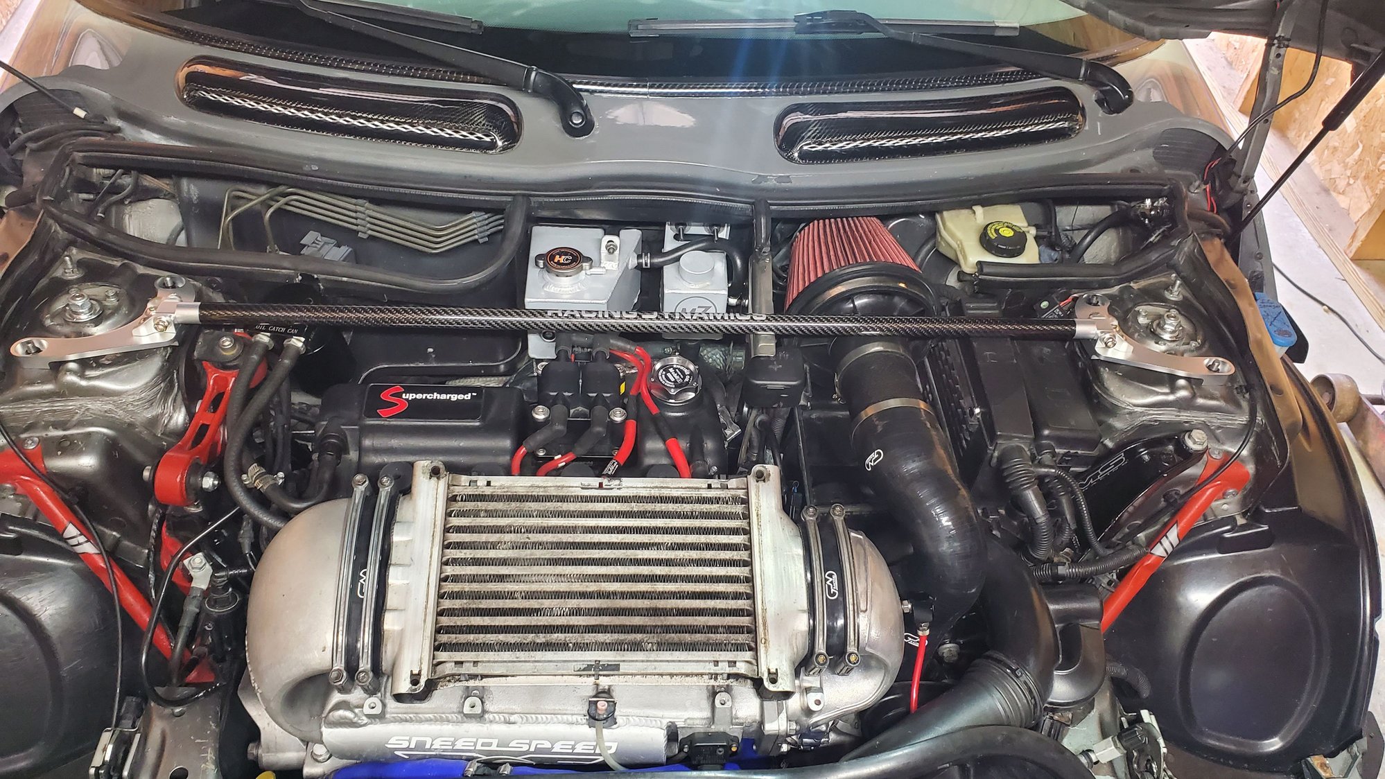

So what’s the best bang for buck intercooler you would say to get ? Once you upgrade to a bigger intercooler don’t you lose the ability to mount the cover back on right ?
Old Jul 25, 2022 | 11:42 AM
The Devil Z's Avatar
The Devil Z
Joined: Nov 2021
Posts: 538
Likes: 126
fwiw if you dont have the under hood and the divertor on the intercooler it will do this. No idea if you had both on but I have over heated a bone stock car by not having one or the other on
Old Jul 26, 2022 | 05:20 AM
Da_Ghost's Avatar
Da_Ghost
Posts: 880
Likes: 56
From: Québec, Canada
It's almost as if it was engineered to direct air flow properly. I've seen my share of people without those over the years... If you don't like the stock diverter, DDM and others makes replacement ones.
Old Jul 26, 2022 | 06:31 AM
The Devil Z
Joined: Nov 2021
Posts: 538
Likes: 126
roflmao yeah who would have thunk it But honestly yeah I see lots of people run without and it will cause exact what Adam is describing. I dont bother anymore really. All you can do is put the info out there and let people discern it how they want.
