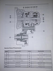

I am clueless about the automatic transmissions in these cars, but here's a few pages from a book that I have...

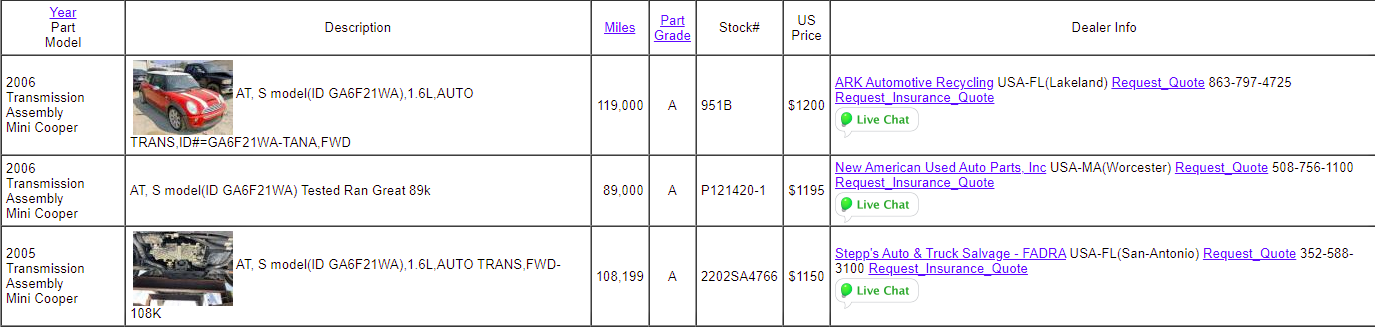

If it is impossible to troubleshoot and diagnose, one option would be to buy a used unit from a junkyard and swap it out.
https://www.car-part.com/
A good resource where you can look sorted to price, mileage, or distance.
