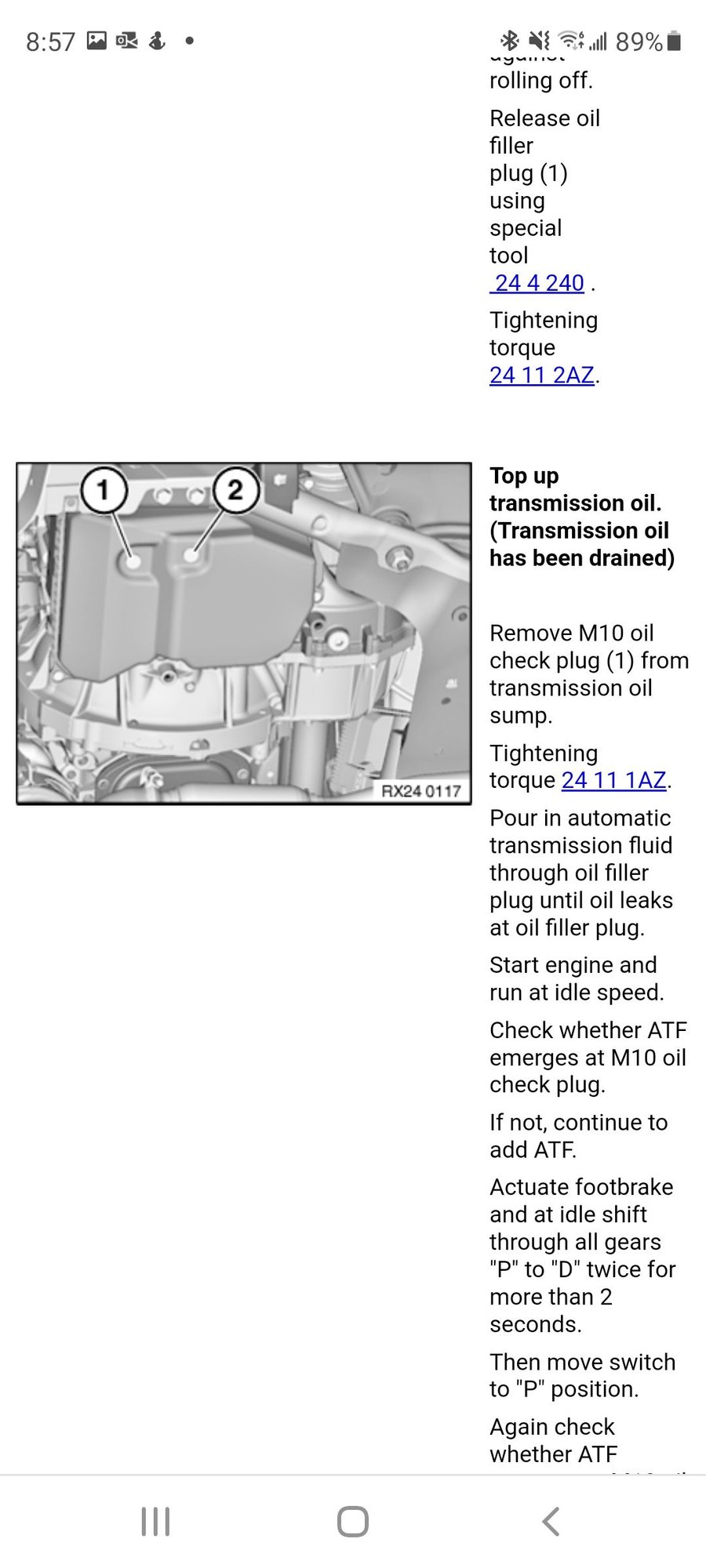

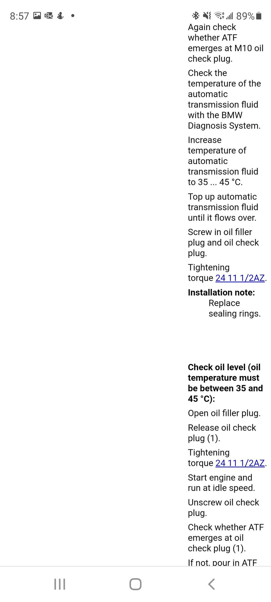

I wouldn't. Also here is the actual procedure for doing the fluid change from bmw.
thx but again isn't posing me much good as I only have the filler tool for the bottom of the pan and it's the only way I'm doing this, I've already bought all the parts and pump to do it this way... again, no tools or special tools or namebrand fluid is being used.. not worth putting 500$ worth of new high dollar parts in something that might not even be the issue. This is a big guessing game I'm taking here so every dollar spent counted with this one.
btw, not one link either above takes me to anything either unfortunately...
but I got the filter kit , bottom filler tool and fluid is being bought soon..

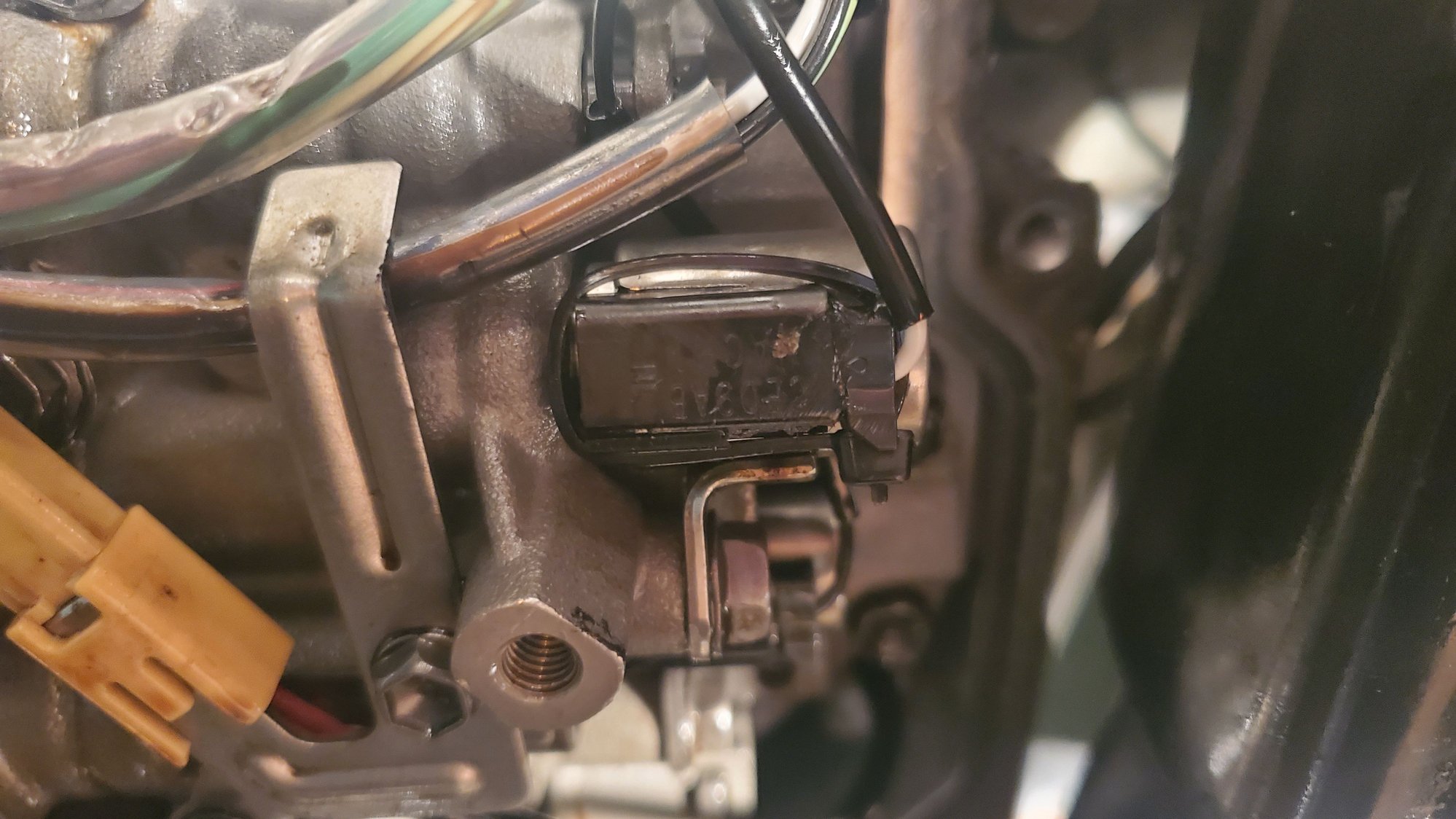

Soooo fixed all the minor little issues and here's where I'm at..
I have everything all hooked up and stuff and I powered on the car to see if the gears had the [D] around them like that indicating there was an issue with that selection and thankfully D , R , N and SD all show up normal Buuuuuut when I put it in SD I cam only select 1 and up to 2 , it will not allow me to select anything past that.. I swear I read you should be able to select all gears in power On Accessory mode with it in SD . Or am I wrong and should only be able to select 1 and 2 ????? I can hear the solenoid engagement as I select 1 and 2 buuuut nothing after...plz tell me this is normal .
any idea where this bolt came from ???? I cannot fir life of me figure it out, maybe a random bolt I picked up off my floor???

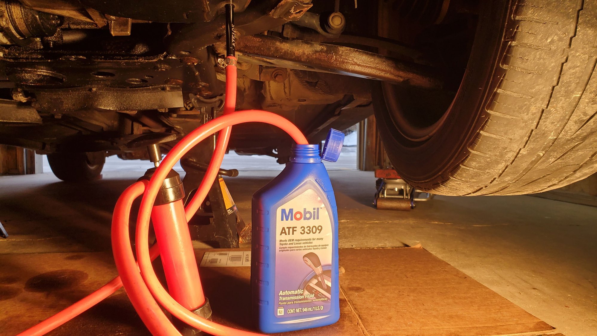

Valvebody is in , filter is in , all wires are hooked up and I had to fix a broken connection that must have gotten cracked in transit. I also got those 2 snapped off bolts out for the transmission pan. The correct fluid arrived today and I got 6x qt of mobil 3309..
but if you read above that's where I'm at..if that's normal then I'm going to go put I the gasket, pan ,attach the filler tool to the bottom of the pan , hook up my hand fluid transfer pump and pump in 5qt since almost 6qt came out and more drained as it say for 2weeks.
I'm going to do all I can reading the fill procedure from the bottom but I think I got it.
​​​​ get the car leveled on jackstands.remove drain plug and leave In the stem and screw in the adapter. Pump in 5qt and if nothing drains out of the adapter conti ue pumping in until it flows out pretty fast and allow it to come to barely a dribble and then put in drain plug.. then power on the car and run it through the gears. Then start the car and go through all the gears for a few seconds in each gear about 4x or 5x times and allow to get up to temp in park. Then shut off and remove drain plug and install the filler adapter again and see if the fluid either runs out very fast or not at all and repeat the process while warm as I did when it was cold.. ( I will put the fluid in front of my heater too while engine is warming up to add after that so it has the same thermal expansion of the fluid for more accurate measurement)
These 2x spots are where the bolts snapped off , thankfully for the grommets it left enough for me to grab on with vicegrips.
