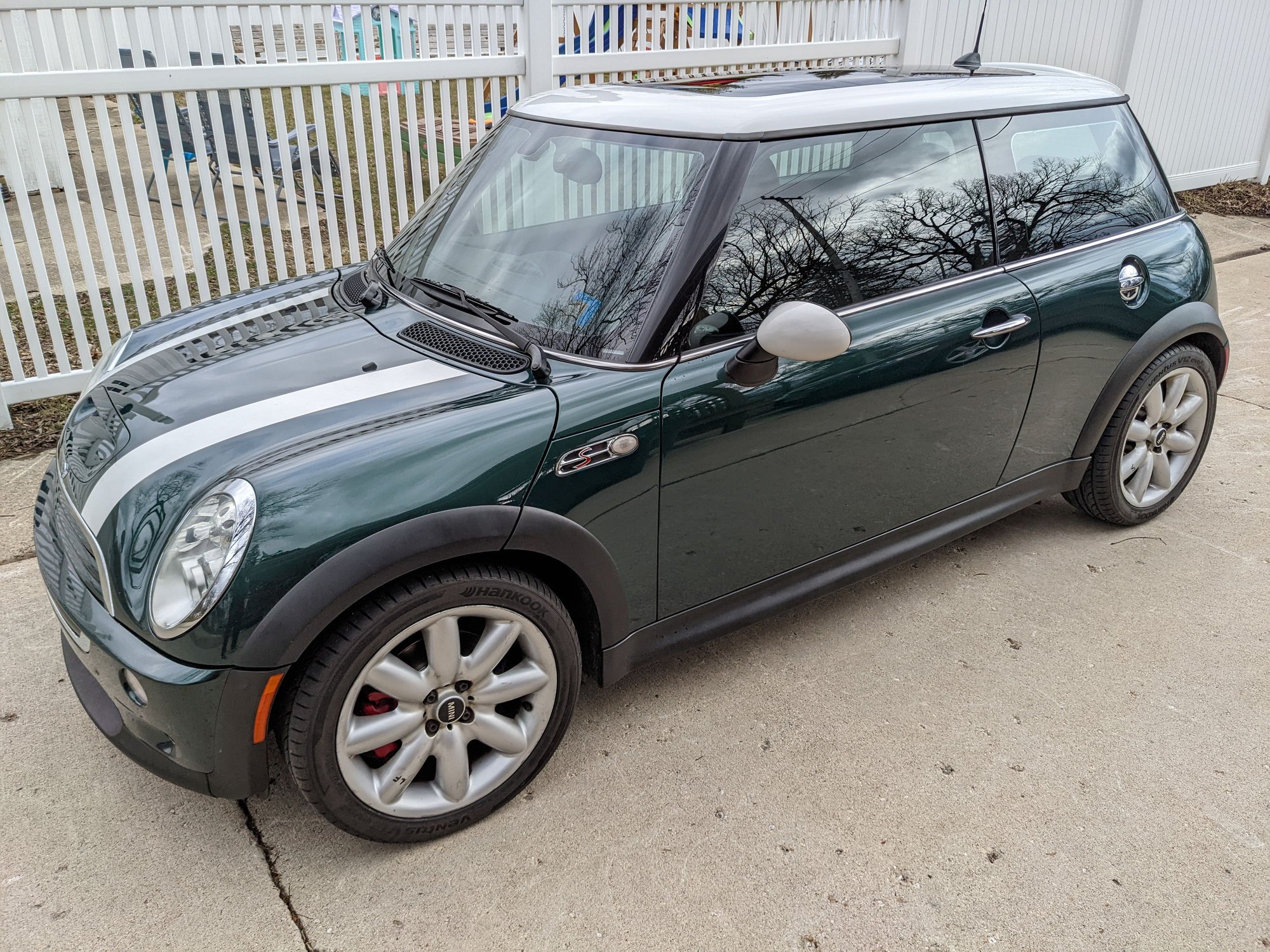

megaMini 3.0: $1520 FJCW dream build
One of the two drives I've been on since I've owned it.
"Dream build" may be a little clickbaity; but this is definitely my dream mini. I hadn't intended to do a specific thread, but with all the positive feedback from my last project...why not? Plus, I like having these as a way to help me remember what I did when. I first teased this back in July of last year. TLDR: Was supposed to be finding the wife a minivan but @wmcoons found this at a mini meetup for me instead. I got it in 'driveable' condition as quickly as possible but told my wife I wouldn't drive it until she had her van. The van showed up in November, and I sold my previous Mini earlier this month; providing me with the time, permission, and funds to build this one. Here goes:
Of course before this project even gets off the ground, I've got a dilemma. I finally got time to get under my 300ZX and see what the issue was, and I'm 80% sure I've got a blown turbo. The turbos I'm using are essentially NLA, so it's hope a rebuild works or make the swap to newer technology which will be a budget buster. I'm going to prepare for the worst and do the JCW build in stages.
The #1 priority for the JCW is to keep it 'comfortable'. No super loud exhausts and it must pass emissions. My wife isn't a fan of Mini's but tolerates my obsessions; I don't want her to completely hate the experience. I'd like to get in the low 200's for WHP, but no header might make that tough; I haven't heard of any that make quiet power.

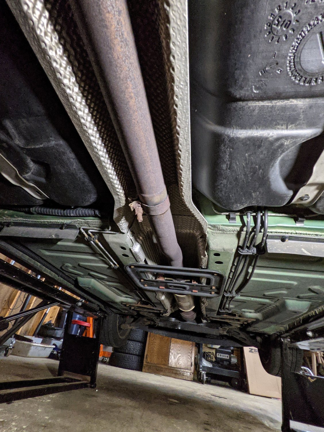

Shockingly clean exhaust/heat shields
Clean underbody

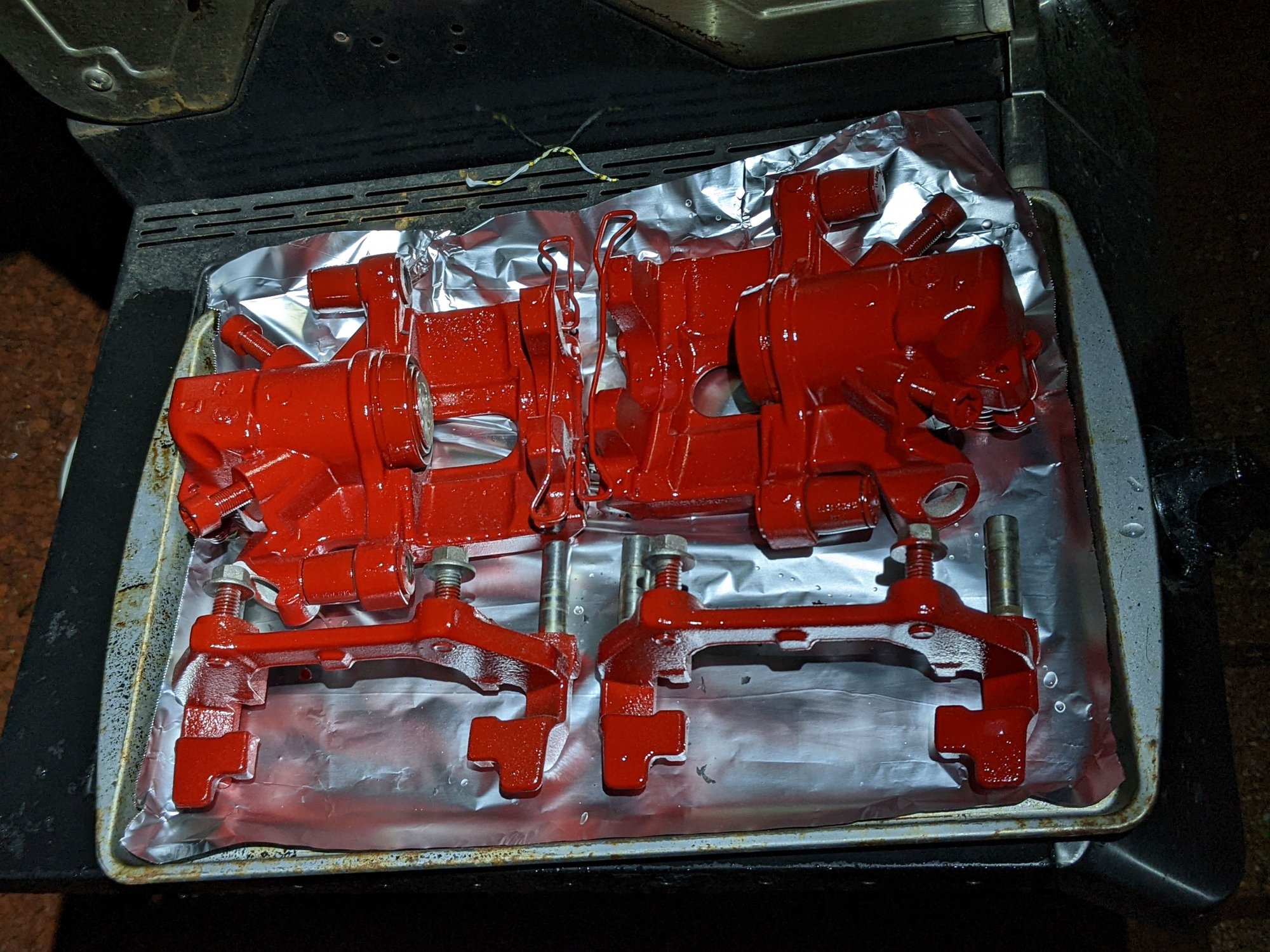

That pretty much brings us back to current day. I've got the rear brakes rebuilt and painted, the front suspension broken down, the rear suspension assembled. I'm to the point where I can't do anything until my Ireland Engineering order of front camber plates, rear sway bar, and brake lines arrives....which should happen today! From now on its crunch time and I shouldn't need to wait on parts.
Rear shocks have been assembled for weeks waiting for rear sway bar to show up :(
Rear calipers before shotblast
Rear calipers after shotblast and ready for paint
VHT real red applied and baked in my grill.

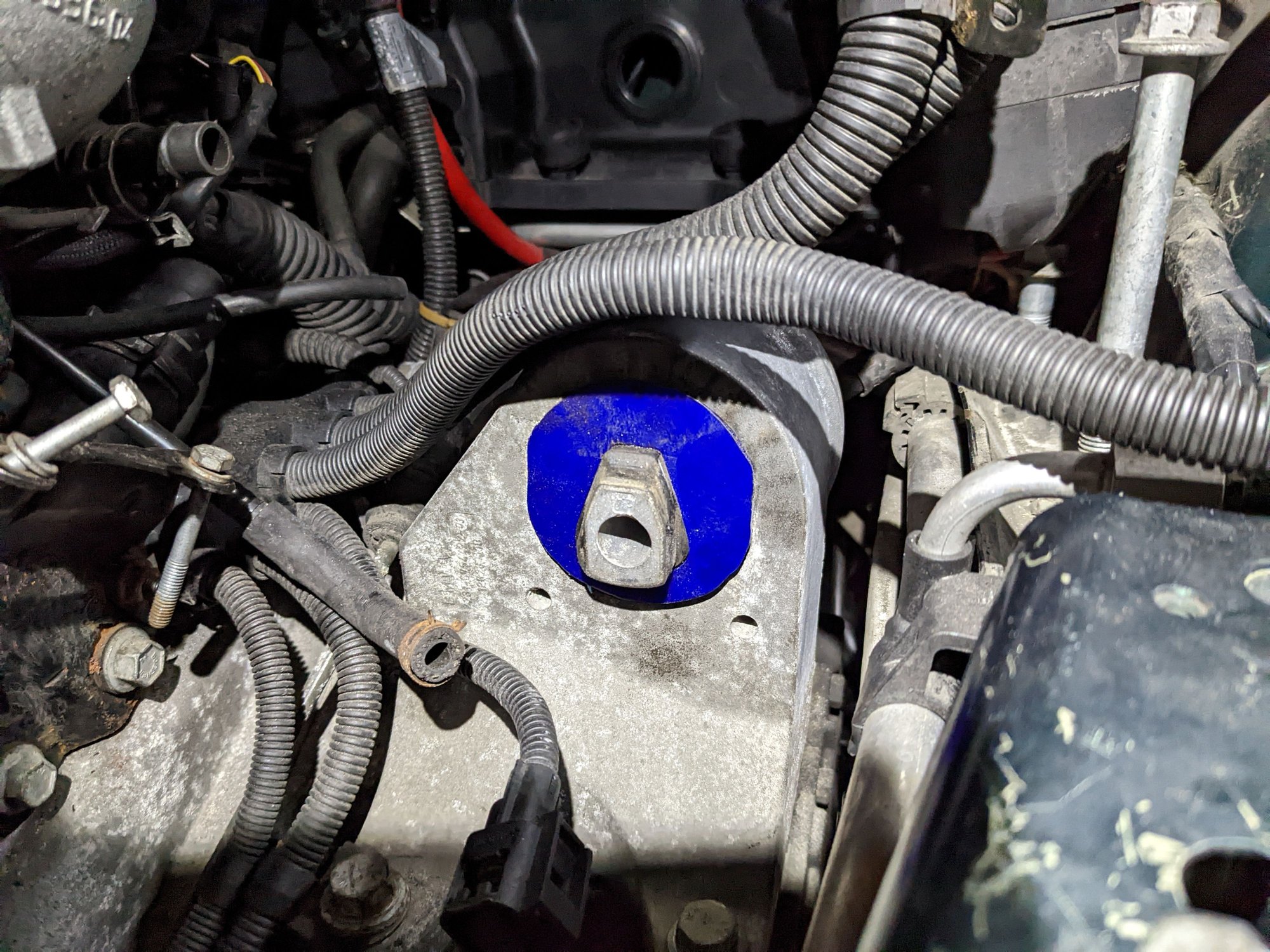

Superpro transmission mount inserts.

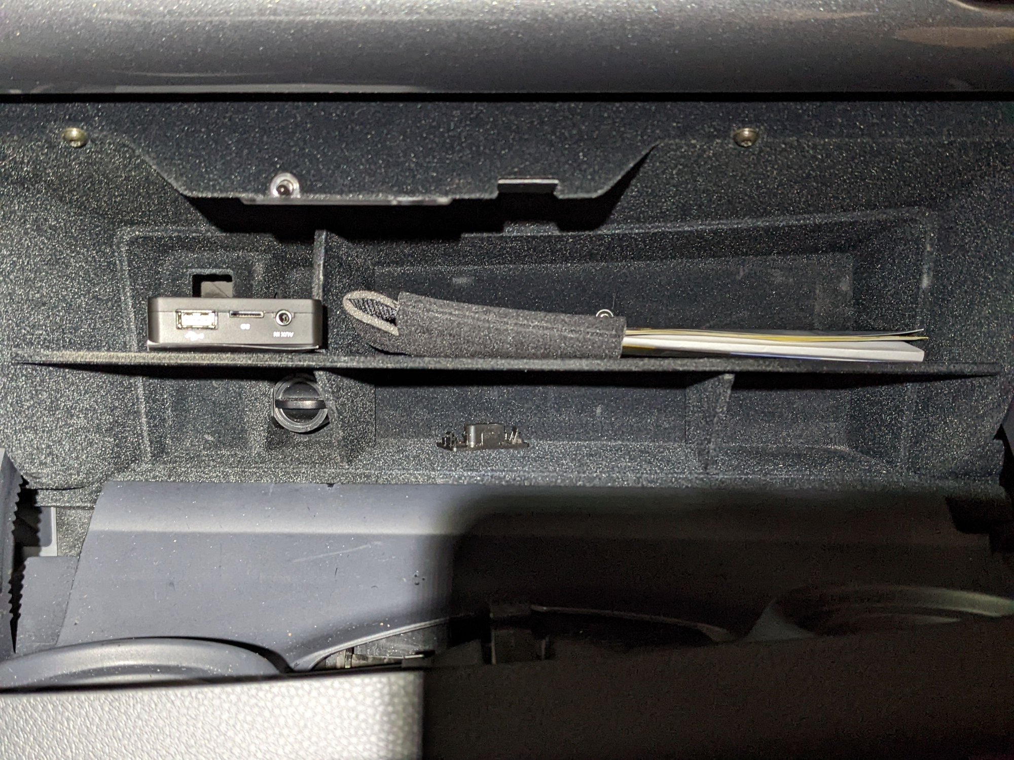

Bluetooth/SD card/Aux module installed!

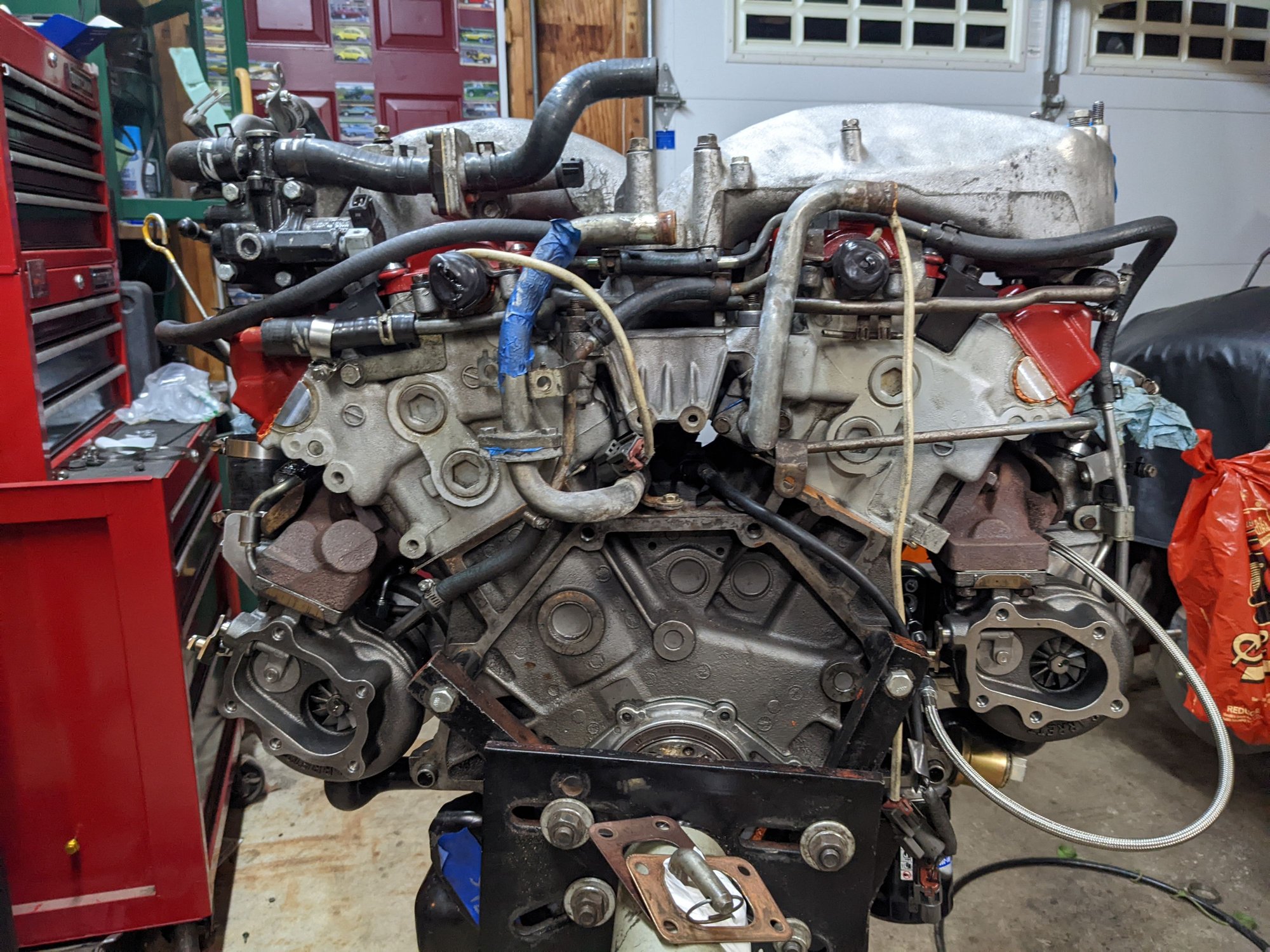

I had to scale back the build just a little. I was looking into cams, tires for my X-lite wheels, and E85 fixins to finish my 'dream build' when I discovered I had blown a turbo (or 2) on my 300ZX. I parked it in the fall knowing I had an issue, but I didn't find time or motivation to look into it until February. I finally got the engine out in May and confirmed my suspicions. I figured it would be a year or two before I got the funds to do a turbo swap, but found a super reasonably priced GT25R kit and somehow got the wife on board with the purchase (despite the fact that we were leaving for a 10 day Ireland trip in less than 2 months). I placed the order on 4/22, and had the car buttoned up and on the road by my birthday on 5/22; while balancing 2 a day workouts, a kid, a full time job, and weekend practices. Not bad!
New turbos installed
Waiting to go back in
Unfortunately what has been an E85 haven is starting to turn around. Kwik Trip has generally been a reliable source for E85 at nearly every station in the area, but they've pulled quite a few of the pumps out this year. Bad news for the Z, good news for the Mini. I won't waste money going the E85 route, and when funds become available I think my next upgrade will be methanol injection. I think its the best sub $1000 bang for the buck upgrade there is. Maybe next year. Until then I'm driving the JCW a ton, getting great gas mileage, and having a blast. Roughly 3k miles so far on commuter duty and no issues to speak of (minus some rattles).

Finally got the brakes some breathing room

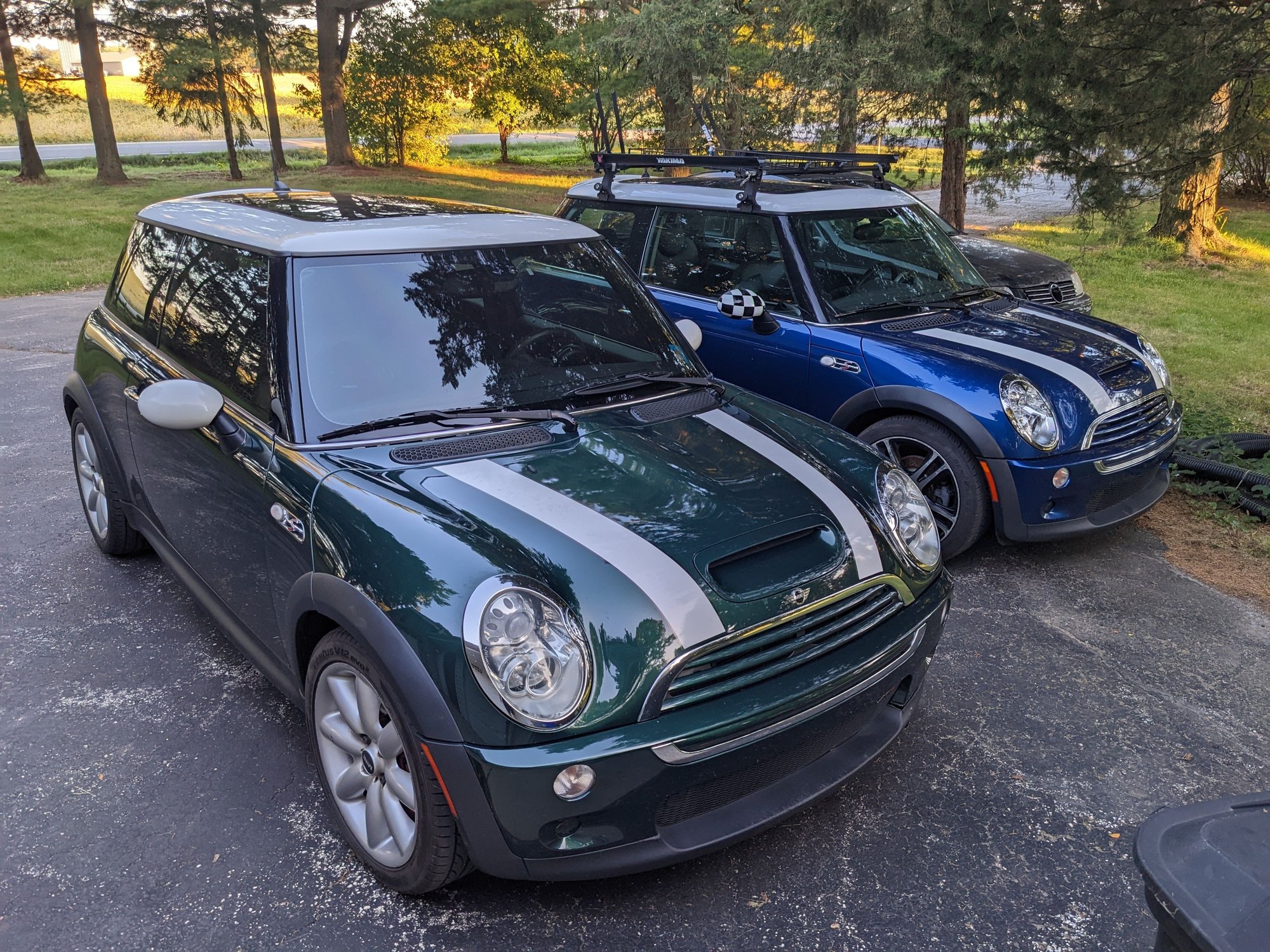

Stepsiblings!
A fellow member and I rescued this 03 JCW from a local owner who was over his head. The car is in great shape cosmetically (following a good vacuum), but needed some serious TLC. It's currently on the lift as we replace and rebuild nearly everything.
