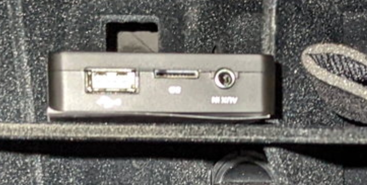

Dang, can't believe I didn't share this earlier.
Sorta cheap ebay unit. Has SD, USB, aux, and bluetooth all built in. It installs just like the OEM aux style piggyback at the back of the headunit. Link to a similar option below, can't find the exact link I purchased from, and you may be able to find cheaper.
"Lapower" R53 bluetooth adapter.

FYI, you may need a usb to printer (usbA?) style cable for bmw scanner 1.4. I do not recall if mine came with just the diagnostic head amd install disc, or with the cable to plug into the diag head as well. I’ve had mine since my e46 so it’s been a decade or more.
Cool!
Looks to be just what I was hoping for.
Radio stations around here suck. I no longer play CDs. I have the AUX adapter installed,connetor to my phone which has 32+ Gigs of FLAC quality music stored on a 64gig SD card.
It would be nice just to swap in my card directly into this unit and never have to plug in my phone again just to listen to my favorite music.
Thanks for that

Originally Posted by Here2Go
Cool!
Thanks for that
Great news. If I remember correctly it also plays .flac files. I keep a USB stick plugged into the unit for when I'm not in the mood to stream from my phone. I need to verify this as I've been messing with two headunits lately.
Thanks to @Onizukachan , I picked up yet another cable and BMW Scanner 1.4 (cannot be used with INPA cable). It provides a little more detail than INPA in some areas, and makes reprogramming modules much easier to get started with than NCS expert. Unfortunately, it still hasn't helped solve my mystery airbag light issue. Lots of research has yielded no results on the 55(hex) 085(dec) DTC. Emergency call function seems to be an accident trigger system in BMW lingo. This car does have the OEM BMW alarm but I haven't seen this code referenced a single time on the internet and I don't believe mini ever had an on-star like emergency call ability. Maybe its somehow incorporated into the call/mute button system on the steering wheel?
