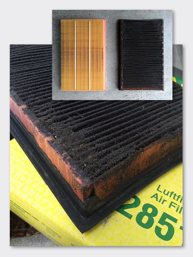

Originally Posted by megaDan
I realized on my first fillup that I never even opened the airbox to check the condition of the air filter.
I'm sure that's not helping either.
You might want to do that...
This is what mine looked like (compared to a new filter) when I first acquired my MINI. It was the very first thing I checked. I have no idea how air was able to get past this mess... You can see that it's marked "U.K." on the lower corner of the old filter. It was probably original to the car...

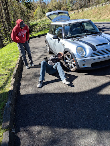

I pulled over as quickly as possible and surveyed the damage. 1 plug missing, 1 boot destroyed, and I was 40 miles from where we were staying. We eventually found the missing plug sitting in the drivers side engine mount. The plug was in surprisingly decent shape, but the gap had been closed from the impact. When the plug blew out, it took the end of the boot with it, and bent the internal connector into an "L" shape. At this point I figured I'd be pulling an injector harness and driving home on 3. We rebuilt the boot as best we could, applied some electrical tape, and reshaped the spark plug contact point. I pulled the boot from cylinder 1 to make sure we had done an adequate job....and the wire seperated from the boot. Now I had TWO bad cylinders. I couldn't do anythign aside from shove the wire back into the boot and put the boot back on the plug and hope it would work. I cleaned the aluminum from the threads of the blown out plug and regapped the plug with a screwdriver. As best I could tell threads still existed in the head so I gave it a try and reinstalled it. It went back in (with mild resistance) but it accepted proper torque. I fired it up and it ran on 4! I was terrified of another blowout the whole way back so I took it verryyyyyy easy. Thankfully there was an Advanced Auto Parts in town when we made it back; I ordered two plugs and a set of spark plug wires that would be in the next day. I surveyed my options regarding spark plug thread repair and was encouraged that they had the tools needed (if I ran into issues just replacing the plug).
After breakfast at the Switzerland Cafe I headed to the auto parts store to pick up my tools and parts. I was dismayed to realize that the spark plug thread inserts were aluminum, and the tap looked kinda iffy; but I didn't think I had another option in rural NC. Upon getting back to the house I removed all the spark plug wires and removed the bad plug. Unfortunately the plug took all of the threads with it; so I was in for a nervous thread repair session. I attempted to use the Advance Auto tool, but it was complete junk. All it did was remove what little bit of thread was left in the head while spinning in place. At this point I was getting pretty worried and frustrated. I asked my wife to look into flights and Uhaul options. This was Monday at 4pm and we were set to drive 770 miles home the next morning at 8AM. I started calling every shop in town; but either no-one could help me or none could help me this week. Despite the warning of the slow pace of life in the south; it still caught me by surprise as to just how slow it actually is. Despite expalaining my predicament to each tech on the phone; I never got the hint that anyone could/would provide assistance. Crap. While searching for repair places, I saw a NAPA on the other side of town. This was pretty much my last option so we hopped in the car and got there as quick as possbile. They had the exact same tool in the exact same packaging as Advance Auto, except it was immediately apparent that this wasn't chinese garbage. This tool looked sharp and purpose made; and the inserts were steel! With a tiny bit of confidence I brought the tool home and got to work. Using chainsaw bar lube as my chip catching medium; I had new threads CAREFULLY cut in 30 minutes. I used Loctite Red on the insert and held my breath as I put it over the spark plug and inserted it into the head. I knew I only had one chance at this.....
8 or so turns later it was installed! We all went inside for a beer and waited for the loctite to set-up before the first test fire. The beer was delicious and the car fired right up on all 4. We took it for a test drive on the Parkway and stopped to take in the sights at a few overlooks. I also checked the spark plug torque at each stop; thankfully nothing budged. Success!
